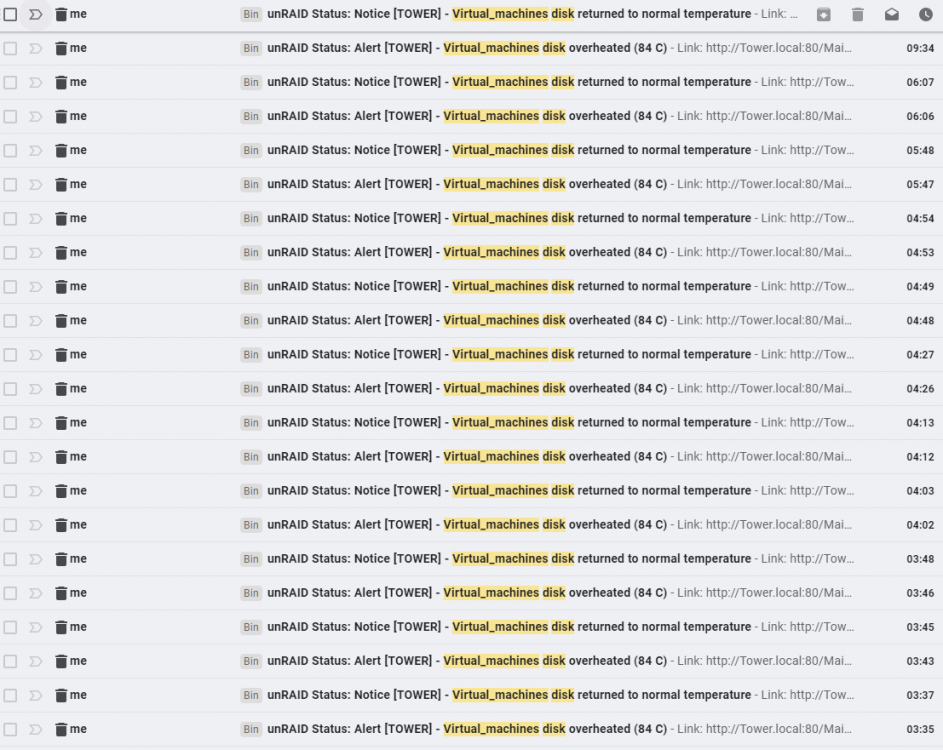

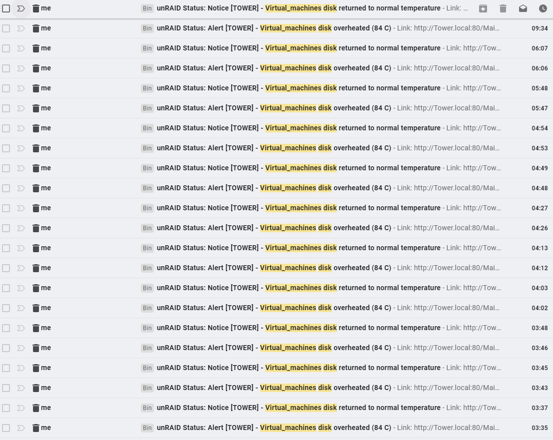

I upgraded from 6.9.2 to 6.10.0 and everything works except...
I have 2 identical NVME drives and one of them gives temperature overheat warnings. Sometimes it is every few minutes and sometimes it is every few hours (not consistant).
The usual temperatue is about 35-40C and the warning gives a temperature of 84C (always) for a one minutes and then back to normal - I guess it is the polling frequency.
This happens when working with the server and also in complete idle (during the night).
This did not happen in 6.9.2 and started immedaitely after the upgrade to 6.10.0.
It's an issue with the Samsung 980:

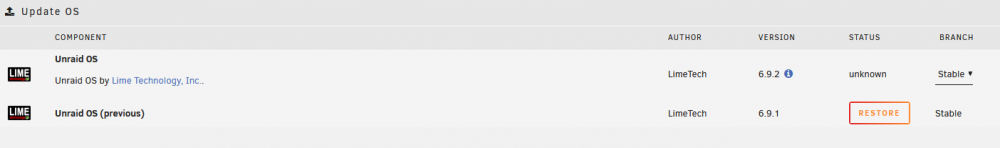

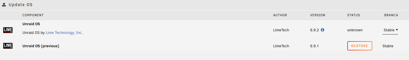

Version 6.10.1 2022-05-21
Management:
startup: fix regression: support USB flash boot from other than partition 1

If I understand correctly, it is just a fix for people with USB boot drives with multiple partitions:
Edited by UNOPARATOR

...changelog is linked on the download page.
All there is inside is this:
## Version 6.10.1 2022-05-21
### Management:
- startup: fix regression: support USB flash boot from other than partition 1
...still not excited and not keen on upgrading from previous 6.9.2...way too many users with problems, as it seems.
