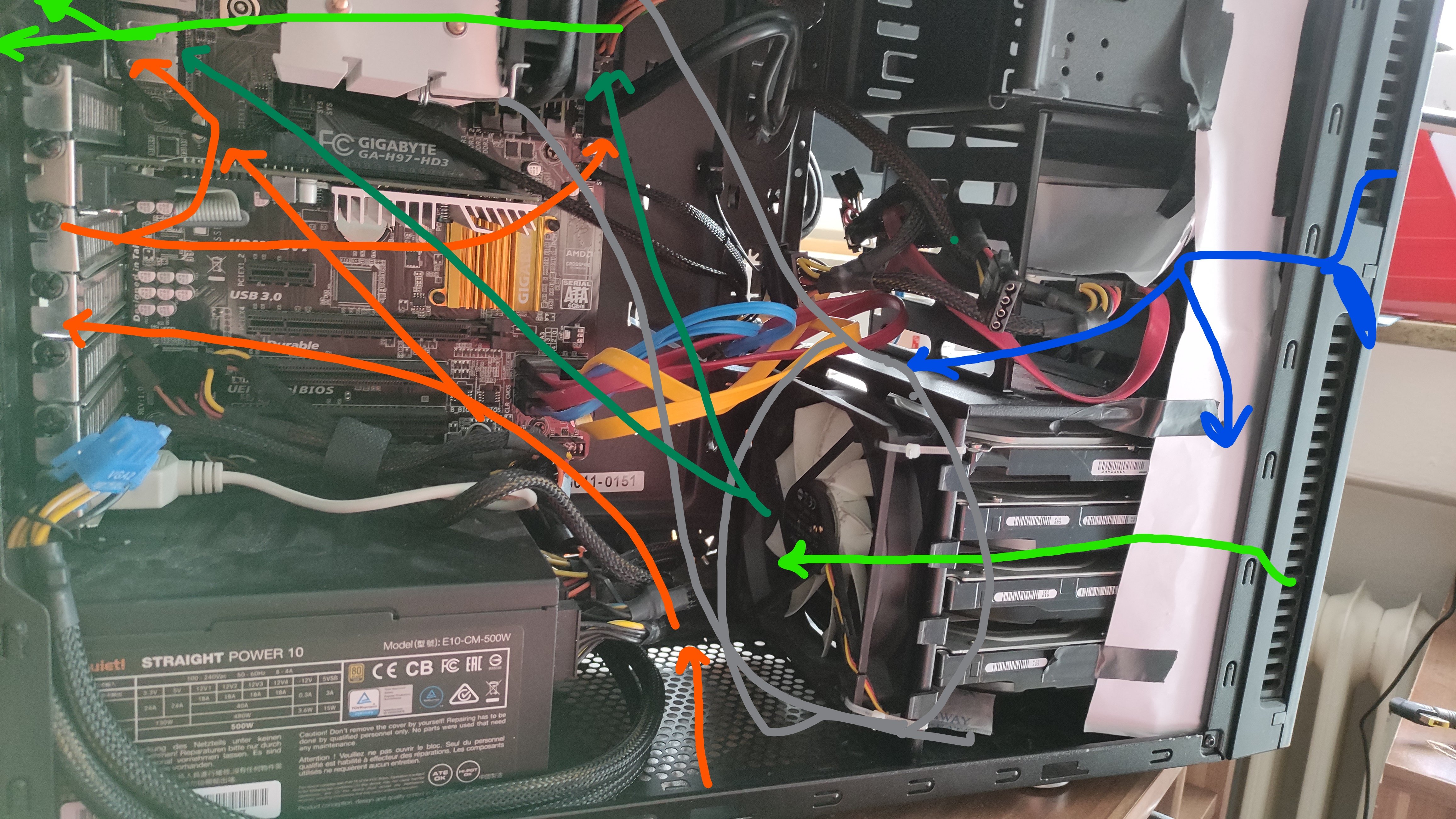

All those openings not sealed are allowing air to go where it's not needed. Tape over all the random holes in the bottom, back, slot covers, etc, then put the side back on and see how it goes.
I've literally never seen anything like that (okay maybe except on servers) Are you really saying the air might flow in from the pcie slots, or from the bottom and go out on through the rear fan, so the air pushed into the front wont make it out?  (orange: bad, unwanted, unexpected airflow)
Because other than the bottom there's really no big holes anywhere that would make sense in terms of unwanted airflow.
I could try to build a "funnel" from the pull fan after the disks up to the cpu fan. (grey) but I dont really think that would work properly (and I'm not sure how to build it...
Green is the wanted airflow, where dark green is flow that might not be there right now.
Blue is the top fan, I really dont see a way to redirect it to the bottom, so the only thing I could do is lower that top front one even more. (to make sure green reaches the cpu/rear fan, and not blue)
Yep. I'm really saying that. Air moves from high pressure to low pressure. period. end of statement.
If you are doing a really good job of evacuating air from the exhaust fans, and the intake fans have restrictions and obstructions (the drives) the extra air being pushed out the back will come in from all the extra openings instead of helping out the intake fans.
To do a really thorough job, you really need a clear cover to temporarily seal the side but allow visibility, and a smoke pen or some other source of non-noxious or settling vapour, and observe airflow in realtime.

I'll test with this setup (and some slight changes) for now, and when I open the case next time, I'll tape the bottom and pcie closed (shouldnt be too complicated).
And then I have a manual fan control  card coming (but its got some longer delivery time), with that I can probably fine tune things to a nice 80% rpm level which isnt as loud.
What I'm questioning is why I would have lower pressure at the end of my push-disks-pull tunnel than on the openings with "atmosphere" pressure.
Even if my fans did almost nothing, they'd still create higher pressure - the same as the rear fan would create lower pressure.
and the air coming in from the bottom, would at least "sweep" along some of the air from the disk bundle (if that works only a bit), so its not too detrimental
the only one "bad" would be  "in through pcie" - which really needs a lot of pressure difference, to force the air around that bend instead
I cannot monitor the airflow with smoke, but I can still test whether there's relevant airflow through openings... with light tissue... and I can be a bit sure that there's no air going into the back.
But either way,  I can keep the disks cool enough, I only have to dial in to do it with a bit less rpm so it's not too audible. ( I regret not having ordered pwm fans...)

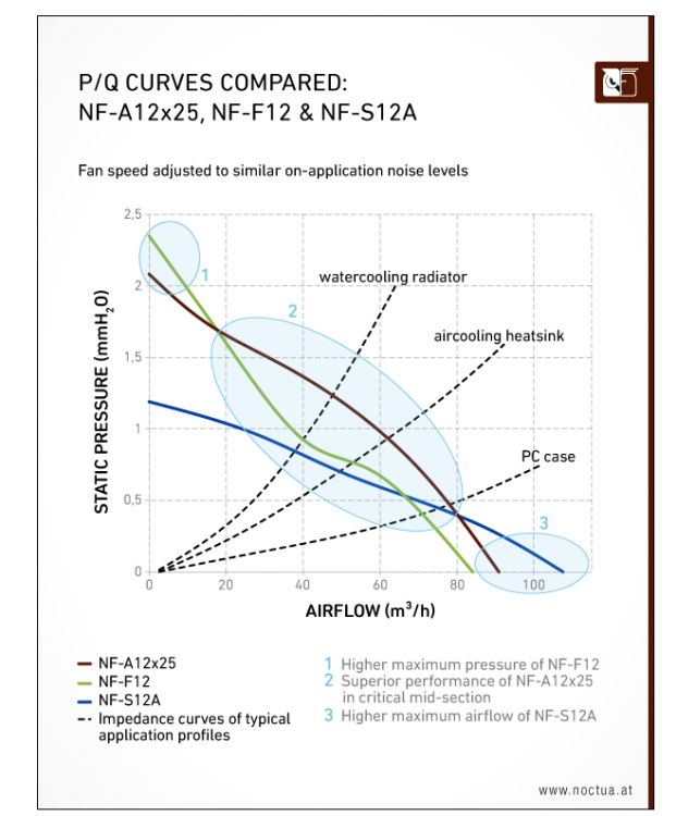

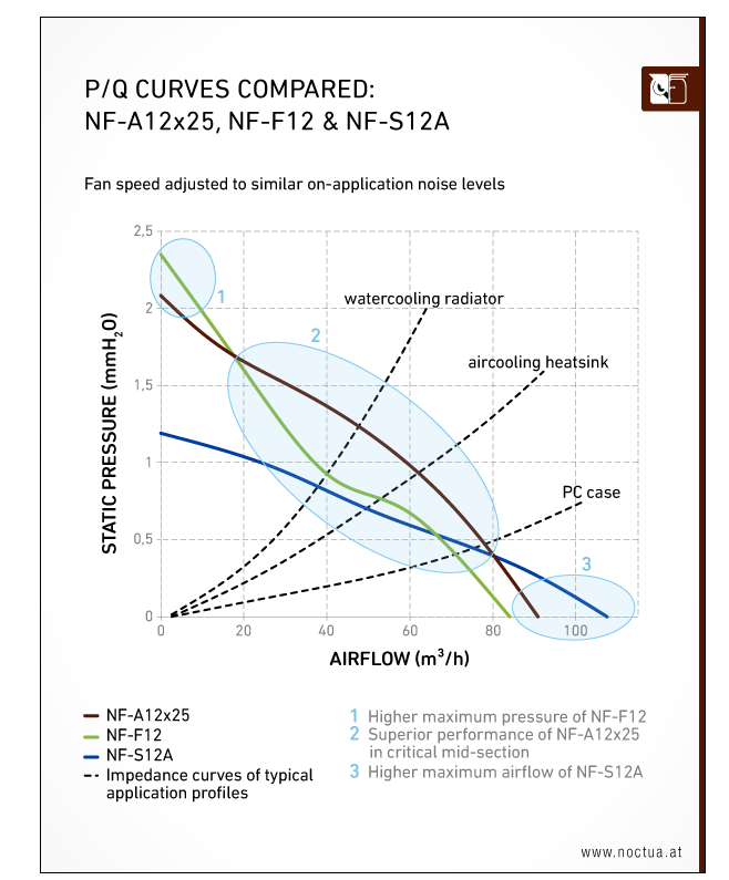

@JonathanM, Basically, we are saying the same thing but looking it different ways.  For those who are just starting out trying to figure how to set things up to maximize cooling while minimizing noise, a graph may help.  I swiped this one from the Noctua website:
Noise levels for each fan model are as follows:
NF-A12x25    22.6 dB/A
NF-12        22.4 dB/A
NF-S12A      17.8 dB/A
The dashed lines (labeled PC case, aircooling heatsink and watercooling heatsink) show the typical static pressure vs airflow through/across the device.   (I am surmising that PC case line is for a virtually empty case...)
To give you a feel of how much a mm of H2O static pressure is, the atmospheric pressure at sea level using water is 10.3M (meter).   Now further understand that well-designed noisier fans have much better pressure differential performance and will deliver much higher volumes of at any specific static pressure.   With these fans, you don't have to be as careful with the cooling setup because these noisy fans static pressure and airflow capability will usually overcome a marginal airflow design.
