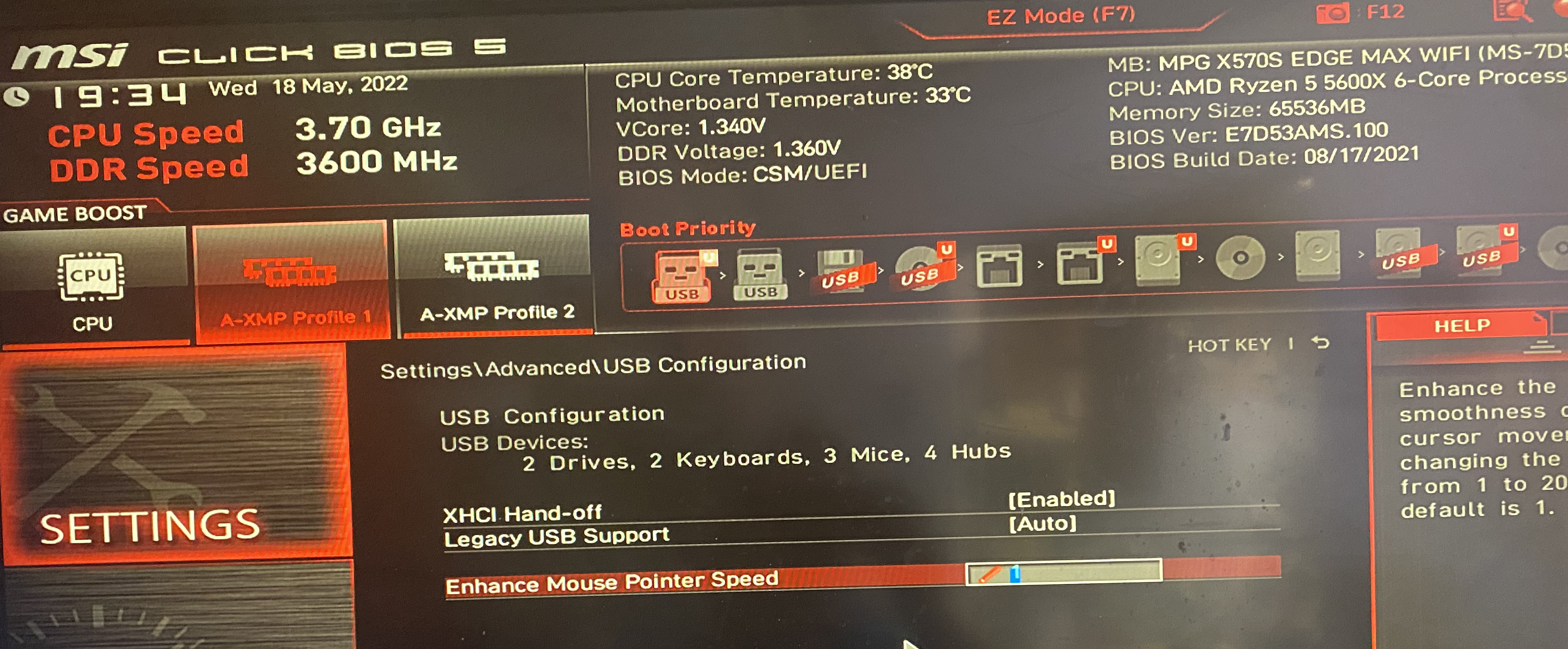

The Unraid MSI motherboard BIOS recognizes the game controller correctly. When plugged into a USB port the BIOS adds 1 Keyboard, 2 mouse, and 1 hub devices. This is in addition to the standard keyboard and mouse that is used for normal input.
