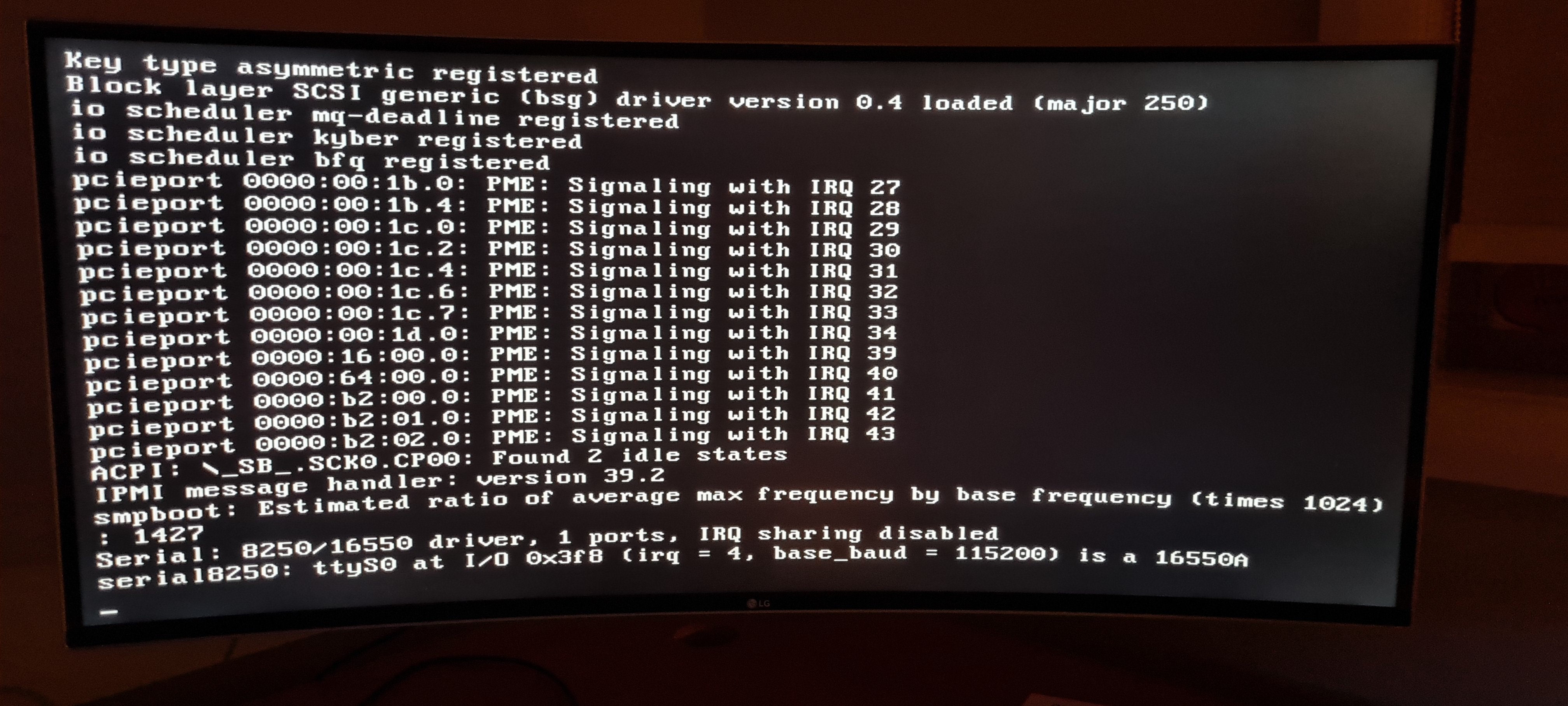

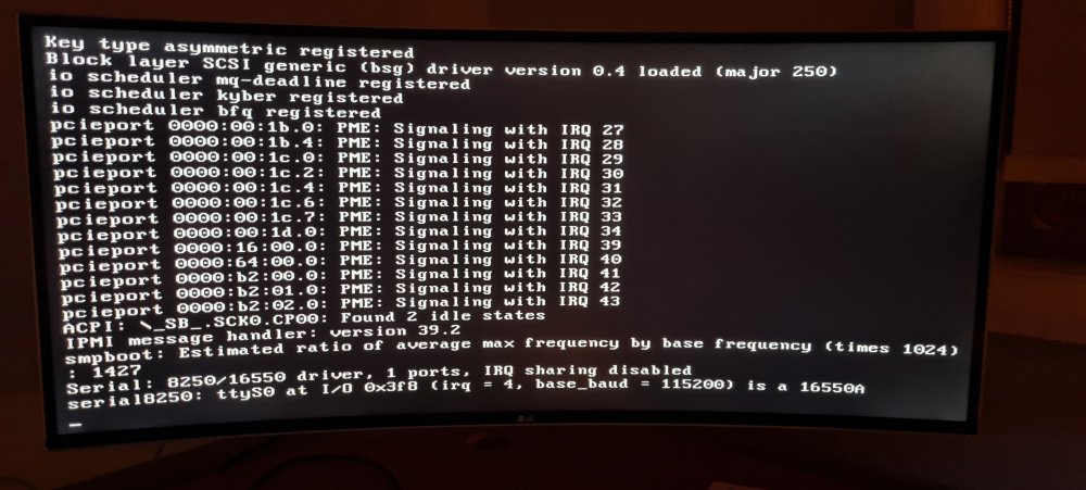

Selected OS Update in the gui, download OK and got a message saying a reboot is required. Rebooted and... nothing. No command line or Web gui.
Does the first boot take a while?.
Can I roll back to the previous version by unzipping unraid by plugging it into my laptop?
Peter
Do you have a monitor/ipmi? Where did the boot stopped?

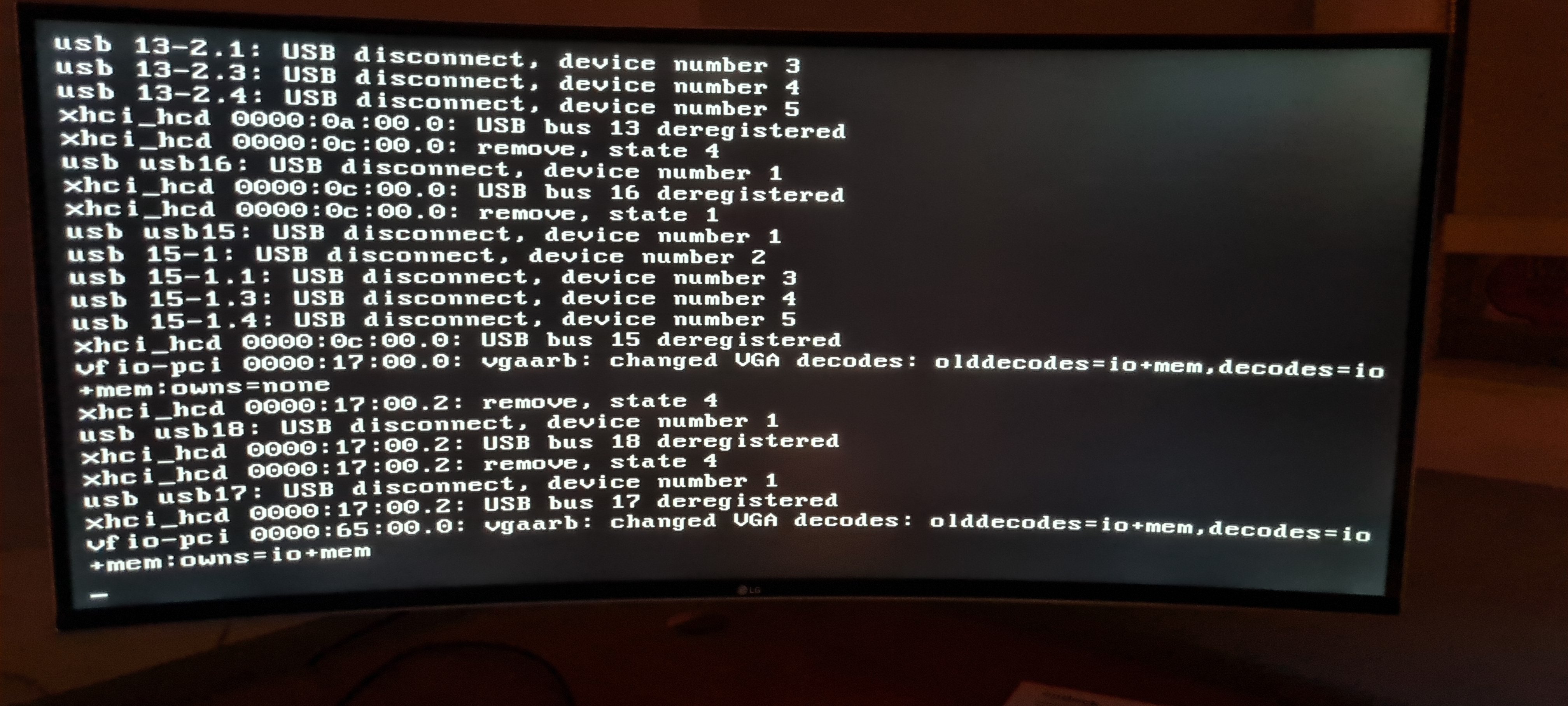

It appears that there are lots os USB related issues, make sure the flash is in a USB 2.0 port and/or try a different one (in a different controller).
Still the same. Can I put the unraid usb in my laptop, delete the 6.10 unraid and unzip the previous version?. Then get a log file and work out what the usb problem is?
