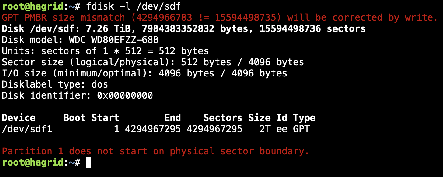

Thanks for the response; output attached.

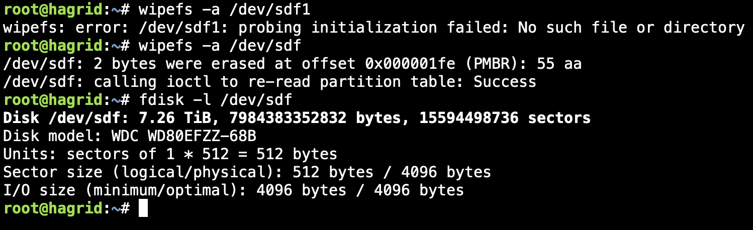

type
wipefs -a /dev/sdf1
then
wipefs -a /dev/sdf
and repost fdisk output

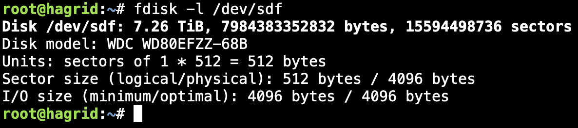

Now try formatting again with Unraid and post new fdisk output if it fails.

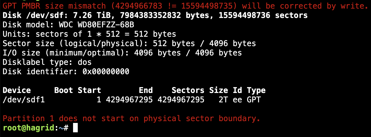

Well, not much progress.

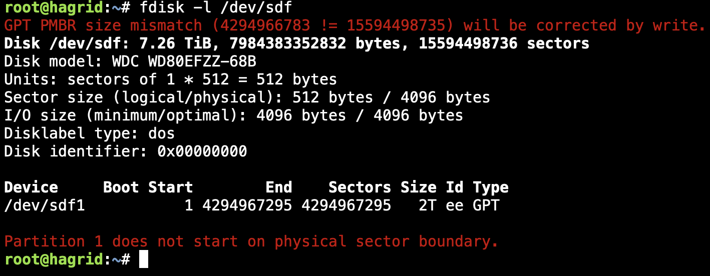

Rebooted, here's the output before I start the array. Will post follow-up about how it goes from here.
Edit - nope, no love here1859005732_CleanShot2022-05-19at07_53.02@2x.thumb.png.f6162c2d7c006c9d0b26305090234b41.png

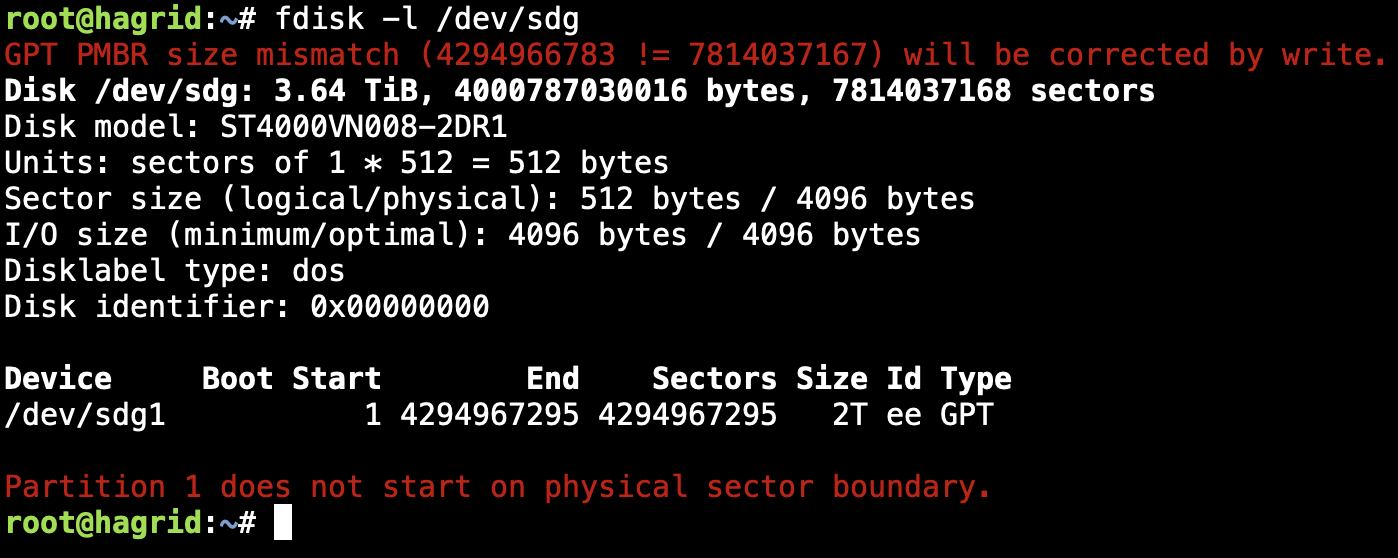

Here's a different drive, this one 4gb. Attempted to format in UD, and here's the output from fdisk
So clearly not a disk problem but no idea what's going on.
