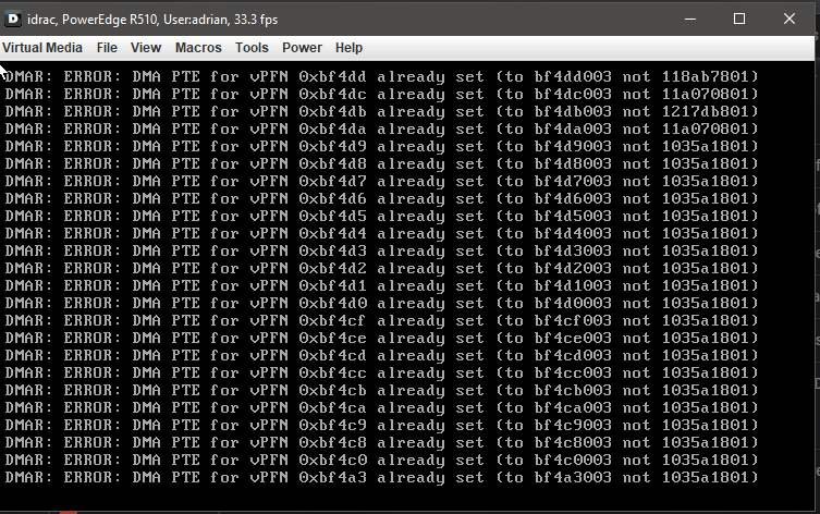

V6.10 update > DMAR: ERROR: DMA PTE for vPFN 0xf2827 already set........
New V6.10 update and now I see a series of DMAR errors popping up in the monitor
I did a search and came across people suggesting doing a parity check. I just started one so we'll see what comes from that. I'll post diags if I keep seeing this pop up or if by request.

You must disable vt-d, v6.10.2 looks for that, there are stability issues, even some possible filesystem corruption if vt-d is enable with those servers, problem is believed to be caused by the NIC driver when vt-d is enable.

If you're seeing the above error you should disable vt-d, and it's a no brainer if you're not even using it.
Disabling vt-d got rid of the errors for me.
