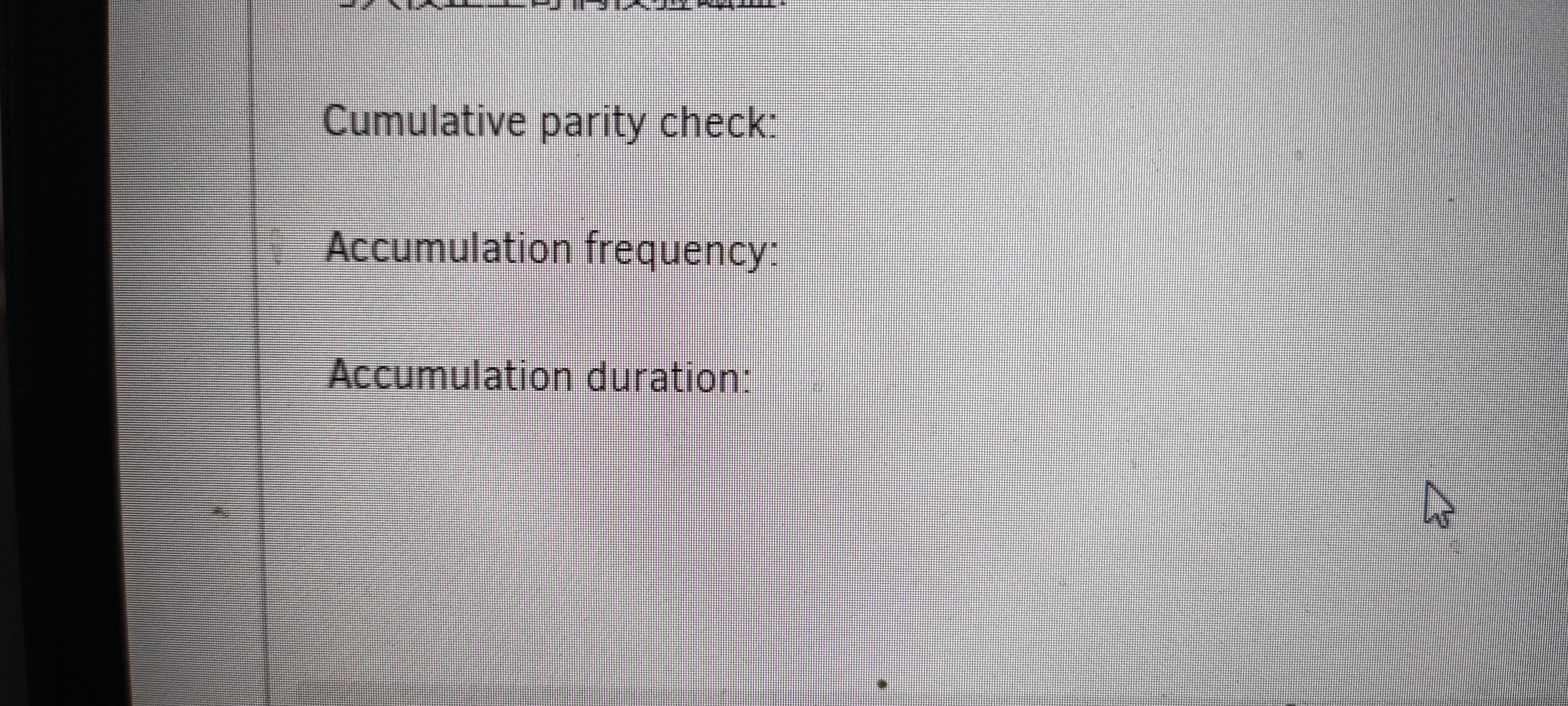

i also noticed three options in setting//schedule.They are cumulative parity check,accumulation frequency and accumulation duration.It looks like a simplified version of your project.does this conflict with the plugin?
You can ignore those settings if the plugin is installed (I.e. setting them is irrelevant).   The plugin pre-dates those being available and it already makes sure that correct values are stored in the parity check history.
