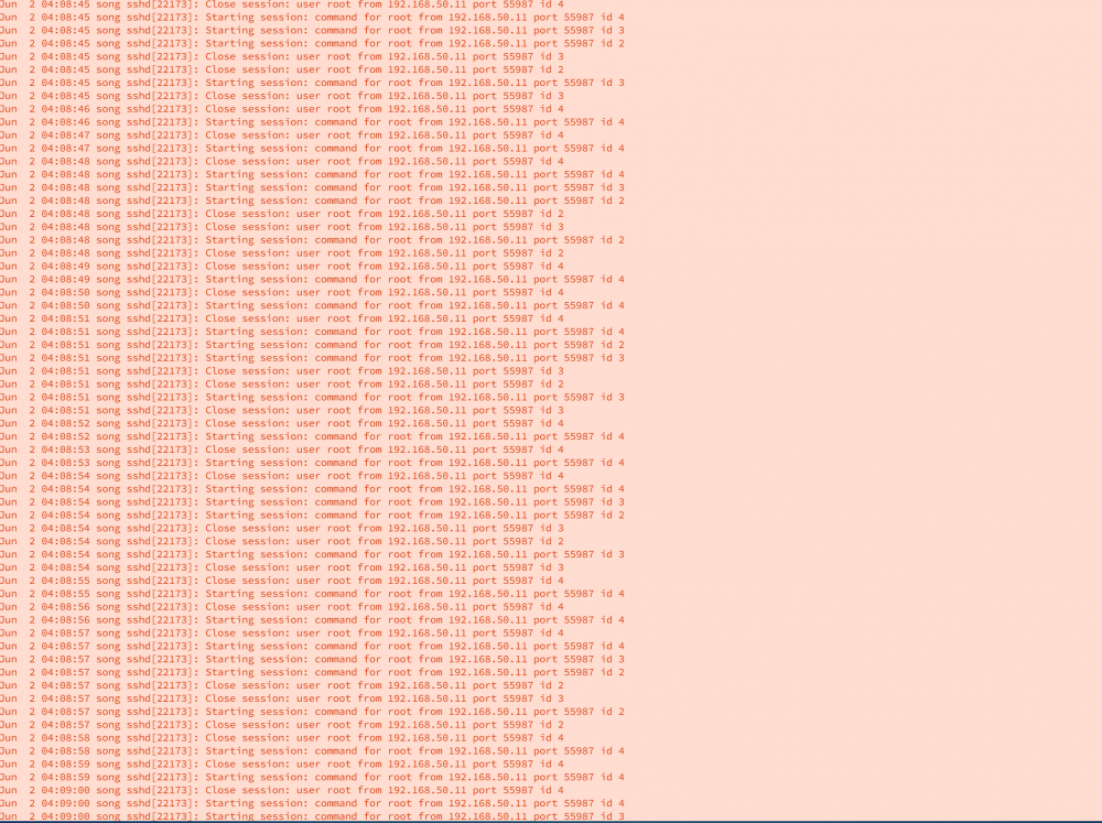

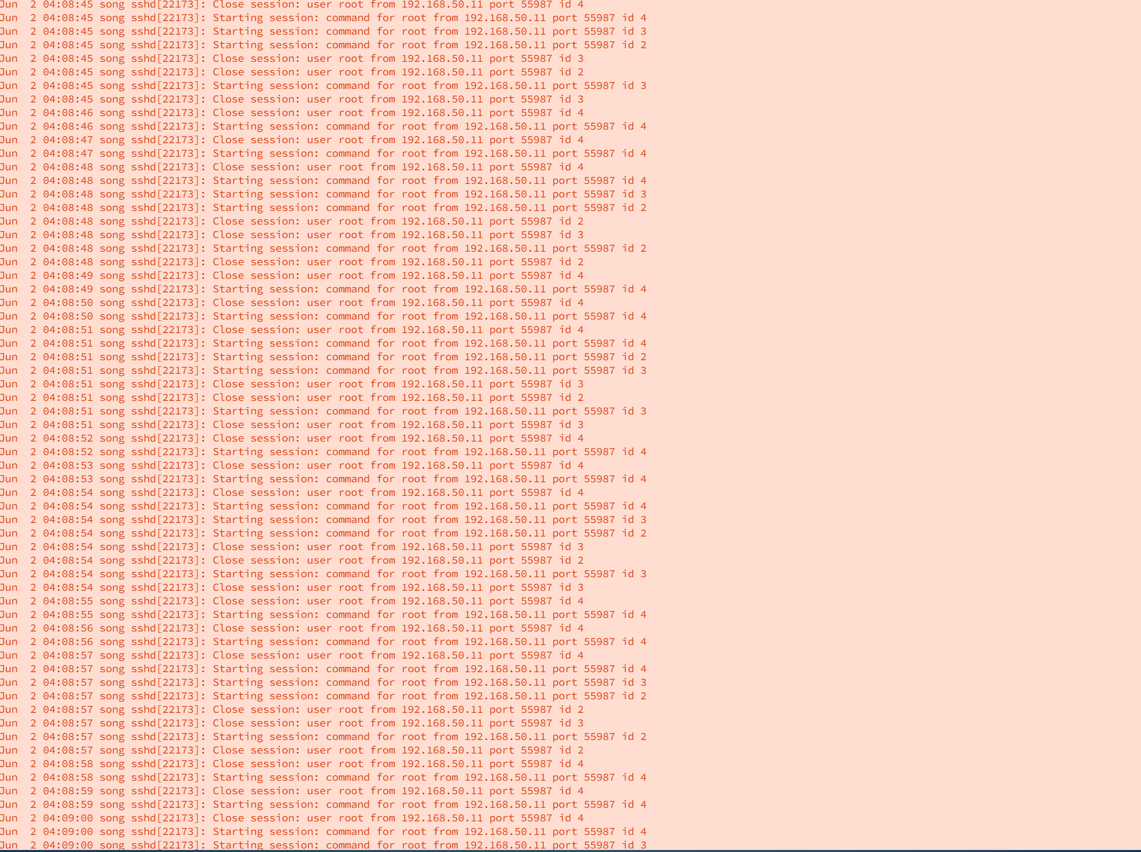

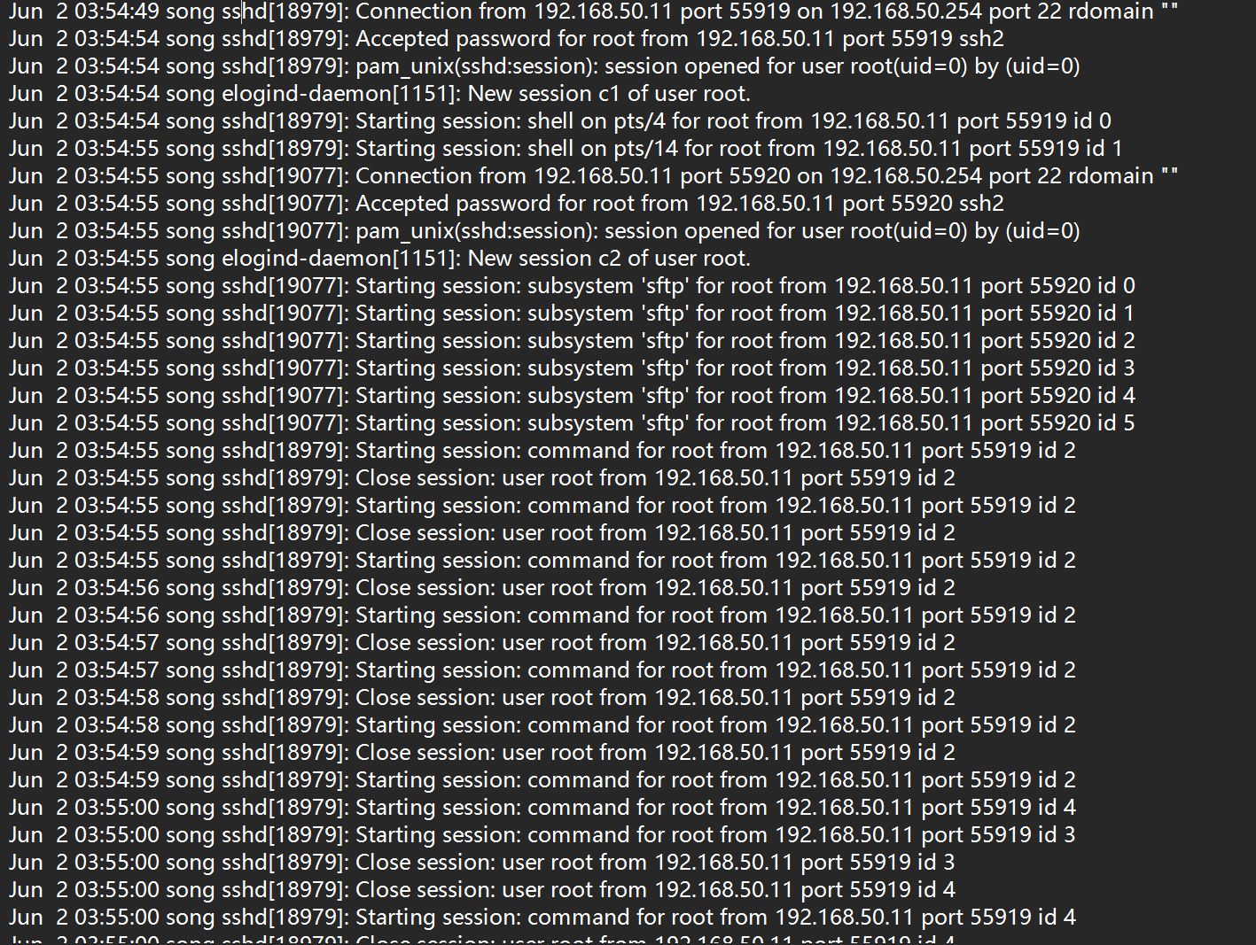

Today, I opened the system log and found thousands of wrong messages. I don't understand what this means. Could you tell me the reason for this?20220604140202.thumb.png.57a76b44f5bb23e400dfaefe47cb73d7.png
I have uploaded my unRAID log information compression package, and I found that the error started at 3:55 am and continued until 4:09 am. "192.168.50.11" is my PC host, and I have turned off the power of the PC host at 1:15 am. Why does it have such error information at 3:55 am? This error message is reported on average 5-6 times per second
Edited by song
Those are not errors, it's just the ssh log, 192.168.50.11 is connecting and disconnecting to your server using ssh.
But my PC host "192.168.50.11" was powered down at 1:15, why did this message appear at 3:55?
That doesn't make much sense, either the time is wrong or there was another device using that IP.

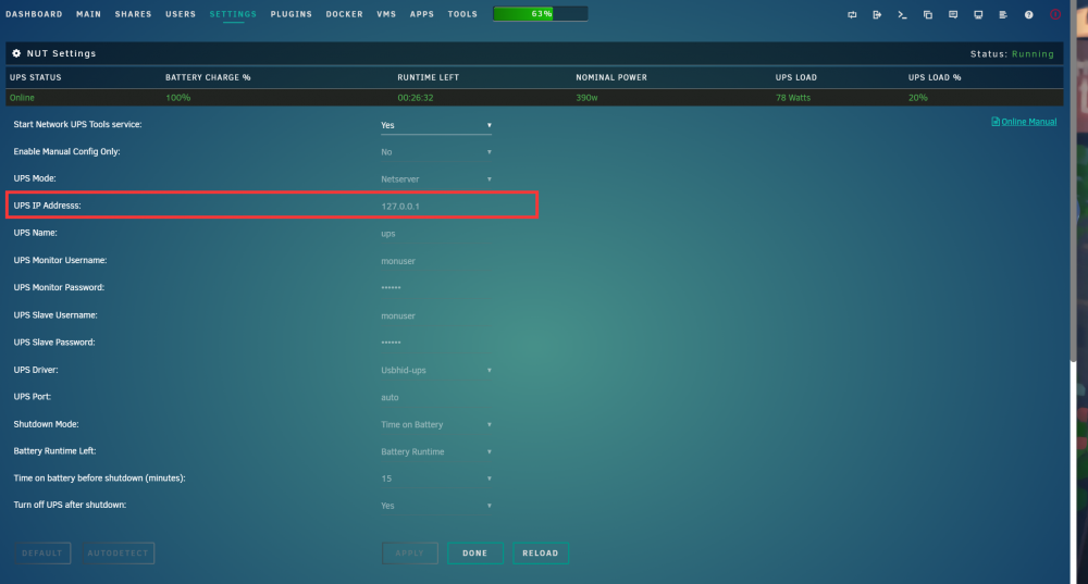

Ok, thank you. When I checked the logs recently, I found some warning information related to UPS. For the UPS power supply of BK650 model connected by UNRAID, I used the plug-in "Network UPS Tools" as the UPS server mode. The IP address displayed in the log information of the warning is my iPhone. Why is my iPhone associated with the UPS of UNRAID?
The IP address of unRAID is 192.168.50.254. The IP address of iPhone is 192.168.50.12.
The following is the unRAID log information
"Jun 8 00:19:33 song nginx: 2022/06/08 00:19:33 [error] 4701#4701: *1779916 recv() failed (104: Connection reset by peer) while reading upstream, client: 192.168.50.12, server: , request: "GET //wsproxy/5701/ HTTP/1.1", upstream: "http://127.0.0.1:5701/", host: "192.168.50.254"
Edited by song
13 minutes ago, song said:
related to UPS
Do you mean this word?
upstream
Not at all related to UPS.
