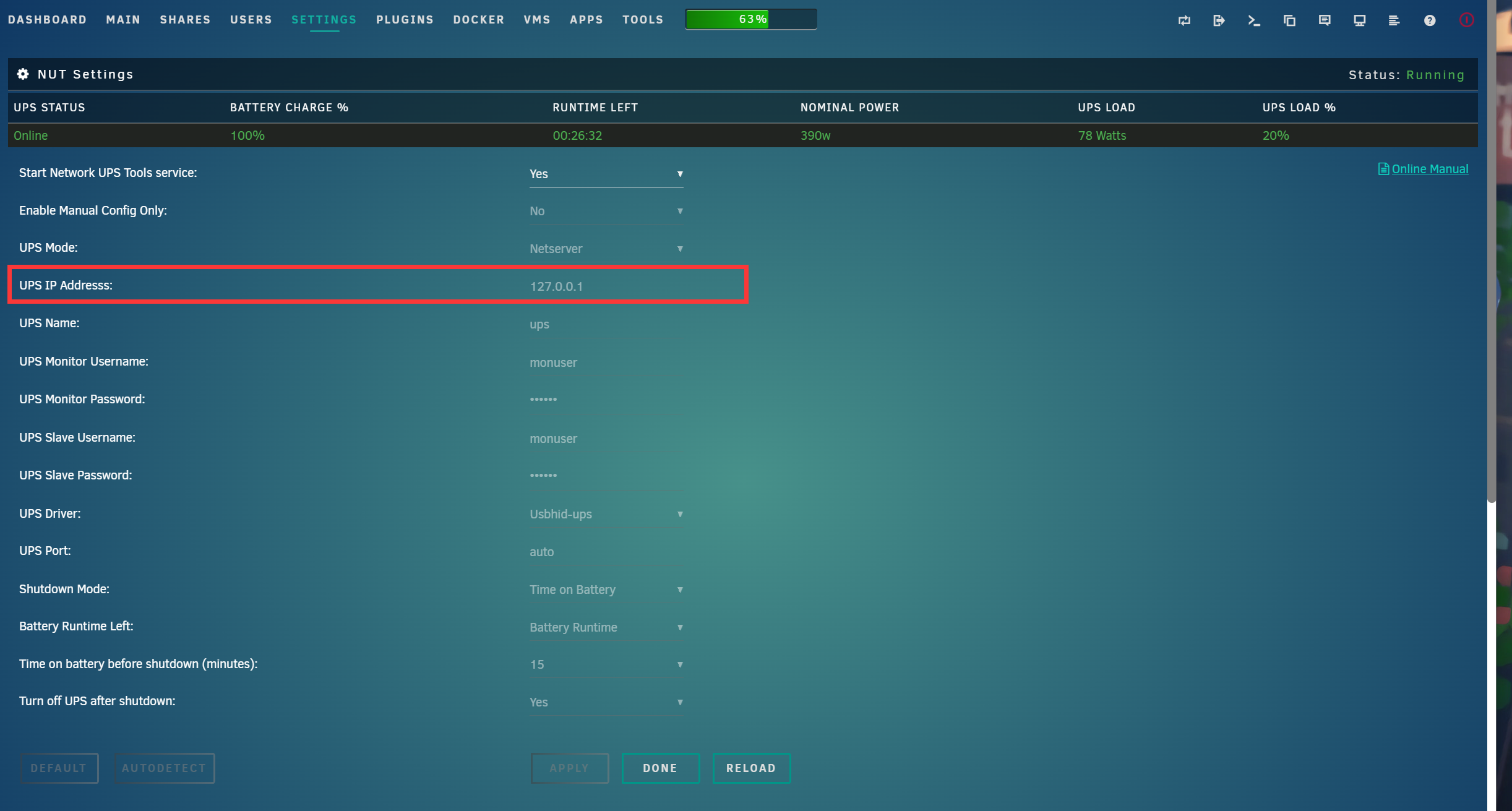

12 minutes ago, trurl said:
Do you mean this word?
Not at all related to UPS.
This log information indicates my UPS, may I ask what is the cause
Which log information?
Jun 8 00:19:33 song nginx: 2022/06/08 00:19:33 [error] 4701#4701: *1779916 recv() failed (104: Connection reset by peer) while reading upstream, client: 192.168.50.12, server: , request: "GET //wsproxy/5701/ HTTP/1.1", upstream: "http://127.0.0.1:5701/", host: "192.168.50.254"
Edited by song
Why do you think that has anything to do with your UPS?
Because the log message mentioned my UPS IP "127.0.0.1"
7 minutes ago, trurl said:
Everything has IP 127.0.0.1
https://en.wikipedia.org/wiki/Localhost
So what does this log message remind you of? Why does it mention my iPhone's IP address?
Because your iPhone is trying to access the Unraid webUI?

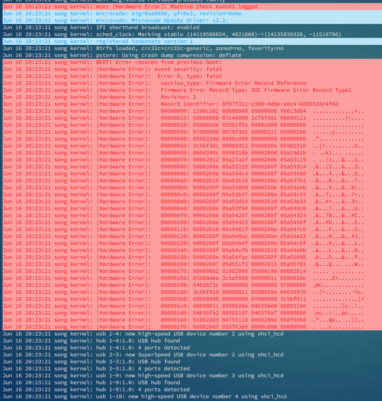

What do these error messages mean? This error message appears every time the system is restarted
It's a hardware error, but cannot tell from where based on that.
This error has not occurred before. It just appeared today. I sent you the system log file. Can you tell what hardware went wrong? The information level of my log is "fatal"
Edited by song
Diagnostics is better than syslog since it already includes syslog since boot along with a lot of other information about your hardware and configuration.
Are these log entries associated with any actual problem you are having?
OK, I have uploaded the diagnostic information file. I haven't changed the hardware configuration. Because my graphics card gtx650ti installed the windows graphics card driver in version 6.10 will prompt error 43, so today I restored to the system backup of version 6.92. I found that windows can normally install and use the graphics card driver in version 6.92. After testing and comparison, I just restored to the backup of version 6.10, These error messages appear only after viewing the logsong-diagnostics-20220616-2104.zip
From what I could find it's apparently related to the Intel microcode, if that's the case it should go away with a future release that includes an updated microcode.
My CPU model is "i5-10500 es version". These error messages did not appear when I upgraded to 6.10.3. Today, in order to test whether my gtx650ti can work normally in version 6.92, I rollback to version 6.92. I am happy to tell you that in version 6.92, my graphics card can be normally used in Windows and the driver of my graphics card can be installed normally without 43 errors. After verification, I restored the system backup of 6.10.3. I regret to tell you that in version 6.10, the graphics card still does not work, and 43 errors are prompted when installing the graphics card driver, so I checked the log and found the log information of these errors, which I have never seen before
