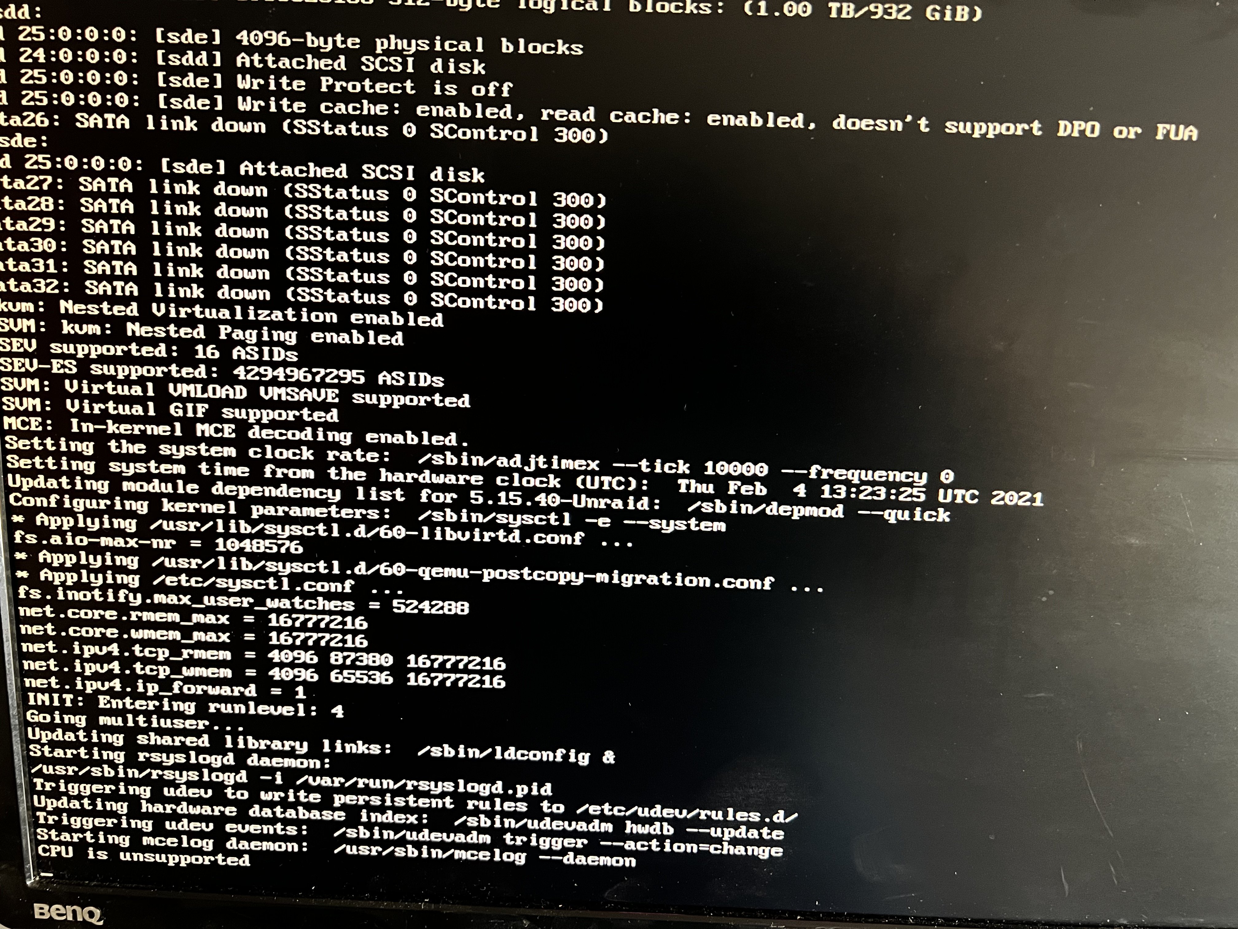

A photo of the screen when it stops might also give some clues.
Here you go

I think the CPU is unsupported is for the mcelog daemon, does the boot process not continue past that point?

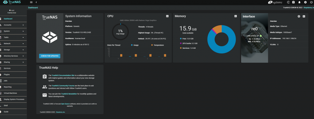

Ok, I Just fully installed TrueNAS and working 100%. I'm out of ideas and my wife what's the thing of the dining room table
