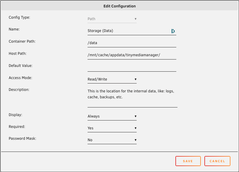

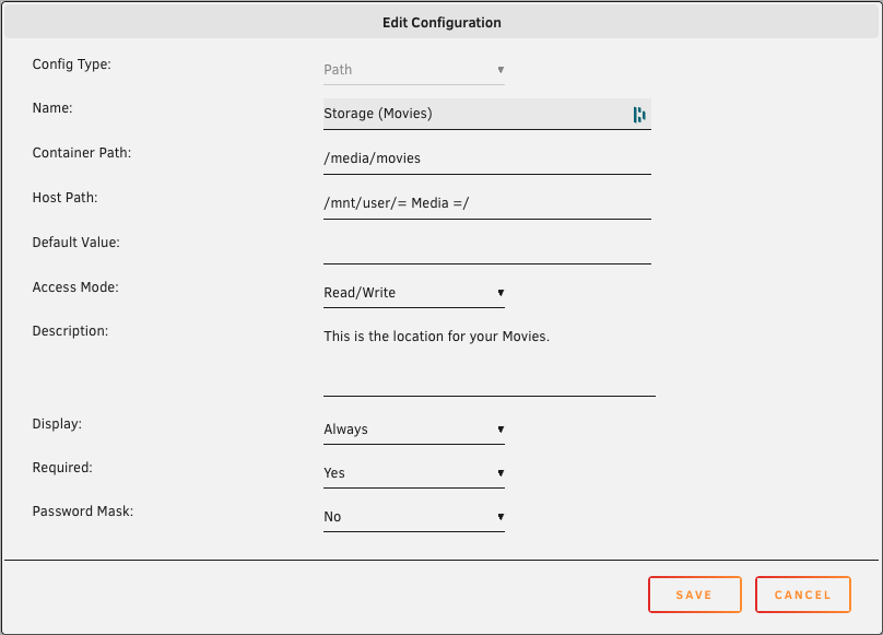

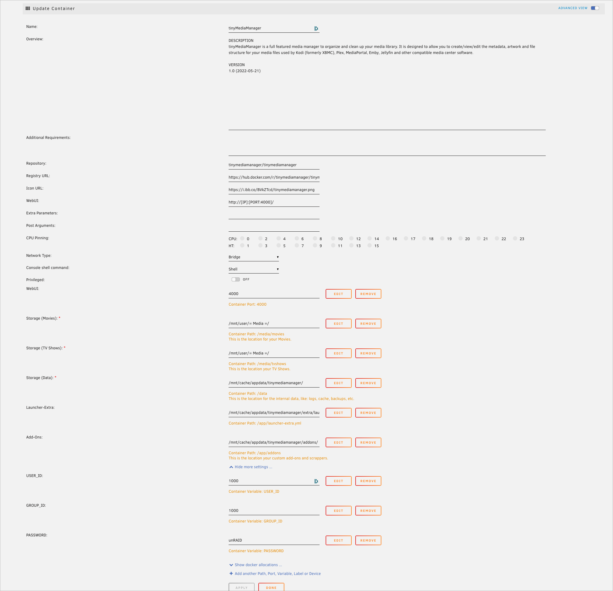

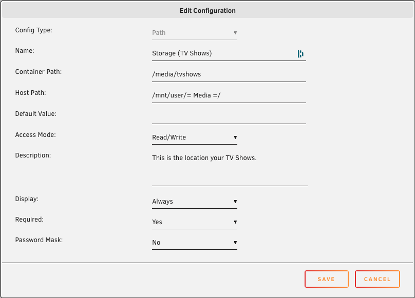

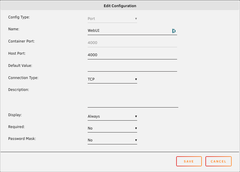

Docker Template to use the Official TinyMediaManager Docker Image from DockerHub
1762839825_CleanShot2023-12-12at10_14_19.thumb.png.f19ceeab18cc6dc111d9ac6c394b7f04.png
Repository: tinymediamanager/tinymediamanager
Registry URL: https://hub.docker.com/r/tinymediamanager/tinymediamanager
Icon URL: https://i.ibb.co/BVkZTcd/tinymediamanager.png
WebUI: http://[IP]:[PORT:4000]/
USER_ID: 1000
GROUP_ID: 1000
PASSWORD: unRAID
NOTE: Your Host path should point to your media location on your setup

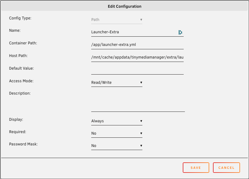

OPTIONAL:
If you want to use extra parameters with TinyMediaManager and use the launcher-extra.yml file:
Host Path Example: /mnt/cache/appdata/tinymediamanager/extra/launcher-extra.yml
NOTE: I created the extra folder inside of tinymediamanager and within it is my custom launcher-extra.yml file

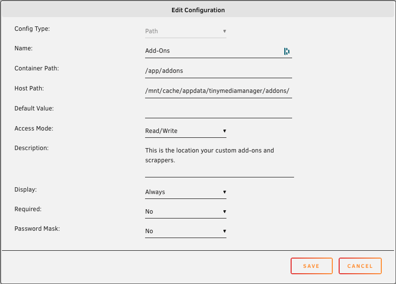

OPTIONAL:
If you want to use custom scrappers you'll need to set this path up between the docker container and your host.
NOTE: I created the addons folder inside of tinymediamanager for future use.
