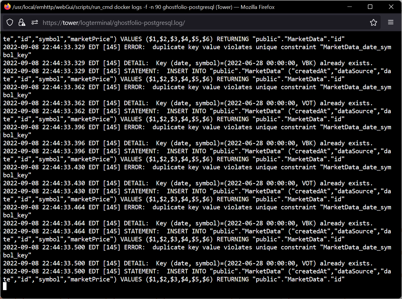

@formless63:
You are trying to add a value which already exists and has primary constraints on it (Key (date, symbol)=(2020-12-29 00:00:00, F) already exists.).
Maybe you can find which entry is trying to add the symbol "F".
Otherwise, you could try to edit you database entries. If you are not familiar with databases, I would be careful with editing database entries directly, as it could lead to a non working state.
I you would like to give it a try, open the console of your postgres container (right click -> Console) and connect to your database via psql:
psql -U ghostfolio -d ghostfolio-db (-U is your username and -d the database name)
With \d you can see all of your existing tables. Here you can find your "MarketData" table which is mentioned in the logs.
With "SELECT * FROM "MarketData";" you can take a look inside of this table and you should see an existing entry with this values: date=2020-12-29 00:00:00, symbol=F.
Maybe you could rename the symbol to something like "F_tmp" to stop the loop for now. I don't know if there are constraints that prevent you from doing this but it might be worth a try: "UPDATE "MarketData" SET symbol='F_tmp' WHERE symbol='F';"
So, give it a try if you want or try setting it up in a separate database and test if this error occurs again.

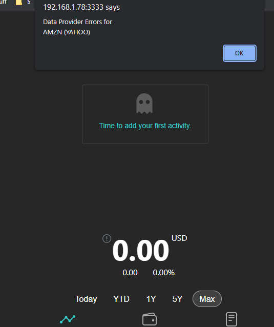

Hi! Thanks for a great container. I have one issue: Everything seems to be working fine but the graph of the start page isn't loading for me. Any idea how I could fix this?

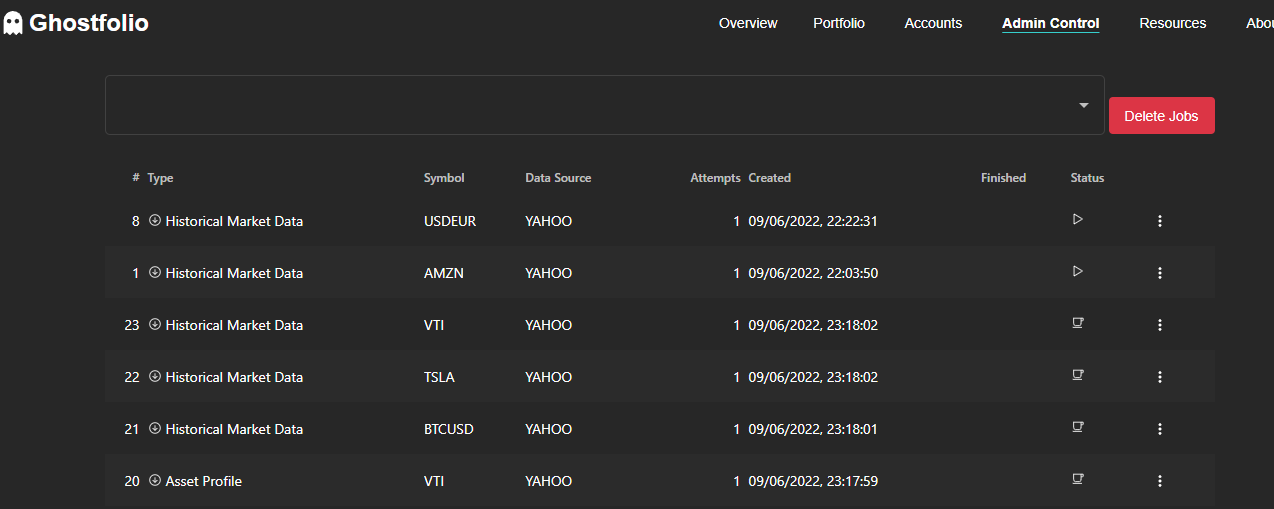

Hello,
I have been trying for days to get GhostFolio working, and after every reinstall I get the same issue. It is unable to download Historical Market Data or current stock prices. Everything else is working fine, I can add stocks and transactions, even get Asset Profiles. It will just not fetch stock prices. What am I missing?!?

Any help is greatly appreciated!

I am also having this same issue. I am unable to get the Data Gather tasks to complete.
Checking the Postgres logs I see this updating several times a second with the same error:
Edited by jdiacobbo
I'm having the same exact issue also!

On 9/7/2022 at 5:38 AM, Russ2900 said:
Hello,
�[32m[Nest] 627 - �[39m09/06/2022, 10:19:01 PM �[32m LOG�[39m �[38;5;3m[NestApplication] �[39m�[32mNest application successfully started�[39m�[38;5;3m +417ms�[39m
�[32m[Nest] 627 - �[39m09/06/2022, 10:19:01 PM �[32m LOG�[39m �[32m ________ __ ____ ___�[39m
�[32m[Nest] 627 - �[39m09/06/2022, 10:19:01 PM �[32m LOG�[39m �[32m / ____/ /_ ____ _____/ /_/ __/___ / (_)___�[39m
�[32m[Nest] 627 - �[39m09/06/2022, 10:19:01 PM �[32m LOG�[39m �[32m / / __/ __ \/ __ \/ ___/ __/ /_/ __ \/ / / __ \�[39m
�[32m[Nest] 627 - �[39m09/06/2022, 10:19:01 PM �[32m LOG�[39m �[32m/ /_/ / / / / /_/ (__ ) /_/ __/ /_/ / / / /_/ /�[39m
�[32m[Nest] 627 - �[39m09/06/2022, 10:19:01 PM �[32m LOG�[39m �[32m\____/_/ /_/\____/____/\__/_/ \____/_/_/\____/ v1.188.0�[39m
�[32m[Nest] 627 - �[39m09/06/2022, 10:19:01 PM �[32m LOG�[39m �[32m�[39m
�[32m[Nest] 627 - �[39m09/06/2022, 10:19:01 PM �[32m LOG�[39m �[32mListening at http://0.0.0.0:3333�[39m
�[95m[Nest] 627 - �[39m09/06/2022, 10:19:02 PM �[95m DEBUG�[39m �[95mFetched 1 quotes from YAHOO in 0.819 seconds�[39m
�[95m[Nest] 627 - �[39m09/06/2022, 10:19:02 PM �[95m DEBUG�[39m �[95m------------------------------------------------�[39m
�[95m[Nest] 627 - �[39m09/06/2022, 10:19:02 PM �[95m DEBUG�[39m �[95mFetched 1 quotes in 0.821 seconds�[39m
�[95m[Nest] 627 - �[39m09/06/2022, 10:19:02 PM �[95m DEBUG�[39m �[95m================================================�[39m
�[95m[Nest] 627 - �[39m09/06/2022, 10:19:03 PM �[95m DEBUG�[39m �[95mFetched 1 quotes from YAHOO in 1.391 seconds�[39m
�[95m[Nest] 627 - �[39m09/06/2022, 10:19:03 PM �[95m DEBUG�[39m �[95m------------------------------------------------�[39m
�[95m[Nest] 627 - �[39m09/06/2022, 10:19:03 PM �[95m DEBUG�[39m �[95mFetched 1 quotes in 1.392 seconds�[39m
�[95m[Nest] 627 - �[39m09/06/2022, 10:19:03 PM �[95m DEBUG�[39m �[95m================================================�[39m
�[32m[Nest] 627 - �[39m09/06/2022, 10:19:03 PM �[32m LOG�[39m �[38;5;3m[DataGatheringService] �[39m�[32mAsset profile data gathering has been completed for AMZN (YAHOO).�[39m
�[32m[Nest] 627 - �[39m09/06/2022, 10:19:10 PM �[32m LOG�[39m �[38;5;3m[DataGatheringProcessor (GATHER_HISTORICAL_MARKET_DATA)] �[39m�[32mHistorical market data gathering has been completed for AMZN (YAHOO).�[39m
�[33m[Nest] 627 - �[39m09/06/2022, 10:19:57 PM �[33m WARN�[39m �[38;5;3m[PortfolioCalculator] �[39m�[33mMissing initial value for symbol AMZN at 2022-09-06�[39m
�[95m[Nest] 627 - �[39m09/06/2022, 10:19:58 PM �[95m DEBUG�[39m �[95mFetched 1 quotes from YAHOO in 0.819 seconds�[39m
�[95m[Nest] 627 - �[39m09/06/2022, 10:19:58 PM �[95m DEBUG�[39m �[95m------------------------------------------------�[39m
�[95m[Nest] 627 - �[39m09/06/2022, 10:19:58 PM �[95m DEBUG�[39m �[95mFetched 1 quotes in 0.821 seconds�[39m
�[95m[Nest] 627 - �[39m09/06/2022, 10:19:58 PM �[95m DEBUG�[39m �[95m================================================�[39m
�[32m[Nest] 627 - �[39m09/06/2022, 10:22:31 PM �[32m LOG�[39m �[38;5;3m[DataGatheringService] �[39m�[32mJob GATHER_HISTORICAL_MARKET_DATA with data {"dataSource":"YAHOO","date":"2018-10-01T00:00:00.000Z","symbol":"AMZN"} already exists.�[39m
�[32m[Nest] 627 - �[39m09/06/2022, 10:22:32 PM �[32m LOG�[39m �[38;5;3m[DataGatheringService] �[39m�[32mAsset profile data gathering has been completed for AMZN (YAHOO).�[39m
�[32m[Nest] 627 - �[39m09/06/2022, 10:22:35 PM �[32m LOG�[39m �[38;5;3m[DataGatheringService] �[39m�[32mAsset profile data gathering has been completed for BTCUSD (YAHOO).�[39m
�[32m[Nest] 627 - �[39m09/06/2022, 10:22:40 PM �[32m LOG�[39m �[38;5;3m[DataGatheringService] �[39m�[32mAsset profile data gathering has been completed for TSLA (YAHOO).�[39m
�[32m[Nest] 627 - �[39m09/06/2022, 10:22:45 PM �[32m LOG�[39m �[38;5;3m[DataGatheringService] �[39m�[32mAsset profile data gathering has been completed for VTI (YAHOO).�[39m
�[33m[Nest] 627 - �[39m09/06/2022, 11:06:02 PM �[33m WARN�[39m �[38;5;3m[PortfolioCalculator] �[39m�[33mMissing initial value for symbol AMZN at 2022-09-06�[39m
�[95m[Nest] 627 - �[39m09/06/2022, 11:06:03 PM �[95m DEBUG�[39m �[95mFetched 1 quotes from YAHOO in 1.693 seconds�[39m
�[95m[Nest] 627 - �[39m09/06/2022, 11:06:03 PM �[95m DEBUG�[39m �[95m------------------------------------------------�[39m
�[95m[Nest] 627 - �[39m09/06/2022, 11:06:03 PM �[95m DEBUG�[39m �[95mFetched 1 quotes in 1.695 seconds�[39m
�[95m[Nest] 627 - �[39m09/06/2022, 11:06:03 PM �[95m DEBUG�[39m �[95m================================================�[39m
�[95m[Nest] 627 - �[39m09/06/2022, 11:06:04 PM �[95m DEBUG�[39m �[95mFetched 1 quotes from YAHOO in 1.515 seconds�[39m
�[95m[Nest] 627 - �[39m09/06/2022, 11:06:04 PM �[95m DEBUG�[39m �[95m------------------------------------------------�[39m
�[95m[Nest] 627 - �[39m09/06/2022, 11:06:04 PM �[95m DEBUG�[39m �[95mFetched 1 quotes in 1.516 seconds�[39m
�[95m[Nest] 627 - �[39m09/06/2022, 11:06:04 PM �[95m DEBUG�[39m �[95m================================================�[39m
�[33m[Nest] 627 - �[39m09/06/2022, 11:06:05 PM �[33m WARN�[39m �[38;5;3m[PortfolioCalculator] �[39m�[33mMissing initial value for symbol AMZN at 2022-09-06�[39m
�[33m[Nest] 627 - �[39m09/06/2022, 11:06:09 PM �[33m WARN�[39m �[38;5;3m[PortfolioCalculator] �[39m�[33mMissing initial value for symbol AMZN at 2022-09-06�[39m
�[95m[Nest] 627 - �[39m09/06/2022, 11:06:10 PM �[95m DEBUG�[39m �[95mFetched 1 quotes from YAHOO in 1.343 seconds�[39m
�[95m[Nest] 627 - �[39m09/06/2022, 11:06:10 PM �[95m DEBUG�[39m �[95m------------------------------------------------�[39m
�[95m[Nest] 627 - �[39m09/06/2022, 11:06:10 PM �[95m DEBUG�[39m �[95mFetched 1 quotes in 1.344 seconds�[39m
�[95m[Nest] 627 - �[39m09/06/2022, 11:06:10 PM �[95m DEBUG�[39m �[95m================================================�[39m
�[33m[Nest] 627 - �[39m09/06/2022, 11:17:40 PM �[33m WARN�[39m �[38;5;3m[QueueService] �[39m�[33mError: Could not remove job 8�[39m
�[33m[Nest] 627 - �[39m09/06/2022, 11:17:40 PM �[33m WARN�[39m �[38;5;3m[QueueService] �[39m�[33mError: Could not remove job 1�[39m
�[32m[Nest] 627 - �[39m09/06/2022, 11:18:00 PM �[32m LOG�[39m �[38;5;3m[DataGatheringService] �[39m�[32mJob GATHER_HISTORICAL_MARKET_DATA with data {"dataSource":"YAHOO","date":"2017-01-03T00:00:00.000Z","symbol":"USDEUR"} already exists.�[39m
�[32m[Nest] 627 - �[39m09/06/2022, 11:18:00 PM �[32m LOG�[39m �[38;5;3m[DataGatheringService] �[39m�[32mJob GATHER_HISTORICAL_MARKET_DATA with data {"dataSource":"YAHOO","date":"2018-10-01T00:00:00.000Z","symbol":"AMZN"} already exists.�[39m
Hi @Russ2900 @jdiacobbo @Hans Payer,
Thank you for providing detailed information about this issue. It looks familiar to me, as I have seen it some times in the Github issues:
- e.g. https://github.com/ghostfolio/ghostfolio/issues/569#issuecomment-1001042365
- e.g. https://github.com/ghostfolio/ghostfolio/issues/522
In newer versions, it shouln't be a problem anymore :| Would you be so kind and create an issue at the ghostfolio repository: https://github.com/ghostfolio/ghostfolio/issues/new
You can copy your entry from here or link it to the issue. A current version number you are experiencing the issue would help aswell. Software Bugs / Improvements should be created as issue on github :) Maybe one of you can create the issue and the others can add information to drill down the problem.
Thank you!

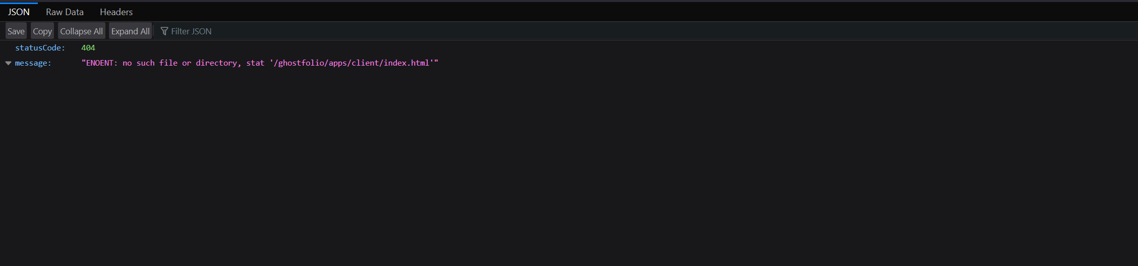

Getting the following error after updating to the latest docker version:
This is fixed in git
On 9/11/2022 at 6:51 AM, jdiacobbo said:
I have played around with this, and installing with docker-compose it works,  installing separately using the Apps using the same Repositories as the docker compose file it gives the duplicate key errors.  No comments have been made on the github.
Create a new Ghostfolio container Variable  NODE_ENV and set it to "production" to get it to run .
Edited by duckey77
spelling correction
This resolved the 'no such file' error. Still getting the database error with the Community Apps container install. If you are not getting that error with Docker Compose then would that suggest the issue is with the CA template?
