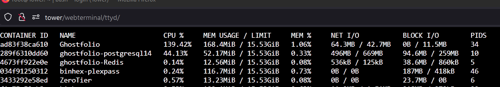

Edit2: The CPU usage is pretty high.  I'm not doing anything with the web ui - it's not even working and it's using a bunch of CPU power. Am I the only one seeing this?

My ghostfolio idle CPU consumption is in the neighborhood of 0.01% to 0.03%.

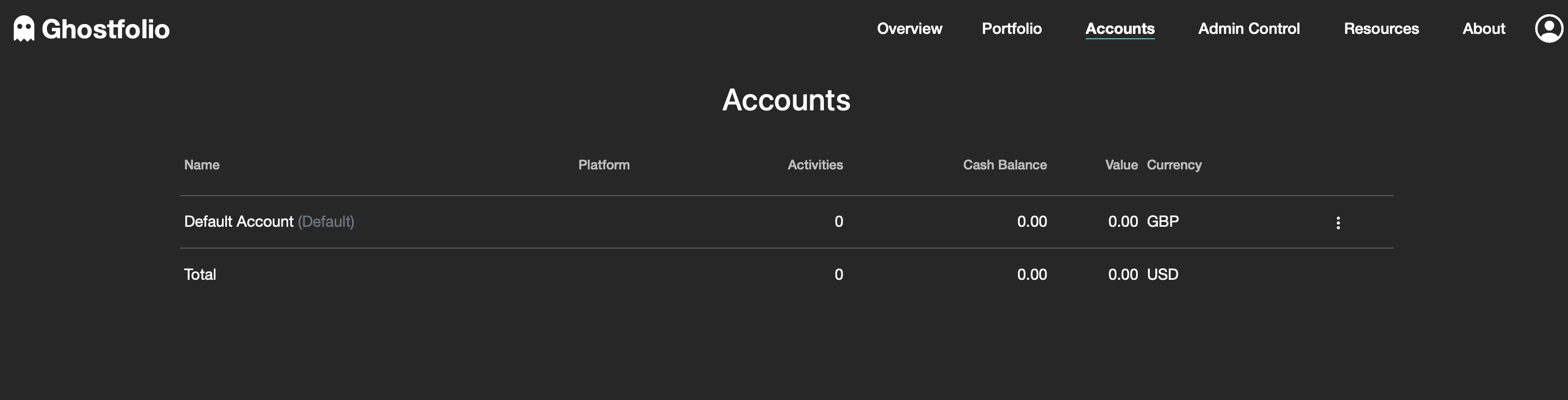

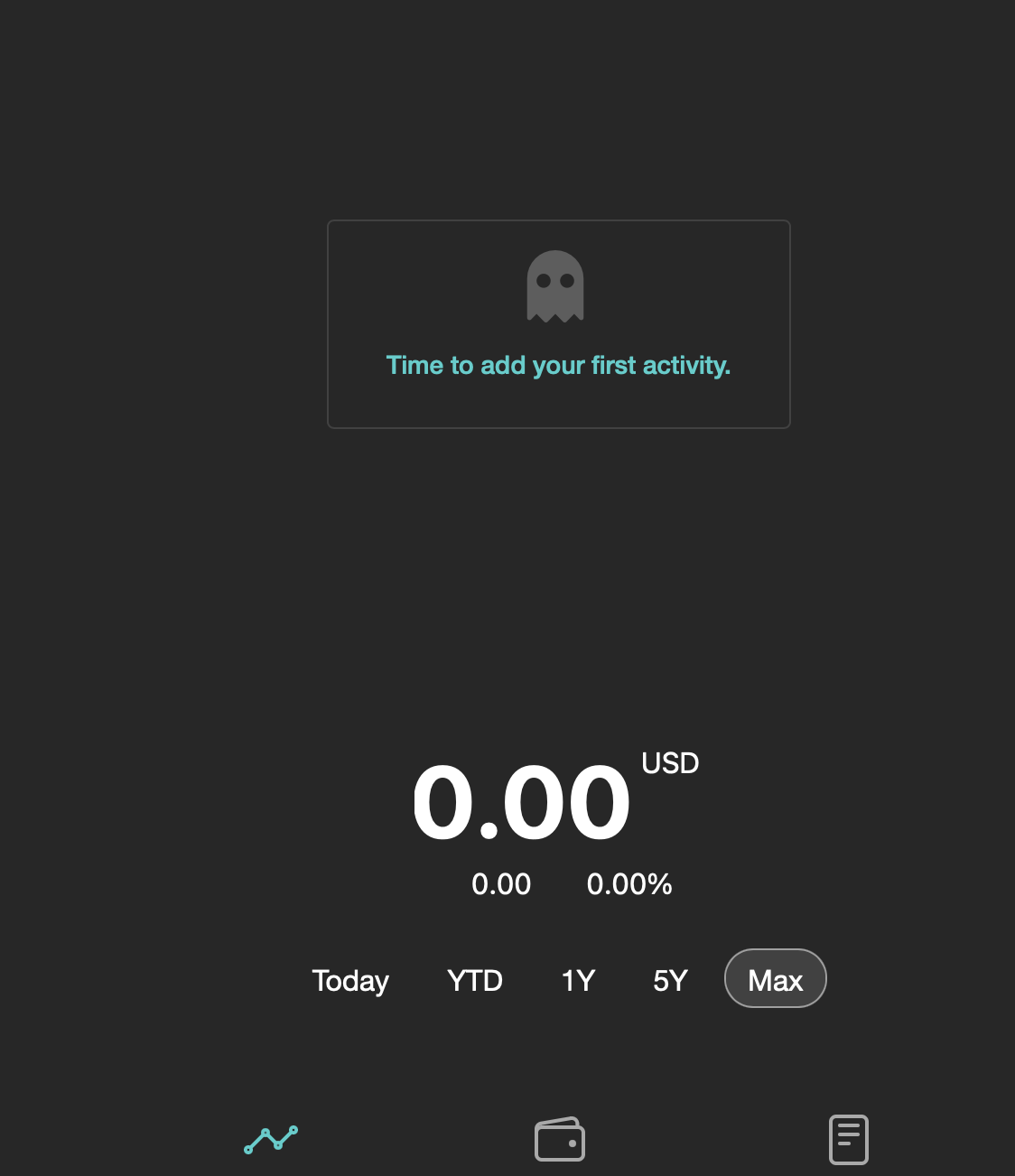

Great app - small thing input GBP but it keeps showing me USD
334685513_Screenshot2022-09-28at00_39_53.thumb.png.7325d2ec2e5093c1e34589044eb4d7fb.png
Edited by dopeytree
Make sure you set the "Base Currency" to GBP under Account in "My Ghostfolio" page

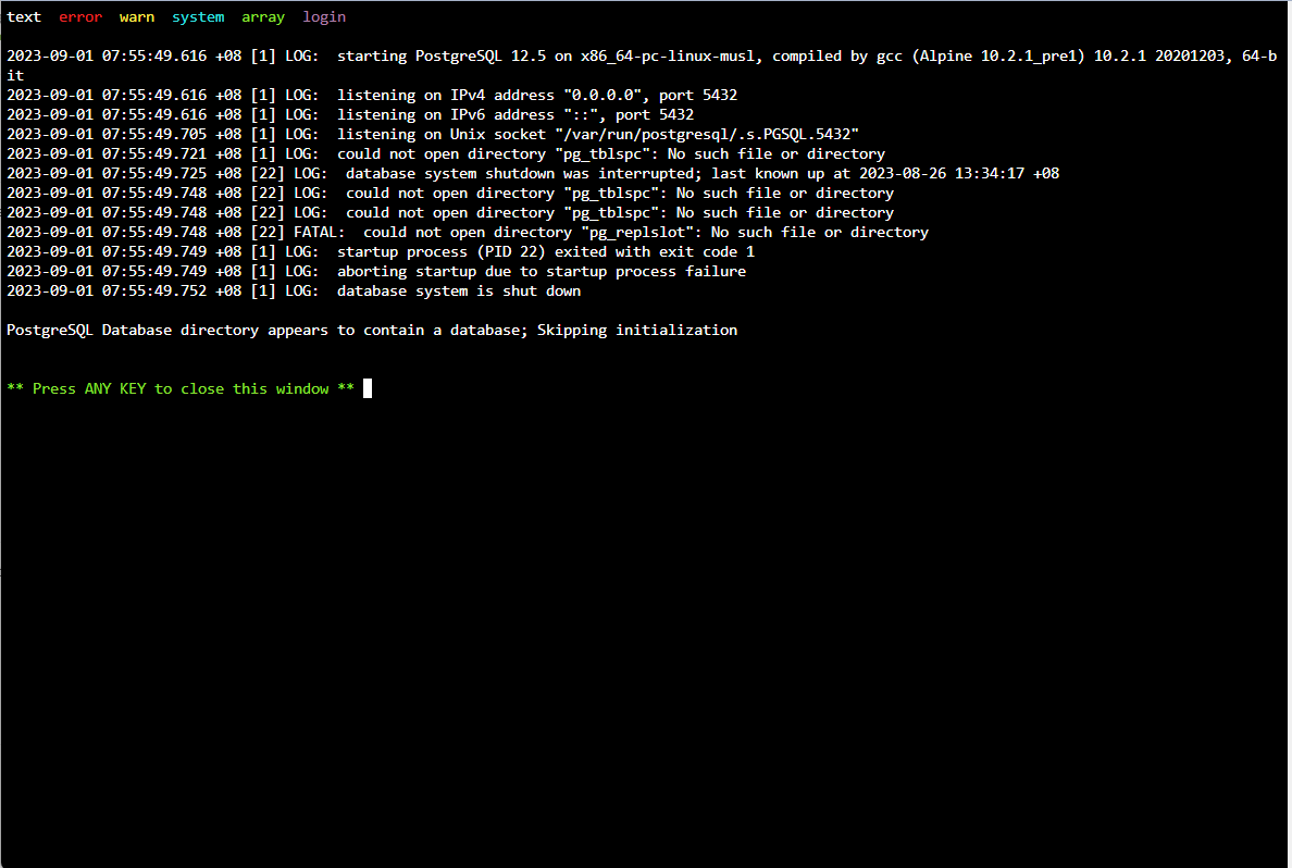

Hi Guys,
Need some help! Followed the installation instructions. Using Postgres 12.5.
It work fine the first time, then after a few days postgres stops working. When i try to start the container, i get the following errors (copied from my log file). I've been more of a hardware guy and now trying to learn more about dockers and backend development. Tried searching on then net, but still stuck. Thank you for your time in advance!!
PS: Done 3 fresh installations, with the first one using Postgres 14, but the issue persists.
