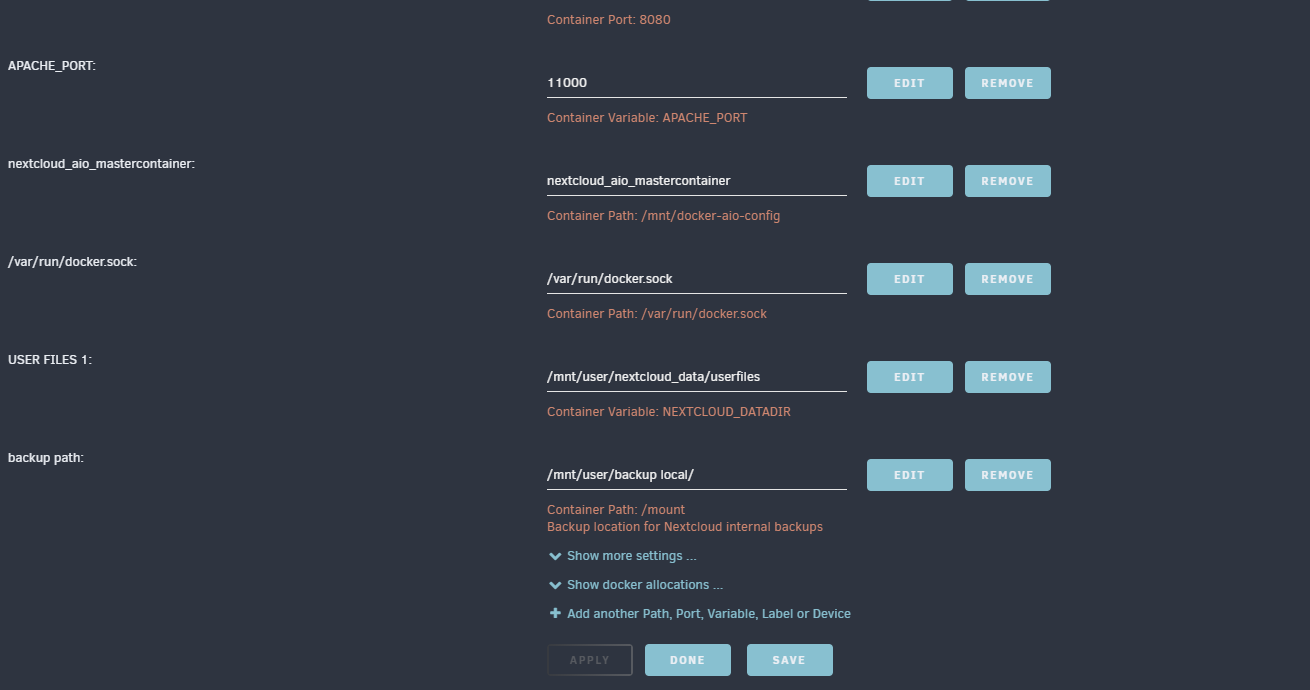

I attempted to setup Nextcloud AIO on Unraid but I can't seem to get to work. I tried using an Ubuntu VM and a guide but I get an error saying the DNS doesn't point to this server. I have no idea what could be causing the issue. I have spend days trying to set it up but nothing works.
I’m trying to setup the all in one instance of nextcloud. I’m ultimately trying to get better performance out of nextcloud. It seems like I’m missing something when setting up but I don’t know what it is. I have nextcloud already running but its not the AIO.
I tried installing it directly through unraid but when I go to the address at the end it pulls up the nextcloud login but it never gives me the password as it does with the Ubuntu install. Can anyone chime in with some help?

i followed the szaimen guide but doesnt work, i'stuck at ngix proxy manager step

41 minutes ago, Morpheus1988 said:
"/mnt/user/Nextcloud AIO/:/mnt/docker-aio-config:rw"
This is what is not supported.
It must be "nextcloud_aio_mastercontainer:/mnt/docker-aio-config:rw" but please try again after resetting properly.

reinstalled and now it is configured correctly, but i have the same problem. The ngix server is on another machine, do i need some option to configure for this scenario?
Edited by Morpheus1988
add image

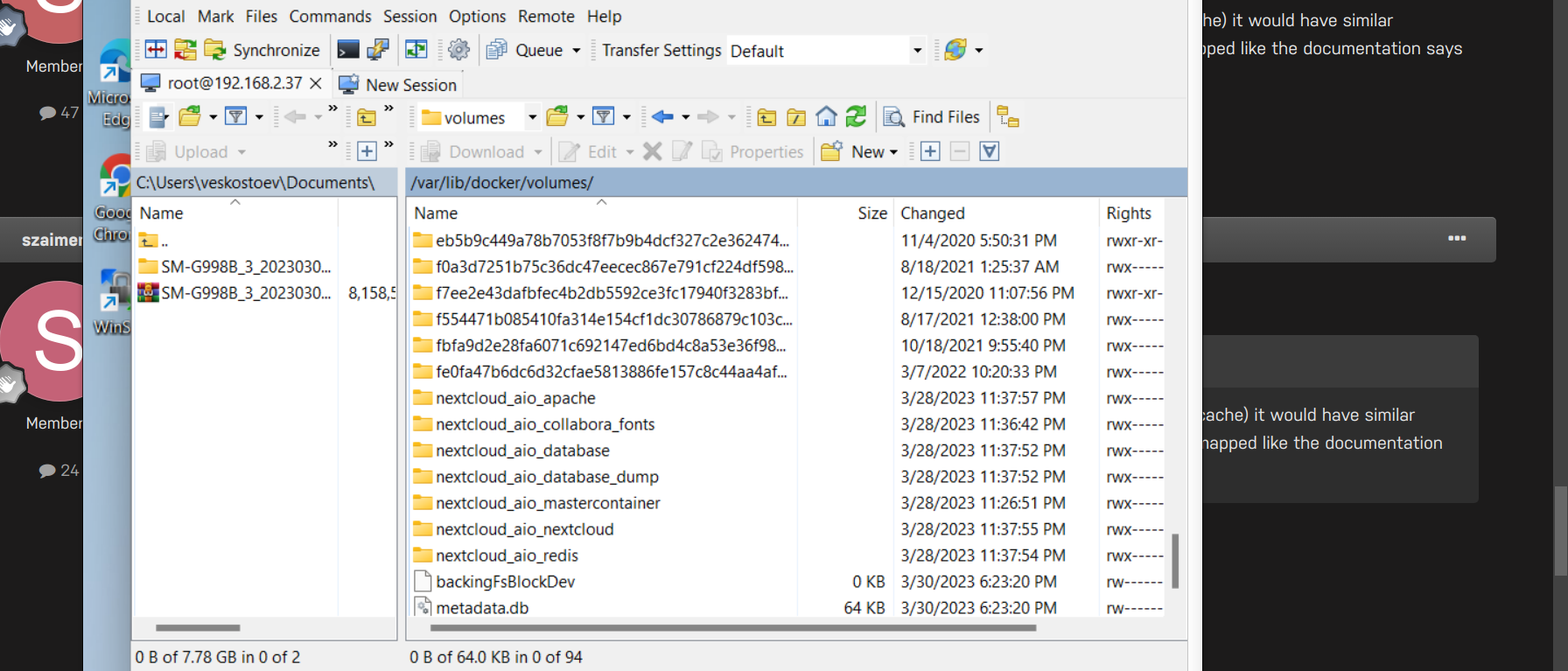

To not change Unraid permissions everytime after reboot go to directory on the screenshot which i attached and
login with WinSCP to Unraid but before that enable SSH in Unraid interface in Permissions in Settings i think was.
,,config.PHP,,
just change
check_data_directory_permissions' => false
Edited by Vesko
