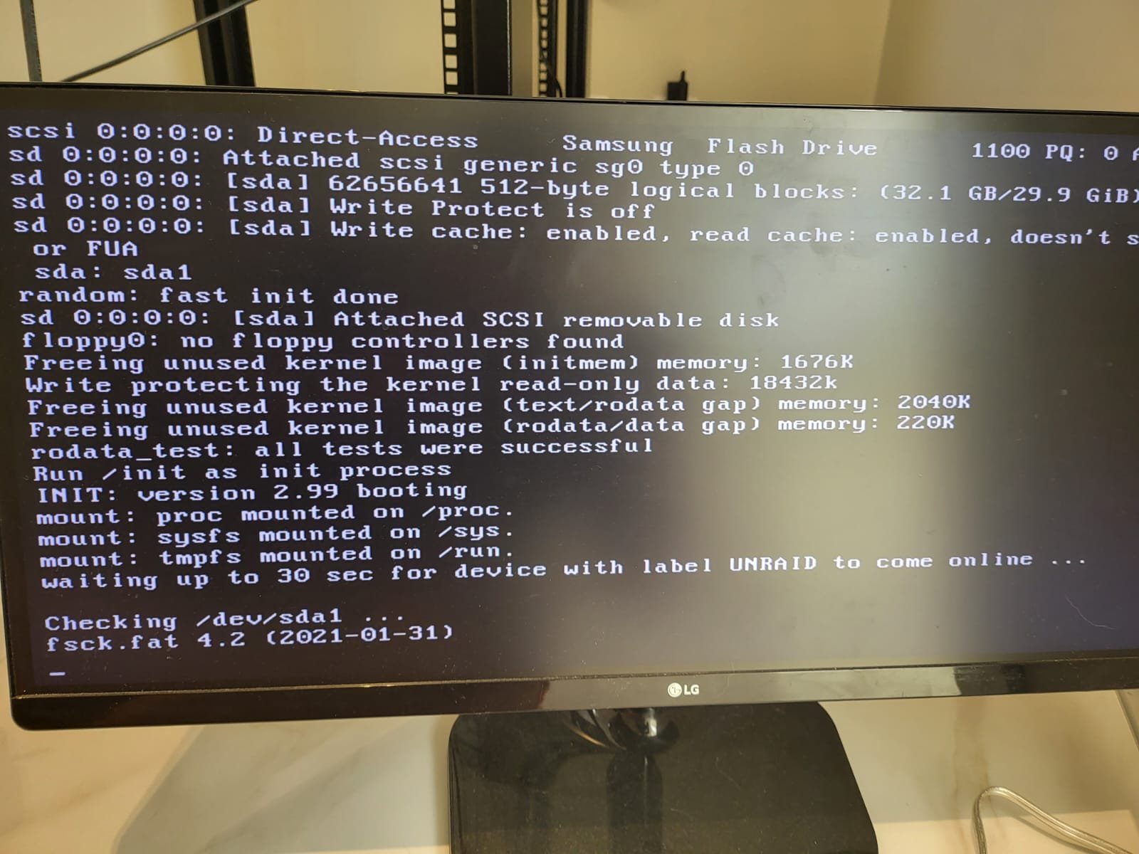

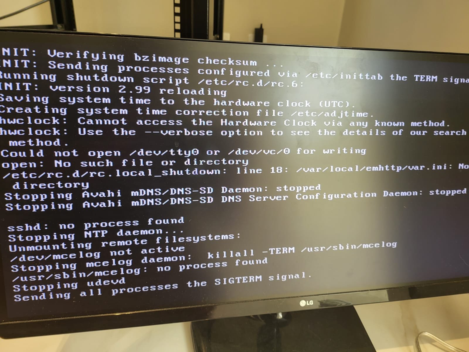

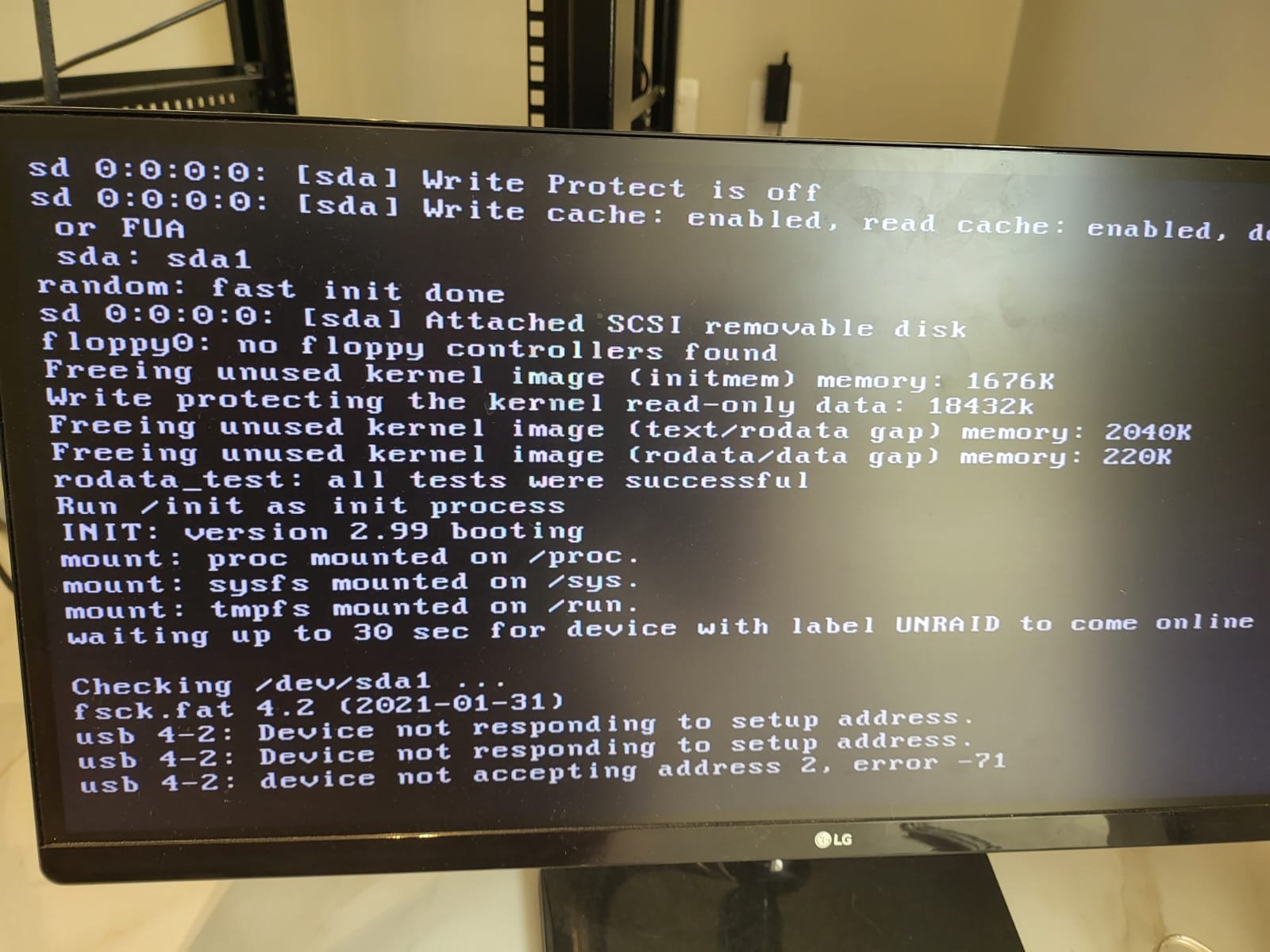

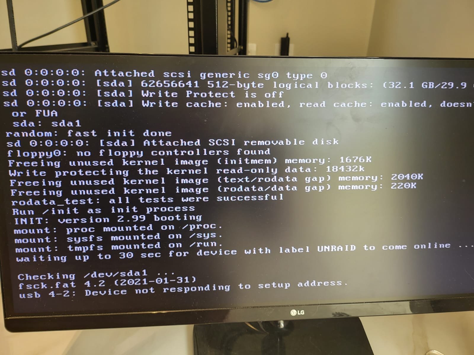

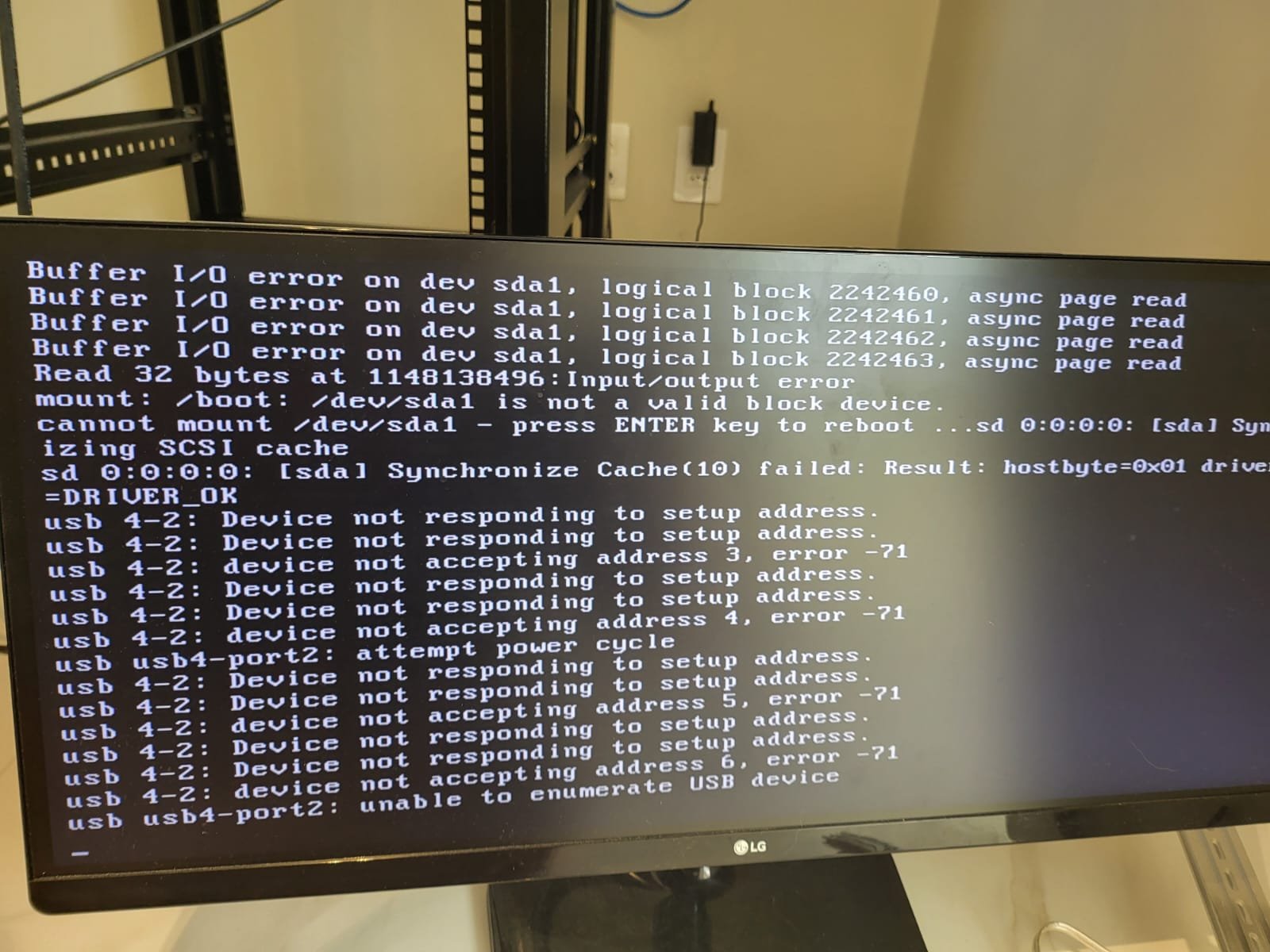

Just upgraded from 6.9.2 stable to 6.10.0 stable.
Everything was working perfect, before de upgrade.
The unraid wont boot! After i changed the usb port for the flash drive it showed a lot of different messages (attached in the post)
Please kindly see my some screenshots.
How can i revert to the 9.6.2 if the unraid won't even start?
Thanks in advanced!

Are you using the 6.10.0 or the 6.10.1 release?   The latter has a fix for the UNRAID partition on the flash not being partition 1 which it looks like it could be your problem?

Easiest thing is to download the zip for the 6.10.1 release from the Unraid download page and then extract all the bz* type files overwriting the ones on the flash.

Yes, although you should ideally also do the same with the changes.txt file.

Thanks @itimpi! When i put only the BZ* files it didn't worked. But when i sent the changes.txt as well, all worked like a charm!
