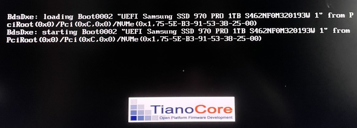

Initially I had Win10 setup on my passed through NVMe drive using Space's windows clover image.  After reading, I created a new Windows 11 VM and pointed it to my Windows 10 install directly and stopped using the windows clover image.  However, I still had this issue when using the windows clover image as well after updating to Windows11.  I've gone into the OVFM BIOS and set the NVMe to the 1st boot drive and I have tried several modifications to my template.  If anyone knows what to do to stop the error I would be grateful for assistance.
When I first try to boot Windows11 the VM stalls at the error.  I then have to Force Stop the VM in unRAID.  Then, when I start it the second time I still get the error, but it boots right up into Windows11.  If I go into the OVFM bios and tell it to boot from the NVMe it will also boot.  I have a feeling this is simple?

Solved by craigr
Hi!
What do you mean by "error"?
If you are referring to your screenshot, that are not errors, but it's a verbose mode that tells you that the bdsdxe driver is first loading and then starting Boot0002 entry.
If your windows 11 starts if booted directly from ovmf menu, try to add the boot order line to the nvme block, something like this:

Thanks for your help.  Things are improved, but still not quite right.  The first boot attempt for Windows 11 now fails and gets stuck on the TianoCore screen and just sits there.  I then have to force stop in unRAID.  Any subsequent boots after that work and Windows 11 starts every time.
When I first adjusted the XML and launched the VM I got Windows diagnostics attempting to repair my computer.  I was then prompted to restart and after that it's been working except on first launch after unRAID reboots.
Anymore ideas?  The NVMe is at the very bottom of the XML on BUS 08.

On 5/28/2022 at 5:44 PM, craigr said:
Anymore ideas?
sorry, no ideas...I hate when things don't work randomly or when it seems there's no sense (in this case the fail on first boot...but Why??...)
Right?!?! 😄
Even if I create a brand new Windows 11 VM the same thing happens.
I'll just have to live with it for now.  Typically unRAID goes months without being rebooted anyway.  Just now with the release of 6.10.0, 6.10.1, 6.10.2, and probably more to come there has been more rebooting.  Nobody in the house likes it when OPNsense is down even for just 10-15 minutes ;-)
Thanks for your help,
craigr
Edited by craigr
Is there a way to get a more verbose display during boot?  Maybe I could track it down than.  I don't know when it is hanging up.
Edited by craigr
never done this but you may try one of these:
1. from windows, search 'system configuration' app, boot tab, check 'os boot information' and 'boot log', or
2. in a cmd type:
bcdedit /bootdebug {bootmgr} on
bcdedit /bootdebug on
bcdedit /debug on
This should enable debug for windows boot manager, bootloader and kernel
If this combination is used, the target computer will break into the debugger three times: when Windows Boot Manager loads, when the boot loader loads, and when the operating system starts up.
Edited by ghost82
Talk about 'use it or lose it.'  I forgot all about the system configuration it's been so long since I last needed it.
Thanks again.
With trepidation I say that I think I fixed it.  I did several things, but what I think got it working (and I don't know why) is switching the slot for my serial controller with the slot for my NVidia graphics card.  So, I started with this in my Windows 11 template:
    </controller>
      <driver name='vfio'/>
      <source>
        <address domain='0x0000' bus='0x01' slot='0x00' function='0x0'/>
      </source>
      <rom file='/mnt/pool/vdisks/vbios/My_Inno3D.GTX1650.4096.(version_90.17.3D.00.95).rom'/>
    </hostdev>
      <source>
        <address domain='0x0000' bus='0x01' slot='0x00' function='0x1'/>
      </source>
    </hostdev>
And ended with this:
      <alias name='virtio-serial0'/>
    </controller>
      <source>
      </source>
      <alias name='hostdev0'/>
      <address type='pci' domain='0x0000' bus='0x00' slot='0x04' function='0x0' multifunction='on'/>
    </hostdev>
      <source>
      </source>
      <alias name='hostdev1'/>
      <address type='pci' domain='0x0000' bus='0x00' slot='0x04' function='0x1'/>
    </hostdev>
Two things gave me the idea to try this.  Firstly, ever since upgrading from Windows 10 to Windows 11 and creating the new Windows 11 VM template; if I edited the template such that the NVidia was working as a multifunction device on the same slot (video and sound), the VM would not boot and just hand on the BIOS screen.  No idea why.  Also to experiment, I created another brand-new Windows 11 VM template that would have overwritten my existing NVMe Windows 11 install, but I did not start the experimental VM so that it wouldn't overwrite.  I examined and compared the templates.  This experimental template gave my NVidia video card slot 4 so I decided to give the NVidia card slot 4 in my existing template (I then had to move the serial slot and just put it on 5).
Other things I tried but do not think worked at all include:
1) Entering the OVFM BIOS and removing all boot options except the NVMe.  This I tried first and it did not work.  Also, when I would reboot the Windows 11 VM the settings would always revert back even after saving (no idea why) and the VM would not boot.
2) I also removed my Windows 11 OS Install ISO and VirtIO Drivers ISO from the template.  I tried booting several times and this did not seem to work.
Finally, I changed the slots between the serial and video/sound cards and that seems to have done the trick.  I have rebooted unRAID several times and Windows 11 has started automatically every time without hanging and I have rebooted, stopped, started Windows 11 and it has started every time.
So, I am hopefully not jinxing myself by saying I think it's fixed (knock loudly on wood).
Strike the above post.  I seem to have broken the VM again and fixing it again.  I re-added my Windows 11 OS Install ISO and VirtIO Drivers ISO from the template and then the Windows 11 would not boot consistently  again 🤬.  So I recreated the experimental Windows 11 VM on my NVMe again and as soon as I did that my existing VM on the NVMe started booting properly again!  It seems the act of simply making a new template on the VM fixes the problem!
I now have proper booting and my Windows 11 OS Install ISO and VirtIO Drivers ISO in place.  I do not have
<boot order='1'/>
and I do have back
<boot dev='hd'/>
When I used the template to add back the Windows 11 OS Install ISO and VirtIO Drivers ISO discs the template created a boot order equals two for the VirtIO Drivers ISO and no boot order equals one for the SSD.  I tried adding boot order for the NVMe and removing the boot order line for the VirtIO, but it didn't help.
Only creating the new experimental template fir Windows 11 on the NVMe and then manually editing the template to add the ISO's back (without the boot order equals two) got everything square.
 Oh well, whatever, it works now 🥃🥃🥃

Yeah, changed slots back on serial and video card without issue.  That was never the problem.
