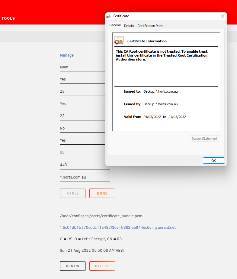

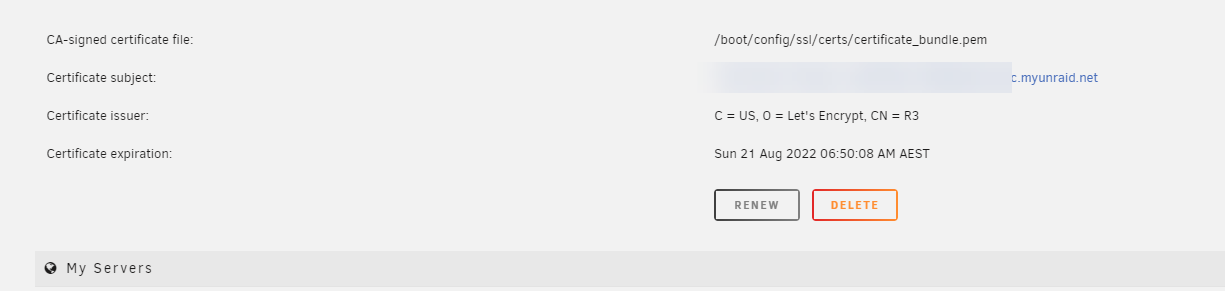

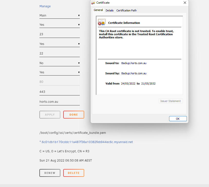

"Sorry about the double up of screen shots but when I paste into the forum it puts double in for some reason."
I tried to do it bother ways with the wildcard cert I have but it wont pick up the local Certificate and if I dont provision the unraid cert I cant use the My Servers
Edited by Joedy

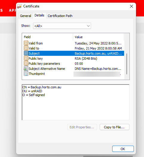

You showed a screenshot of your browser where it showed you the certificate information. Click the Details tab and find the "Subject" field. What url is listed there in the "Subject" field? A screenshot of this would be great.
What url do you want to use to access the server?

the cert screenshots is just the unraid cert not my actual certificate.

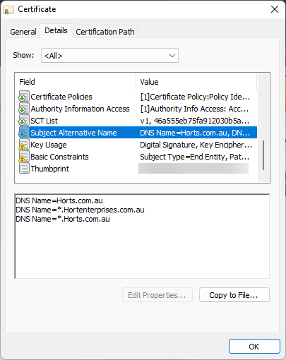

this is the cert it should be using, was using before the upgrade Multi domain wildcard Certificate

When you change "Use SSL/TLS" to Yes, Unraid will automatically make a self-signed certificate with the "Subject" of "backup.horts.com.au" and place it on the flash drive here:
   config/ssl/certs/backup_unraid_bundle.pem
The screenshot you provided of your custom certificate uses the "Subject Alternative Name" field, which Unraid ignores. It sort of worked in 6.9.2, but only by accident. It will not work in Unraid 6.10.
If you want to provide your own certificate, you need to make sure the "Subject" of the certificate is either "backup.horts.com.au" or "*.horts.com.au". Then overwrite the certificate that Unraid created on your flash drive:
You can then change "Use SSL/TLS" back to No and then to Yes again to get it to see the cert. Or you can open a web terminal and run:
  /etc/rc.d/rc.nginx reload
Note that if the "Subject" of the cert is not correct, the certificate will be deleted and replaced with a self-signed cert that has the correct Subject.
