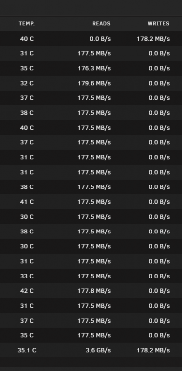

It's very strange, doesn't make sense CPU being at 100% while syncing at 16MB/s, don't really now what else to try, you can run diskspeed docker just to make sure all disks are performing normal.
Other thing you could try is doing a new config and just assign about half of current array drives, see if there's a difference, if it's the CPU that is somehow limiting it should be noticebly faster, or sync the entire array with single parity also to compare.

Long story short, the parity appears to have gone back to normal.
I tried so many different things, I have no idea what fixed it.
