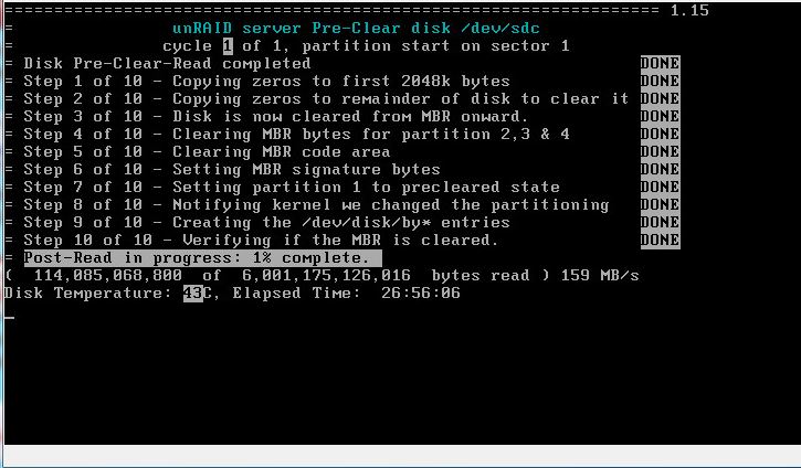

This may have been answered but a search through the 83 odd pages here hasn't revealed anything...
Whenever I run precelar on my server, it invariably locks up the system requiring a hard-reset.
My most recent attempt was to preclear a 4TB drive. I opened a screen session and initiated the process. Step 1 completed and step 2 reached 50% when the entire system locked up - VMs froze, GUI was inaccessible, direct typing on the server command line was not accepted. Reset switch was the only way back.
This has happened me before on larger drives. I had problems with a previous 4TB drive but I thought it might be the drive itself. Since the, I've replaced the MB and PSU on the system and this is a brand new HD.
Normally I'd try this in another system but I don't have any other unraidable systems that support > 2Tb drives.
Pointers appreciated.
Peter
Have you tried it in safe mode with no VMs or plugins? Preclear had been used extensively, and the problem is very likely in your system or configuration.
Peter
How much memory do you have?
32GB
Though some of that's in use by VMs. During yesterdays test, there would have been 16GB available to unRaid.
Peter
FFS.
Got to 8% on the first stage and locked up the server. Can't ssh, access webGUI or type on the server console itself. VMs still running and shares accessible but that's it.
This is super frustrating.
P
