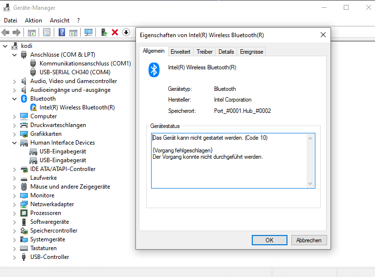

when the vm is started, the wifi devices seems to work fine, no errors in the device manager, but when trying to active the wifi it is not activating nor searching for wifi networks
the bluetooth adapter directly fails to run, error code 10 inside the device manager

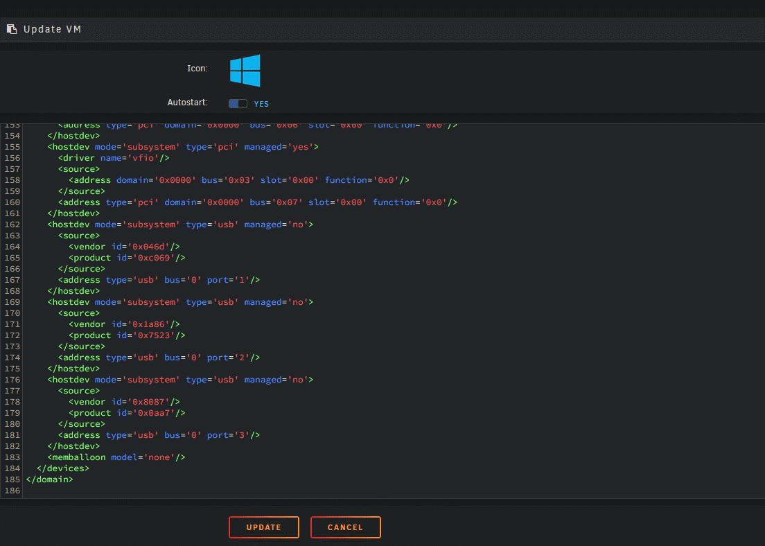

- tried to follow the solution on the linked topic above, but i was not able to change the bus, it did not allow it cause the bus number did not exists,
i am not able to copy & paste the xml sheet, since 6.10, it always copies "-" instead of the content, so i have added this screenshot

i was not able to add a screenshot to the initial topic so i have attached it here, sorry for the german gui, but it is only showing error code 10 <.< guess this is not an issue to read

From your latest attachment it doesn't seem tou pasted and saved the block.
well what shall i say, i have added the block to the end , and clicked save.
point of proof added, but i do see what you mean, it is not saving as expected
maybe this corelates with the issue that i can not copy anything from the xml to the clipboard, this issue started with 6.10, it was working fine with 6.9.2
is there a way to change the xml via the console directly?

@astronax I think I found the culprit for the issue "xml is not saving".
I had a spare usb key with unraid 6.10.1, I had also an additional pendrive, so made the array on that usb pendrive :D just to test the qemu/libvirt behavior.
Just a note on my above post: one, before using the virsh command should export nano as default editor with this command (in terminal):
export EDITOR='/usr/bin/nano'
then run the virsh command.
However it is not needed to run the virsh command and unraid gui in xml view can be used.
The issue is that the domain type line is stripped by unraid.
When you view your xml in unraid make 2 changes:
1. on the top you will see a line with this:
<domain type='kvm'>
Change it to:
<domain type='kvm' xmlns:qemu='http://libvirt.org/schemas/domain/qemu/1.0'>
Then to the bottom add:
  <qemu:capabilities>
    <qemu:del capability='usb-host.hostdevice'/>
  </qemu:capabilities>
before the </domain> tag.
This time it will save.
I found this because using the virsh command failed to validate too, because qemu schemas was not defined.
PS: not sure if this will solve your bluetooth/wifi issue, just try...
