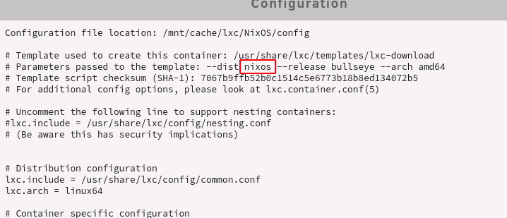

I wanted to use nix / nixos and I couldn't find any info in this thread.
Thank you for the write up!
If you are interest I can add a logo for NixOS in the next update from the plugin, you would only need to make a minor change to the config to see the logo afterwards on the LXC page. :)
EDIT: This would look something like that:
That would be cool!
8 hours ago, The_Eric said:
That would be cool!
Please update the plugin and change your config so that it shows in the marked spot "nixos":
(so to speak if you used Ubuntu to create the template then change "ubuntu" to "nixos")

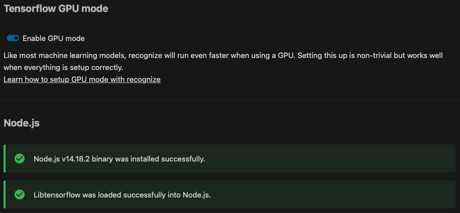

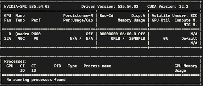

Is it possible to run CUDA in a LXC container? Having an issue and I'm unsure of where to start troubleshooting.
I have my Quadro P400 exposed to my Ubuntu 22.04 container and can see it from nvtop inside the container.
Driver in the container is the 535 branch, the exact same version that is installed in unraid.
Inside the container I have installed CUDA 11.2 and cuDNN 8.1.0. Both seem to be installed fine.
The issue is the app I need the GPU for says that it has loaded all the libraries but that it cant load the GPU…
I don’t know if its a permissions issue or what.
For those curios im trying to setup the Nextcloud app Recognize.

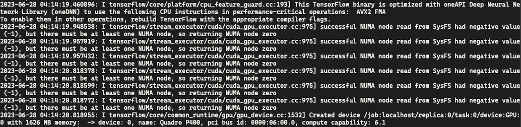

@ich777 ok I managed to figure out the issue. When I first setup the container I needed to add to my config,
lxc.cgroup2.devices.allow = c 195:* rwm
lxc.cgroup2.devices.allow = c 243:* rwm
and I did verify at the time that 195 and 243 were correct. However I have re-created this container several times and tried different distros in-between and for whatever reason it has changed to 195 and 238...I didn't realize that could change.
But regardless after manually installing the nvidia driver, manually installing cuda and cuDNN It appears to be finally working!
