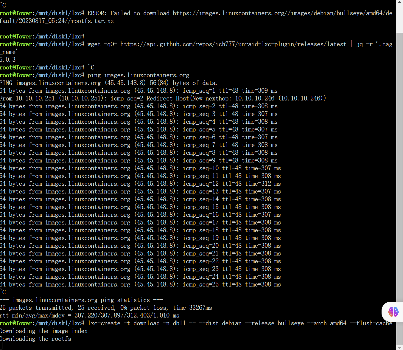

hi
For beginners, the image was never downloaded, but the ping was successful
Tried many things, but nothing worked
It is possible that they currently have issues with their image distribution system.
May I ask where you are located in the world?
Have you yet tried to download a Debian Bookworm or Bust image? Do other images work?
There is not much I can do about if the download doesn't work because this is a LXC thing. Do you have any ADBlockers or special Firewall rules set on your network?
Can you download this file from your local computer:
https://images.linuxcontainers.org/images/debian/bullseye/amd64/default/20230817_05%3A24/rootfs.tar.xz
A simple ping doesn't mean often times that everything else is working, the above linked file is what the plugin tries to download. If the download from your local computer is working (which it is in my case and also on Unraid) something else with your Network configuration may be wrong.
Thank you, it is still a network problem, the original download speed is too slow to time out, through the proxy connection, i can install normally.
ps:I'm in China
That is really strange, as far as I remember they don't have a timeout for the downloads in the source, it just stops when the download pipe breaks.
ps:I'm in China
Do you maybe have a LXC mirror over there?
I added the possibility to change the download URL from the LXC containers. If there is a mirror over there and they follow the default structure you can change the URL on the Settings page from LXC.
Just a little side information, the mirror need to have all the necessary metadata in place which you can find here and of course the corresponding images like they are structured here.

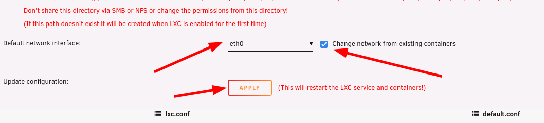

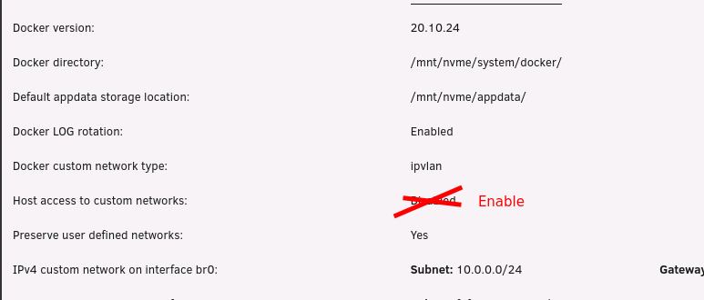

Hey guys, i think the recent unraid update (6.12.4) broke something regarding lxc networking. I have updated and switched to macvtap driver (disabled bridging) and now my containers are unable to ping my lxc container and vice-versa. The lxc cointainer is also unable to ping the host. I have tested eth0 and virhost0 as network interfaces for lxc, but both arent working. Is there anything i can do?
Please do the following:
Enable Host access in the Docker Settings:
On the LXC Settings page set the network to eth0, click the Box "Change network from existing container" and then hit Apply:grafik.thumb.png.fa197af30b0cf525a03ce626ba471fb2.png
This should do the trick.
already done this, or to be precise, already have been doing this since ever
But ok, i did this and it worked, so i guess the update broke the setting there. It was still enabled, but it seems like it was disabled. Disabling and reenabling it helped, thx
Edited by Joly0
I introduced this settings to the plugin because of the macvtap change in Unraid and tested this excessively. The only thing that is really necessary is that you enable Host access on the Docker page and that you also tick the box Change networks from existing containers.
You can also use virhost0 instead of eth0 but I don't recommend that and would actually not display the correct traffic on the LXC page <- please note that you will now only see the whole traffic for eth0 right next to the containers, this is a downside from macvtap and I can't do much about that.

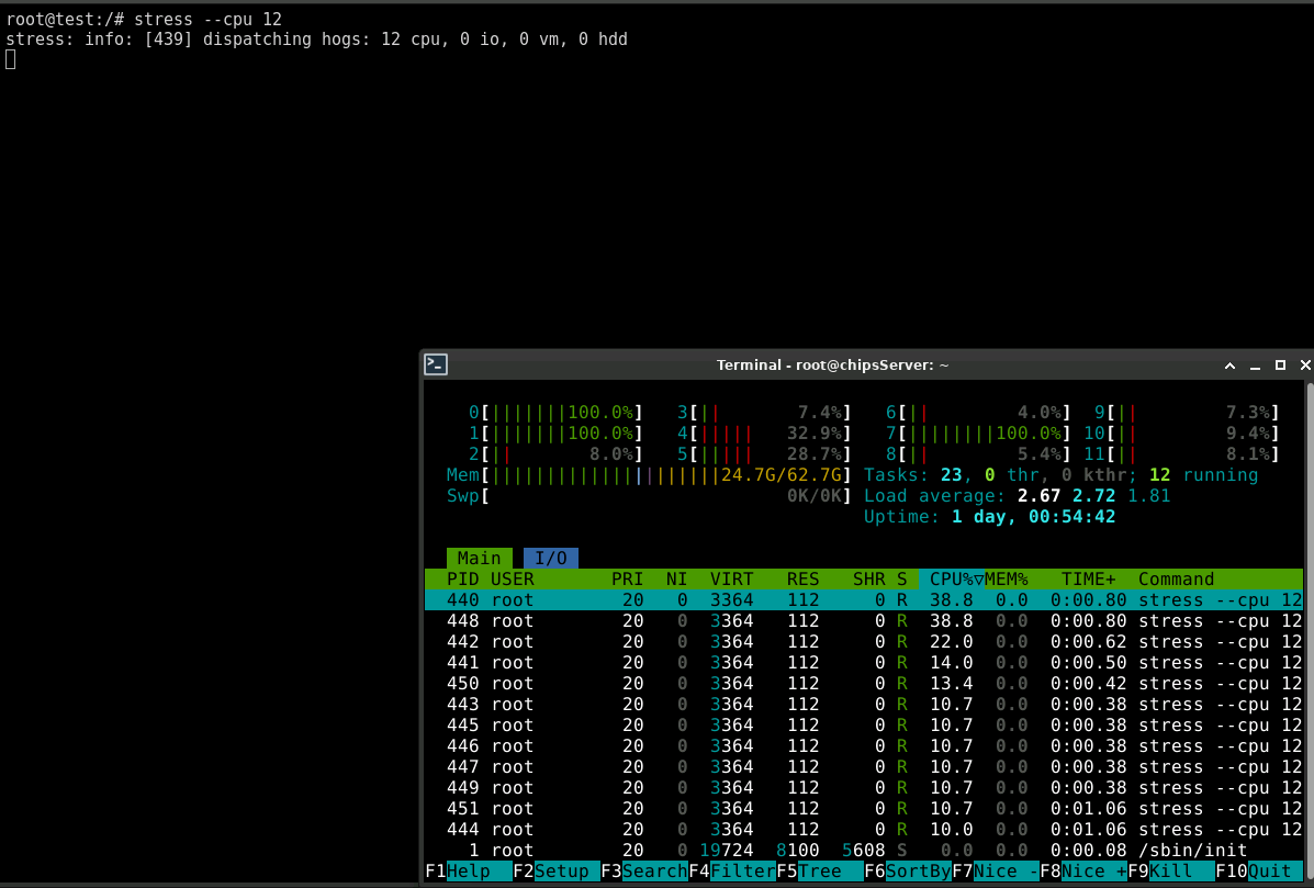

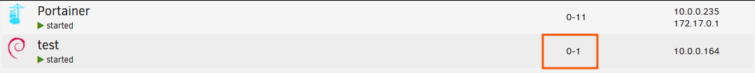

Hello
Just wondering if I have missed anything obvious here... I'm on 6.12.3 and fresh install of the LXC plugin. When I use the following config, the memory and CPU within the LXC container doesn't get applied. For example when I run htop, I can still see the full specification of the host.
# Spec config
lxc.cgroup2.cpuset.cpus = 0-1
lxc.cgroup2.memory.max = 2G
Thanks for any advice in advance
They do get applied but htop inside the container is still able to see all the system resources but will not be able to use them:
For example if you install something like stress and then stress the CPU, with more than two cores you will see that it only uses cores 0-1 on my system:
I hope you see that I got two terminal windows, the window in the background is from the container where I started a stress test with 12 cores and the htop terminal window is also from within the container where you can see that only the first two cores are used (please ignore core 7 since it's doing most certainly something else).
For RAM it is a bit more difficult to test but the limit is also applied.
Hope that helps and makes sense.
should have looked here before figuring that out for myself. I was baffled earlier today when i couldnt use the lxc container anymore to use the reverse proxy i set up on it to access my dockers to circumvent the host access requirement. i could have sworn that was working before.
Since i have to activate it now for it to work, i can scap the lxc plugin completely. thank you for the plugin, served me very well ❤️

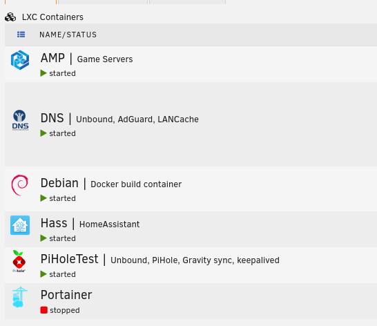

Go to your LXC storage path which you've defined in the LXC settings on your server, create a folder called "custom-icons" in there and put a .png file named exactly like the container is named in there.
Here is what it looks like on my server:
So to speak if the container is named DNS the file must be named DNS.png, if the container is named PiHoleTest the file must be PiHoleTest.png
I also would recommend that you choose a file which is square otherwise it will be stretched.

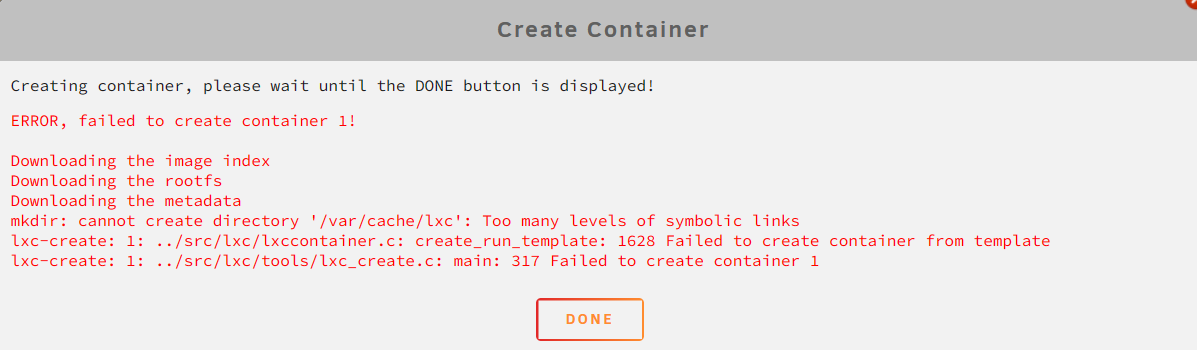

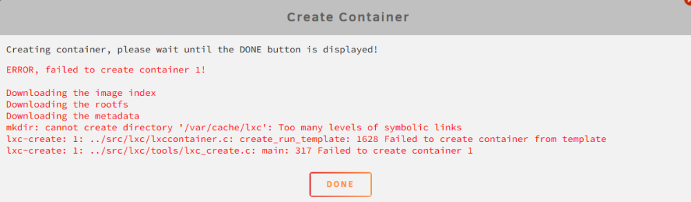

我正在就我在尝试创建容器时遇到的问题寻求您的帮助。
尝试创建容器时,我收到以下错误消息:
如果您对如何解决此问题有任何建议,建议或进一步说明,我将不胜感激。
非常感谢您的时间和关注。我期待你的回复。
