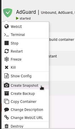

To create a Snapshot simply go to your LXC tab in Unraid, click on the Icon from the container that you want to snapshot and select Create Snapshot.
I don't know how it could be done more easily...?
Please note that this uses the built in snapshot function from LXC and not the ZFS Snapshot feature but I'm pretty sure it will create a proper snapshot <- I'm not entirely sure about that because I'm not a huge fan of ZFS, at least not more as for BTRFS, XFS and so on.

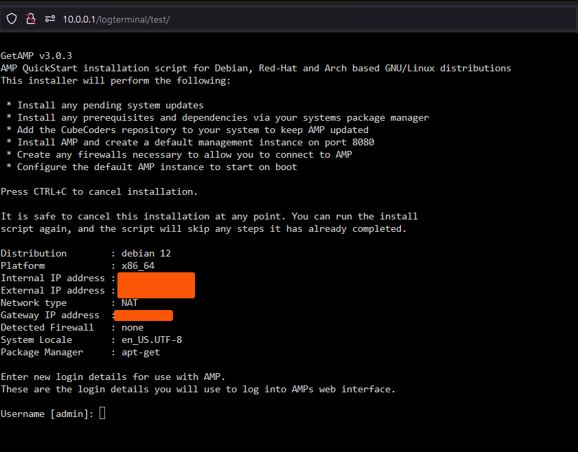

Yes but when you start the script from cubecuoders it will fail. It asks for port 80 and 443.
Sorry, I don't see that:
This is a fresh installed Debian Bookworm container with the script from Cube Coders to install AMP.
Can you maybe post a screenshot?

Please post a screenshot from that where it asks about port 80 or 8080 and from where it is not working.

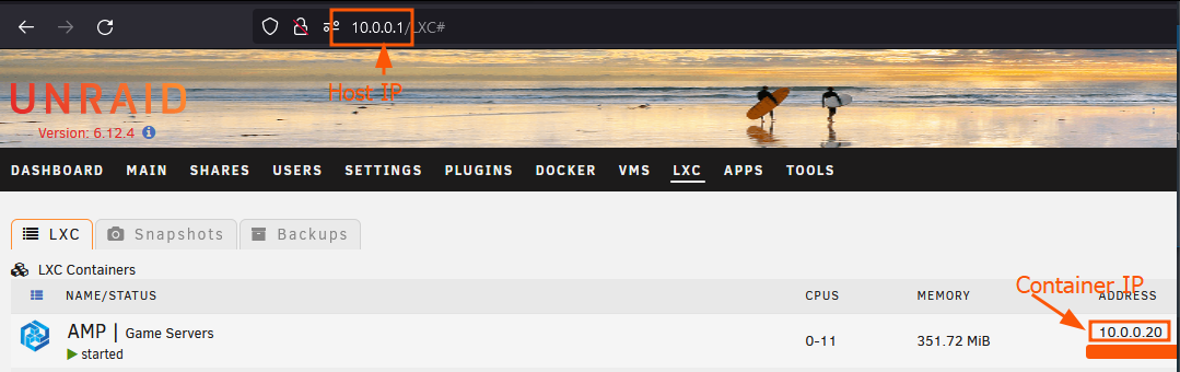

I'll explain that a bit more in detail:
You'll only need to port forward for Docker since only the forwarded ports are reachable but for LXC it is a completely different story, each container has it's own dedicated IP and it acts more as a VM not like a container and all ports assigned to that IP are reachable.
Again, you don't have to forward anything... Don't mix Docker and LXC... a LXC container acts more like a VM with it's own dedicated IP where Docker shares the IP with the host and you have to forward the ports form each container.

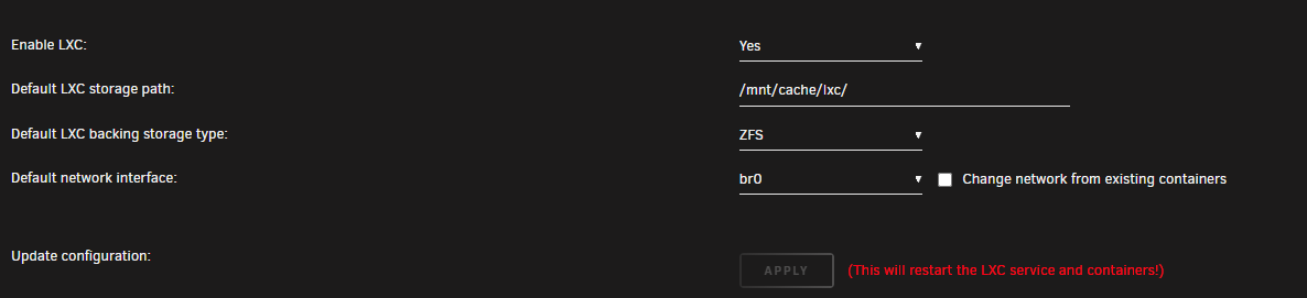

On 9/27/2023 at 11:38 AM, Roalkege said:
Would it be possible to create the lxc folder as a dataset on a ZFS cache?
The plugin now has (experimental) support for ZFS and BTRFS as backing storage types, default is: directory
All already set up containers will use directory.
To change the backing storage type to one of the two new ones go to the Settings page from LXC and select ZFS or BTRFS (the appropriate option will show up depending on which filesystem the default path is located).
When creating a LXC container the plugin will automatically create a dataset on the ZFS pool where the default lxc directory is located on, with the path: <ZFSPOOLNAME>/zfs_lxccontainers/<CONTAINERNAME>
The configuration will be still visible in the default lxc directory.
If you find any bugs please report them here. ;)

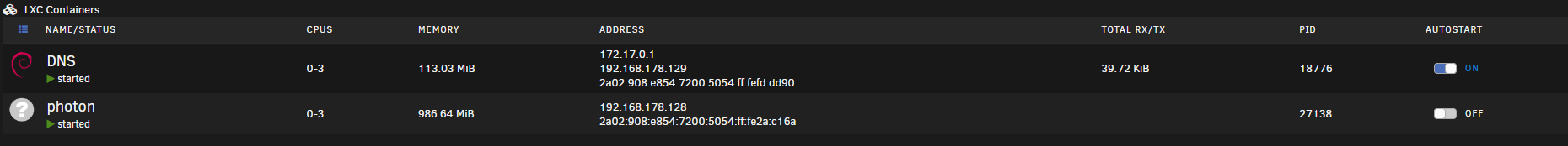

Hey, with the photon container, the debian logo has simply disappeared. Total RX/TX is also missing and when I activate Autostart for the container and then reload the page, Autostart=off.
Please post your Diagnostics.
Seems something is wrong with the container, did you maybe create a dataset over the container path or something similar?

I created a dataset with ZFS Master. Is this the problem?
Yes, I've wrote above the plugin will do that automatically. I'm assuming you are using the ZFS as a backing storage type correct?
Why did you do that in the first place? Please don't mess with the lxc directory itself.
Delete this one dataset that you've created for this specific container per hand and it should be back to normal (hopefully).
There is now only one container config available from what I see in your Diagnostics.
I stopped my photon container and now the container is gone. I also removed before that the snapshot. Is there any way to recover the container?
Because you overwrote the container with the dataset (at least that's what I assume).
In the Diagnostics from above I only see the DNS container and no second container, the visible container was just a leftover since the container was started but did do nothing anymore because as said, you've overwrote it with the dataset.

I can still see the dataset. ZFS Plugin shows 106GB used.
But the zfs_lxccontainers/photon is empty. And the lxc/photon has only a snaps folder and ends with an empty rootfs folder.
I think I have to delete the dataset? and setup a new container?

I havent created a dataset.
Your plugin created the zfs_lxccontainers dataset and then another dataset zfs_lxccontainers/photon and zfs_lxccontainers/dns with /mnt/cache/lxc/photon/rootfs and /mnt/cache/lxc/dns/rootfs. Created a snapshot with the ZFS Master from the photon container. After that the config was gone. Deleting the snapshot changed nothing.
Today I rebooted my system. Now the DNS container is also gone. I havent changed anything and I havent created a snapshot from this container.

1 minute ago, ich777 said:
The DNS container was created with a directory and not with ZFS correct?
This is my LXC config:
I created the DNS container with the ZFS option.
