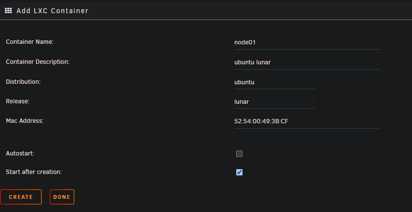

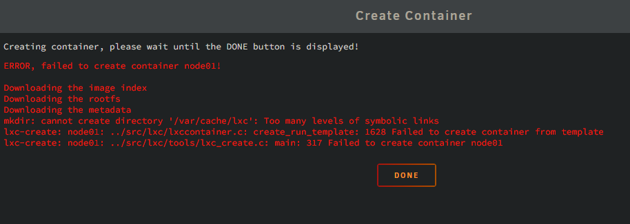

Sorry if this has been answered here before but I couldn't find anything similar when searching the forum.
I'm trying to setup my first container in LXC and get the following error when I try create container.
"mkdir: cannot create directory '/var/cache/lxc': Too many levels of symbolic links"
Any idea what I can do fix this?

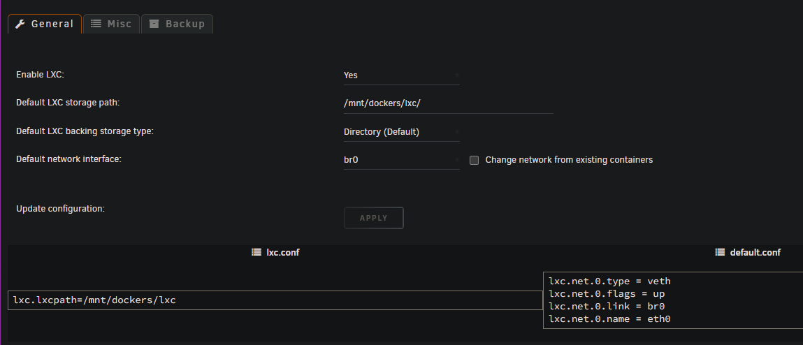

02 LXC settings

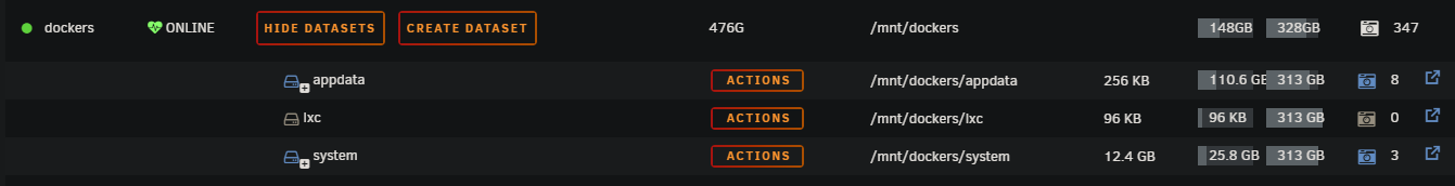

04 drive setup using ZFS if that has anything to do with it
05 settings I used to create container
I don‘t know why that happens on some systems, can‘t reproduce this, try the command from this post please:
(simply copy paste it)

Thanks for super fast reply. Seems like I didn't check the thread through enough. But that did it. The commands worked and I got my container running.
No worries, this issue pops up from time to time on new installations but I really don't know why...
As said I can't reproduce this over here... :/

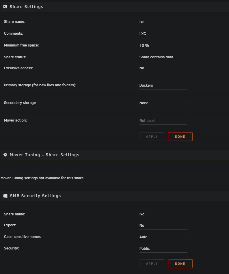

Did you maybe created the dataset for LXC after you started and configured everything in the plugin?
If so this is most likely the case why you got this error.
A restart of the LXC service would have solved that too. Please let me know if the dataset was created after you configured everything.

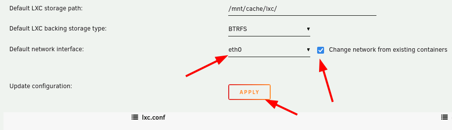

02 LXC settings
Please note that you can also use ZFS here as backing storage type, this will create a dedicated dataset where the containers/snapshots are stored.
The dataset got created automatically when I created the share. At first I tried to to use ZFS as save method but I looked at some of the previous posts where users had created snapshot with ZFS master plugin and that had damaged their containers. So I switched to "directory" instead. But I did try create it with ZFS enabled at first.
I'm using spaceinvader one's script to turn directories to datasets. Descripted in this video.
I'm also using his script to sync the dataset to array.
This is using Sanoid. So I figured better not to mix another different kind ZFS snapshoting in there and instead do normal backup (directories) and do snapshoting using the setup I use for my appdata for instance.
Only bad side is I get single snapshot which contains all my LXC containers. So if I have many in the future and want to roll back. I roll back everything. Unless I use the snapshots which come with LXC plugin.
Edited by Nevis

So to speak the dataset was there before you configured the plugin correct? If not and the dataset was created after the plugin created the folder this is the culprit.
Yeah tell me about it. I pretty much wanted ZFS for the snapshot capabilities since I got tired of home assistant and nextcloud breaking themselves between updates and sometimes feels like I don't change anything and those still end up committing seppuku out of pure spite. Then again I had my own adventure with ZFS when I almost nuked my appdata. Documented that here. Luckily @JorgeB helped me out with it and pointed me to right direction.
But to be more precise. The original dataset dockers/lxc appeared when I made the share on my ZFS drive. But when I first tried to create LXC container I had ZFS option on. That created separate dataset dockers/zfs_lxccontainers/node01 and still gave me the same error I mentioned in previous posts. Then I destroyed dockers/zfs_lxccontainers/node01 datasets, changed LXC save settings to directory and tried again. Still got same error. At that point I started to go through the support thread and check if someone else had come by same message.

However from my testing it is safe to use ZFS as the storage backing type, I use it on a daily basis <- LXC also supports BTRFS and it as a backing storage type which also works with snapshots and send/receive.
For ZFS I have to use a secondary dataset because ultimately it could mess up other containers if I put it directly into your main LXC path.

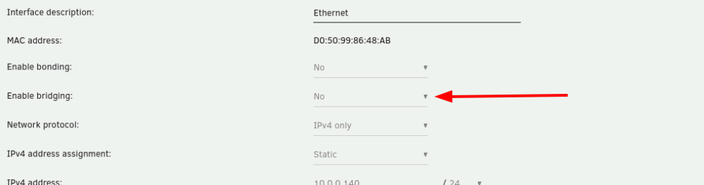

Anyone is having problems using macvlan in lxc over linux bridges?
In unraid mixing docker macvlan with linux bridges causes "call traces" will the same happen with lxc?
I know there is a workaround but I'm still interested in using bridges and not just phisical nic + macvlan
https://docs.unraid.net/unraid-os/release-notes/6.12.4/
Edited by L0rdRaiden
That is a general Linux issue, you can't use a bridge with macvlan and not related to Unraid.
Please explain that a bit more in detail what you want to achieve....
There is no issue using LXC with a macvlan bridge as long as you disable the bridge in the network settings from Unraid:
After that go to the LXC Settings page, change the default network interface ether to eth0 or vhost0 (I would recommend that you use eth0) and if you have already containers that use the default veth setting click the little checkbox next to the network interface (this will change the network configuration from existing containers to macvlan):
So to speak, this will change the default configuration from:
to:
(and of course if you've checked the checkbox next to the network interface all networks from existing containers).

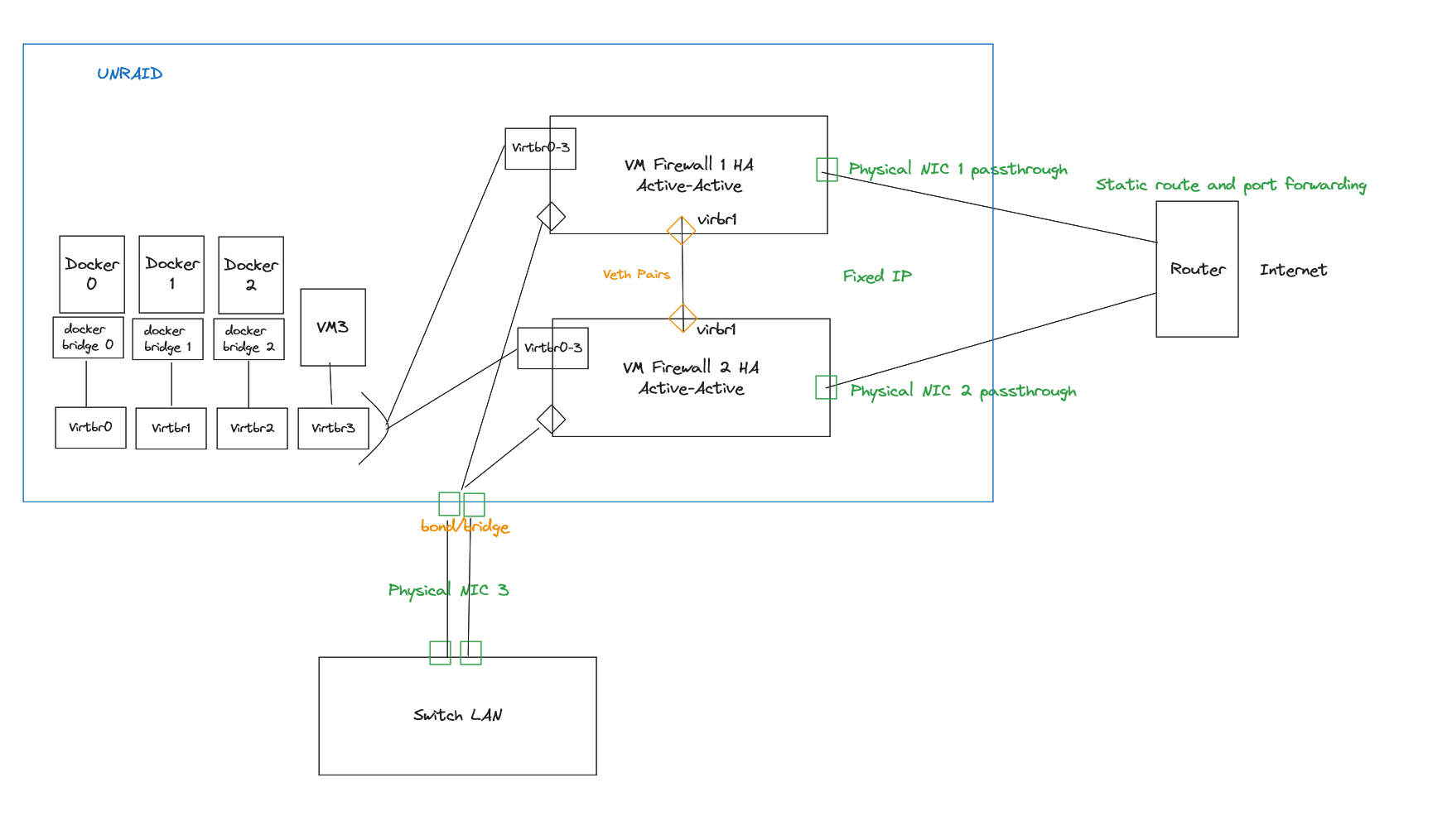

Why do you recommend to use eth0 instead of vhost0?
I'm planning to build this, the only change is that the docker0,1,2 will actually be lxc containers with docker inside.
Each lxc would have 2 interfaces assigned, one for administration of the lxc OS and another one for docker.
Ideally I would like to use macvlan in docker in order to have different IP's per container, but not sure yet how this will play over LXC. Maybe doing a bypass of the virtual nics inside lxc with facilitate everything.
Or maybe instead using different bridges to split the traffic I could creat vlans in eth0/vhost0 and assign 2 of the to each lxc and use macvlan on top of that for lxc and the docker inside lxc
I don't have yet a clear picture of the approach so unless I get some help I guess I will get it via the trial and error approach xD
I might find other problems with the storage at some point
https://github.com/nextcloud/all-in-one/discussions/1490
Because vhost0 is exclusively used for VMs and will only show you the traffic on the LXC page from the VMs which is strictly speaking wrong. If you use eth0 you'll see the whole traffic from the interface and I would also rather recommend attaching the macvlan interface to the physical NIC than to another virtual interface.
This is possible, set it up as usual.
TBH if this is a home setup to me this seems like a pretty complicated solution and I'm also not a big fan of virtualizing a Firewall but that's up to you.
I really can't help with like you want to set up because there are too many variables that I can't know but in general it should be possible.
You can see all different options for how you can configure each individual container here: Click
(just scroll down where it says Network to get all the available options)
As long if you don't mix a bridged interface with macvlan bridge you should be good to go.
