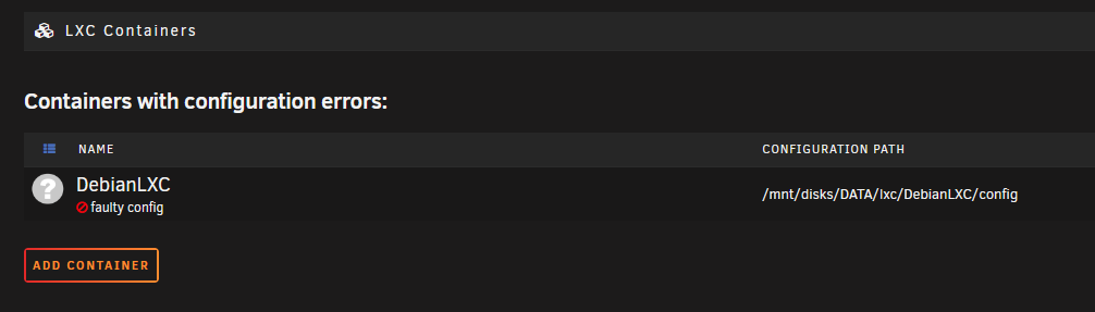

Getting an error after editing config to allow nesting
# Template used to create this container: /usr/share/lxc/templates/lxc-download
# Parameters passed to the template: --dist debian --release bullseye --arch amd64
# Template script checksum (SHA-1): 78b012f582aaa2d12f0c70cc47e910e9ad9be619
# For additional config options, please look at lxc.container.conf(5)
# Uncomment the following line to support nesting containers:
lxc.include = /usr/share/lxc/config/nesting.conf
# (Be aware this has security implications)
# Distribution configuration
lxc.include = /usr/share/lxc/config/common.conf
lxc.arch = linux64
# Container specific configuration
lxc.rootfs.path = dir:/mnt/disks/DATA/lxc/DebianLXC/rootfs
lxc.uts.name = DebianLXC
# Network configuration
lxc.net.0.type = veth
lxc.net.0.flags = up
lxc.net.0.link = br0
lxc.net.0.name = eth0
lxc.net.0.hwaddr=52:54:00:99:D2:F0
lxc.start.auto=0
Reason for allowing nesting, trying to install snap/LXD in debian but keep getting -
error: system does not fully support snapd: cannot mount squashfs image using "squashfs": mount:
Read somehwere I need to enable nesting and allow FUSE. Not sure what all this means to be honest. Any ideas?
Edited by mikeyosm
Nesting is usually not necessary in privileged containers especially when you are just trying to install snap.
I will look into that but I think that you not drop certain caps.
Do I get that right that you want to install LXD in LXC? May I ask why?

15 hours ago, mikeyosm said:
Yeah, I am playing with a VDI broker called Ravada. My plan was to set up a Deb/Ub LXC/LXD, install Ravada, create a Windows VM and set up a VDI pool.

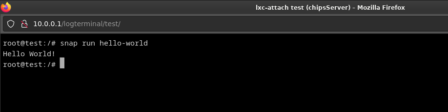

Add this to your config:
lxc.mount.auto=cgroup:rw
lxc.mount.entry = /dev/fuse dev/fuse none bind,create=file,optional
In the container install these packages:
snapd squashfuse fuse
After that you should be able to install/run snaps:

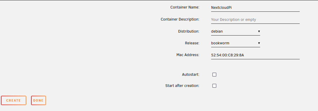

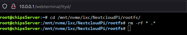

I would recommend doing that:
  1. Create a LXC container with the name NextlcoudPi and don' start it
  2. Go to the rootfs directory from the created container and remove everything
  3. Extract the tar archive directly into the rootfs (I've download it directly to /root - please note that you have to be in the directory where you want to extract the files in the following example)

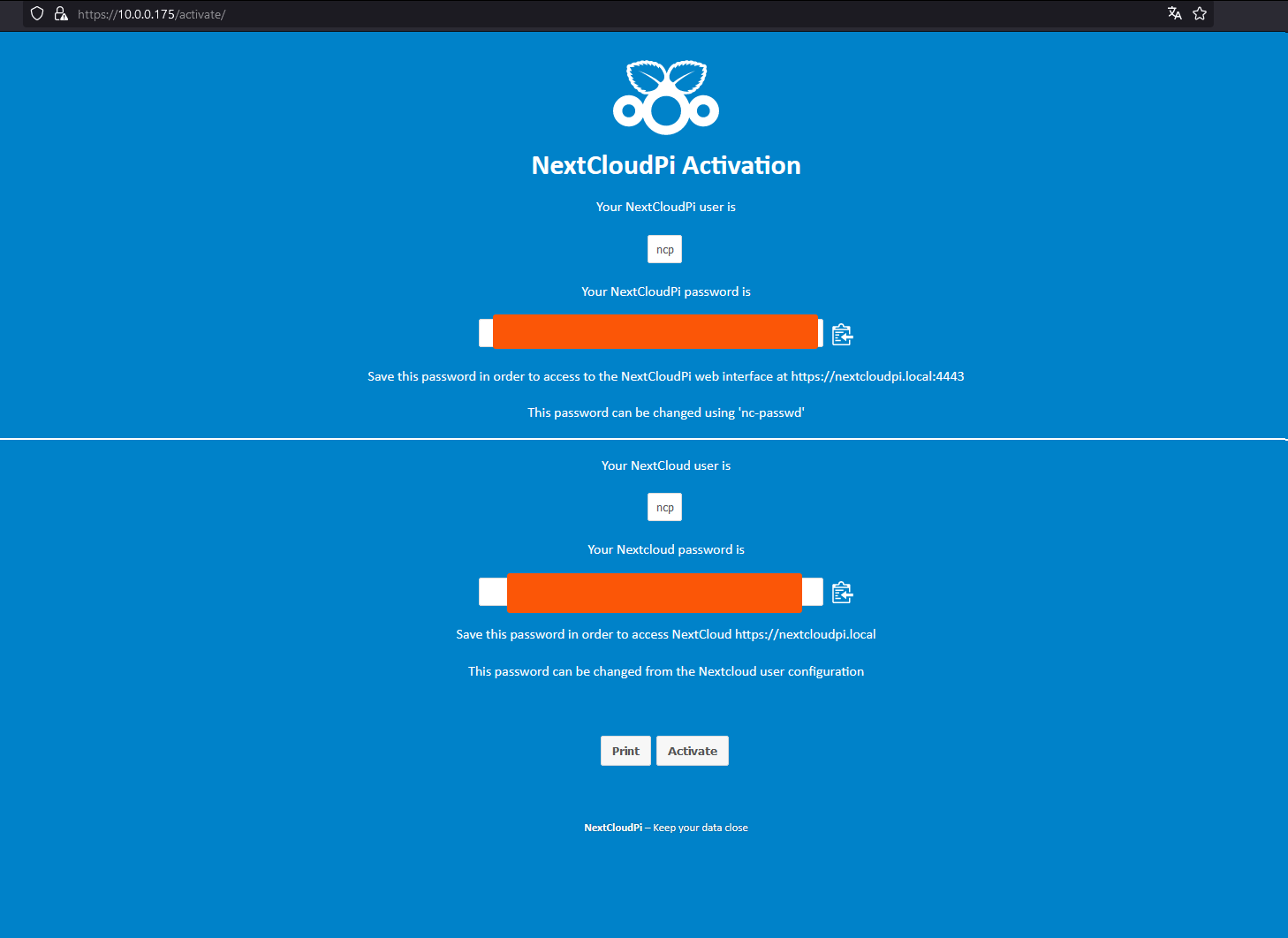

  4. Start the container
  5. Connect with the IP address from the LXC container through your browser to NextcloudPi (ignore the errors about self signed certificates)
In my opinion you would be better off using Docker or even installing it yourself in LXC but that is just my opinion. ;)
I tried your suggestion and that works well.  Overwriting the rootfs is enough to get this debian based nextcloudpi lxc container working. Thanks for the advice and trying it for me.
