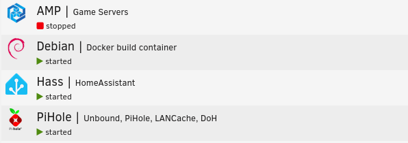

What do you think is more sensible: setting up an LXC for each app, or creating a Docker container?
That depends on you and how you like to configure things.
For me for example I have about 40 always on Docker containers and 3 always on LXC container.
For example I like to have my whole DNS Stack (PiHole, Unbound, keepalived, DoH Server and LANCache) in one single container and that the routing is done internally in the container and the most important thing is that I don't have to change any ports on Unraid since a LXC container has always it's own dedicated IP.
I also like to have my HomeAssistant instance running in a LXC container to have more granular control over it because I was really unsatisfied with the Docker container and it broke multiple times after an update.
There are also other things which are better (in my opinion) to set up in a LXC container like AMP, the main benefit is that a LXC container is more kind of a VM than a Docker container and it is easy to set up Docker in it.
Here is it what it looks like on my Server:
You can also try the AMP, Hass or PiHole container, I already have premade container archives for that which you can find here:
