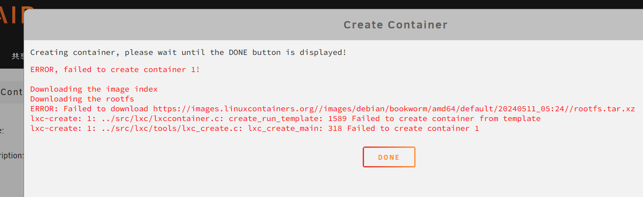

I encountered the following error while creating the container. I noticed that there are two "/" characters in some parts of the download link for "rootfs. tar. xz". Is the error related to this?
How do I solve it?
root@Tower:/mnt/cache# lxc-create --name Debian_bullseye --template download -- --dist debian --release bullseye --arch amd64
Downloading the image index
Downloading the rootfs
ERROR: Failed to download https://images.linuxcontainers.org//images/debian/bullseye/amd64/default/20240511_05:24//rootfs.tar.xz
lxc-create: Debian_bullseye: ../src/lxc/lxccontainer.c: create_run_template: 1589 Failed to create container from template
lxc-create: Debian_bullseye: ../src/lxc/tools/lxc_create.c: lxc_create_main: 318 Failed to create container Debian_bullseye

The same error message applies when installing using GUI
My current solution is to download the file from the link above using a browser, upload it to the "/mnt/cache/lxc/debian/rootfs" folder, unpack it, and then place the config file in the "/mnt/cache/lxc/debian/" folder. Then, I can run it in the LXC plugin

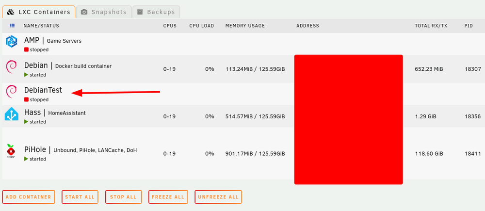

55 minutes ago, ich777 said:

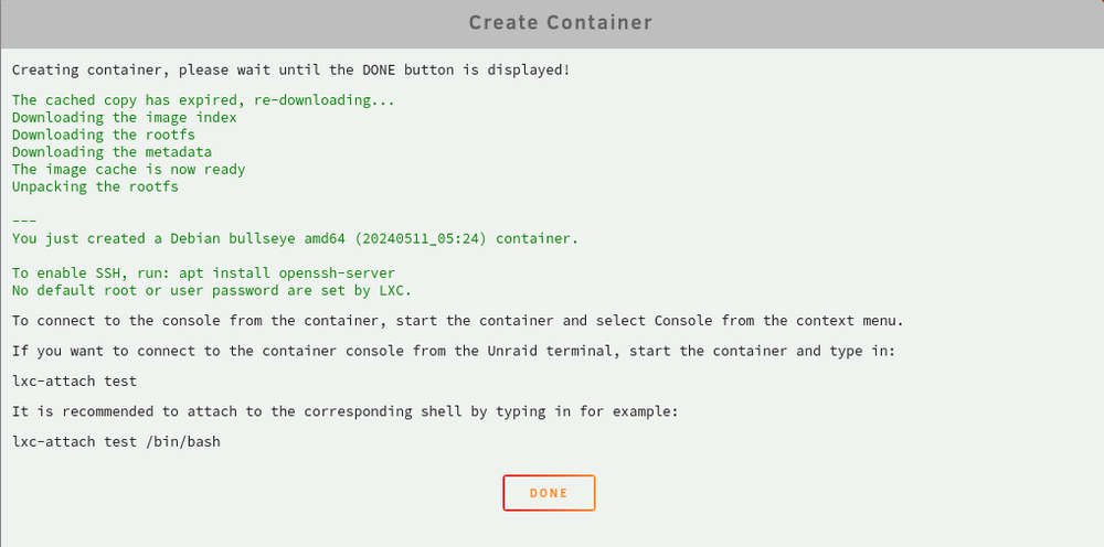

did you see drop downs on the add container page like in this screenshot:
Yes.

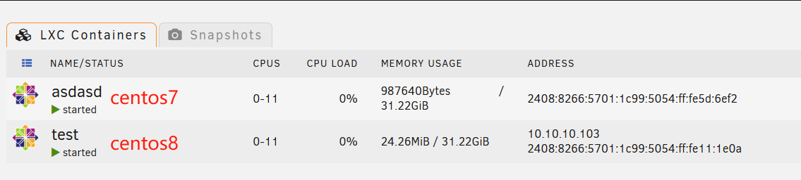

Hello, plugin author. May I ask why CentOS 7 cannot retrieve the IPv4 address while CentOS 8 can? I need CentOS 7 to use certain applications.1717838745331.thumb.jpg.b855a6bdd204fddef826e347d57e21b5.jpg
22 minutes ago, wy586 said:
Thank you for your prompt response. I have already uploaded it.
Hmmm, I also now just tried it and it is a bit more complicated that I thought.
On my machine Centos7 also doesn't start properly and it fails starting, sure you can connect to the terminal but the container is not started properly and that's the main issue.
I already found a few similar issues but I have to take a deeper look into why it's failing to start.
For now please run Centos7 in a VM if possible, I will definitely look into that but you have to give me a few days.
EDIT: Oh I found the answer:
You cannot boot centos7 on a cgroup2 system.
Source: https://discuss.linuxcontainers.org/t/debian-11-do-not-start-lxc-containers/12581/3 (this is from one of the main developers from LXC)
Since Unraid is a cgroup2 system you can't run it, however you barely wont be able to run it on another system because almost everything nowadays is using cgroup2
Sure you could switch Unraid to cgroup v1 but then the newer containers won't work and you also have to rebuild all your Docker containers because switching cgroups would require that because cgroup2 is not backward compatible.
Maybe you could run a Centos7 based Docker container and run these "older" services that you are trying to run in there?
Sorry for not having better news for you.
Thank you very much for your response. Thank you for your work on The LXC plugin, The LXC plugin is excellent.

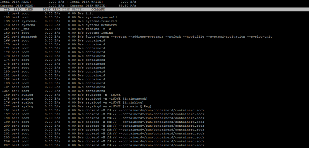

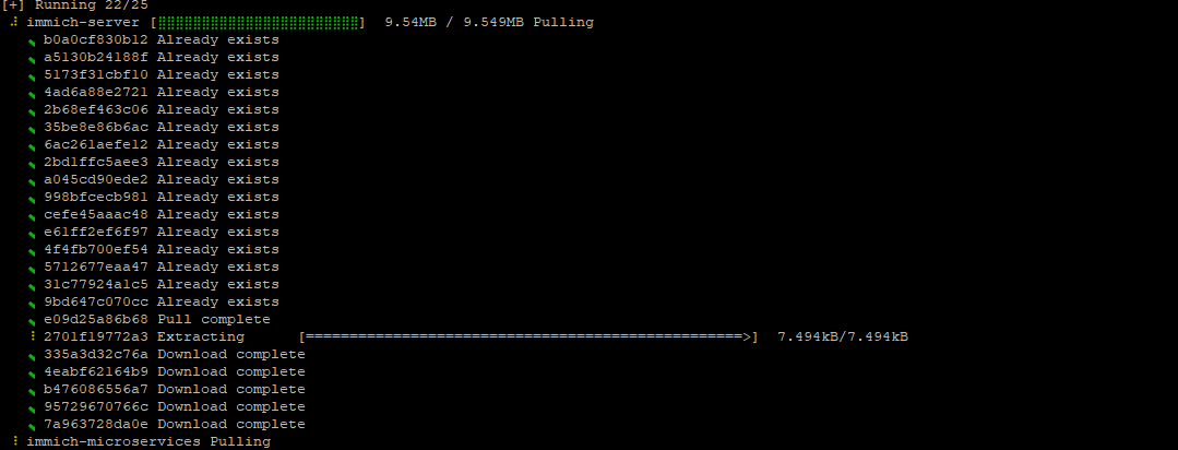

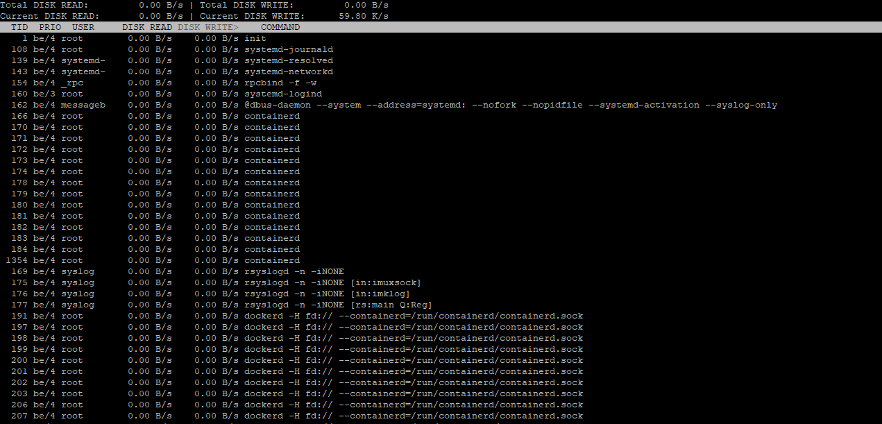

Hi there,
I have a problem with docker inside LXC containers - all extractions are very slow and it takes about 30 minutes to run docker container for the first time when it installs all dependencies.  I didnt have this problem on regular VM using the same disk for system.
Edited by stefan44
