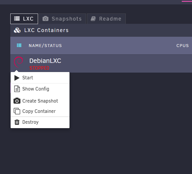

After the installation, click Start and there is no response. It still cannot be restarted several times. It can only be started by restarting the raid
Can you please be a bit more specific?
Where do you click start? Can you maybe post screenshots from what isn't working exactly?
On what Unraid version are you? Can you maybe post your Diagnostics?
Have you read the first page on how to use LXC? Have you seen that you have to enable cgroup2 on Unraid for some distributions?

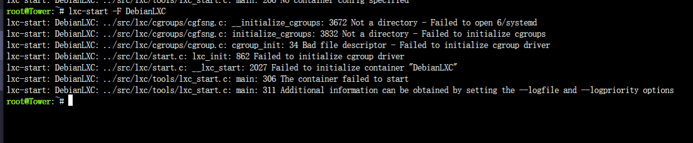

My version is 6.11.5,I'm afraid I really didn't notice that cgroup 2 must be enabled for some distributions on Unraid
Please enable it and see if it helps. If not, let me know and I will look into that.
I've now tried a fresh install on a second machine and it just works fine OOB even with cgroup v1.
Can you post your Diagnostics please, I think something is messing with the cgroup on your System...

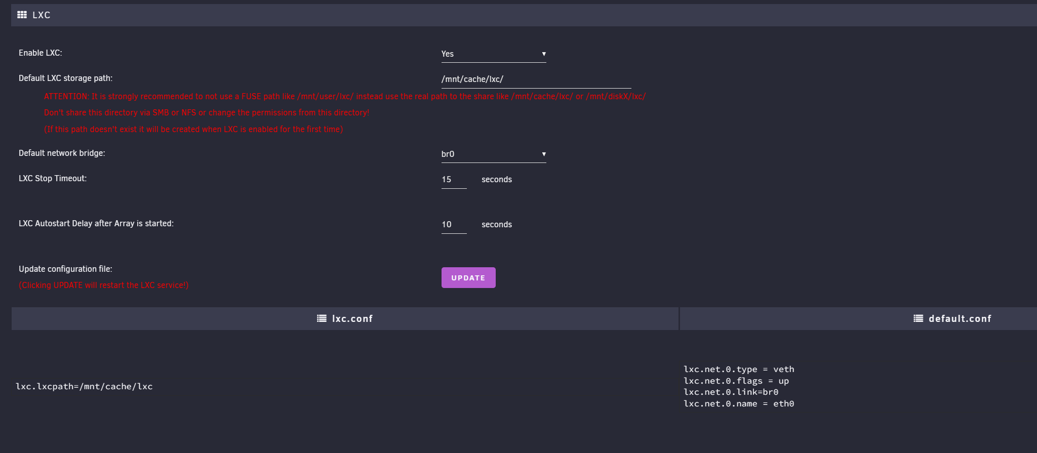

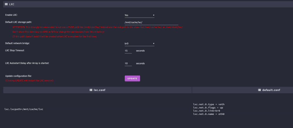

Can you please post a screenshot from your settings?
Where is your LXC directory located? Please double check that your LXC directory is not on a share which is moved by the Mover.

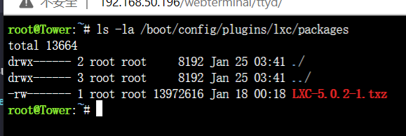

Can you please open up a Unraid terminal and post the output from:
ls -la /boot/config/plugins/lxc/packages
I've never seen such an issue before, have you any custom scripts in place which are actually messing with the cgroup?

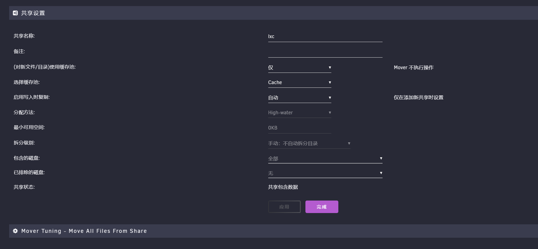

The share lxc on your system is set to Only use cache correct?
2小时前,ich777 说:

系统上的共享 lxc 设置为仅使用缓存正确吗?

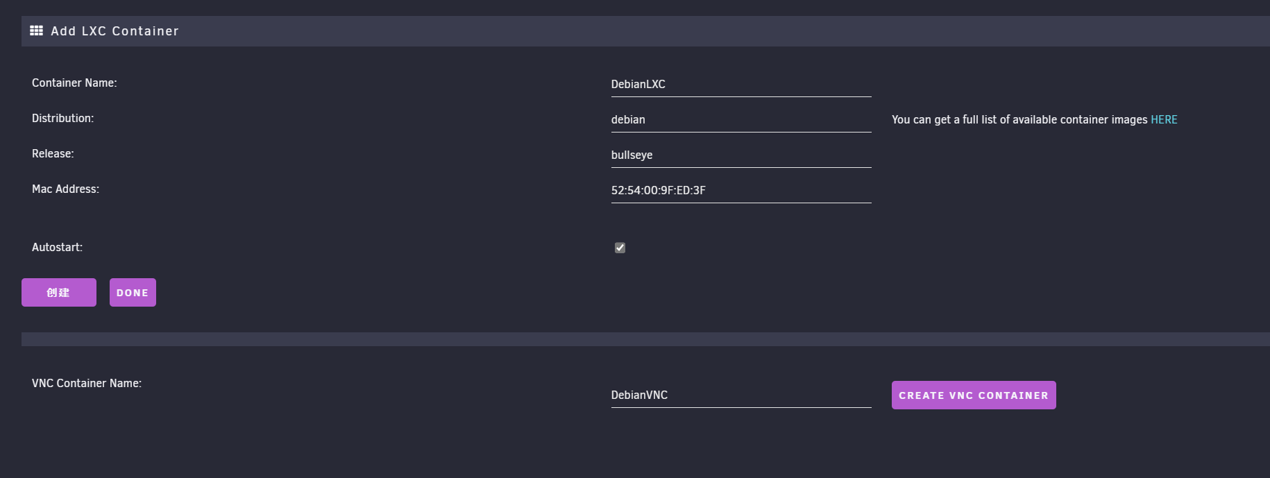

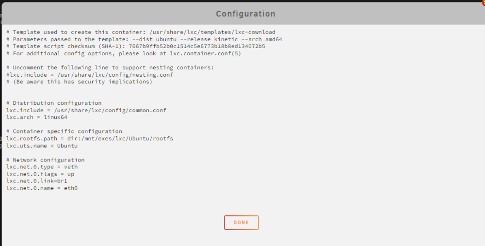

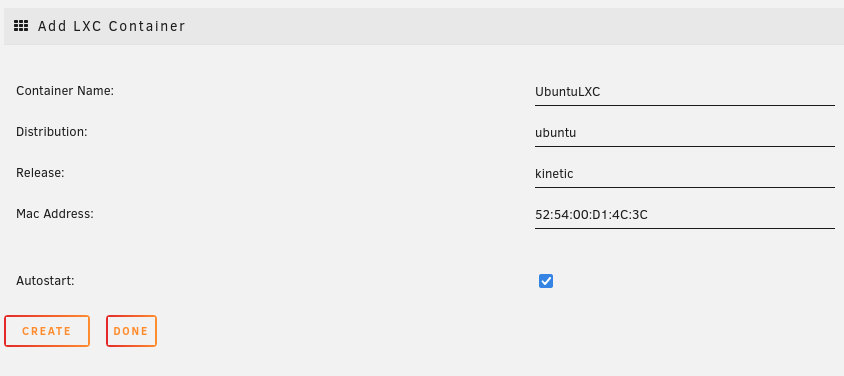

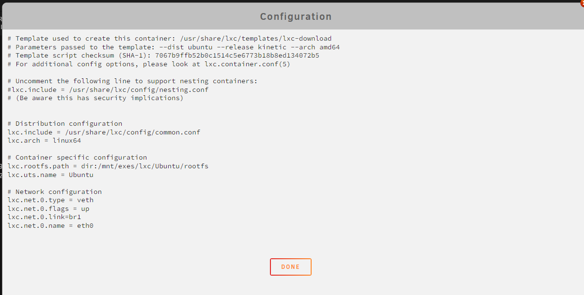

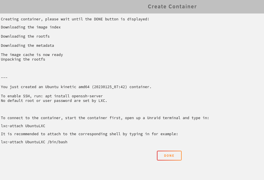

Every time I create a container with Ubuntu (have tried anything else besides the default Debian one), it always creates a Debian container. I am able to do it via the command line. I've tried different releases with no luck.
Edit: it won't start though

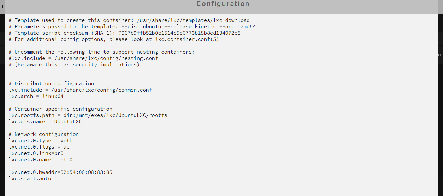

Config:
Edited by Exes
I don‘t understand. How do you check that it always creates a Debian one?
Have you read the first post that you have to enable cgroup v2 on Unraid to be able to run newer containers which use systemd?

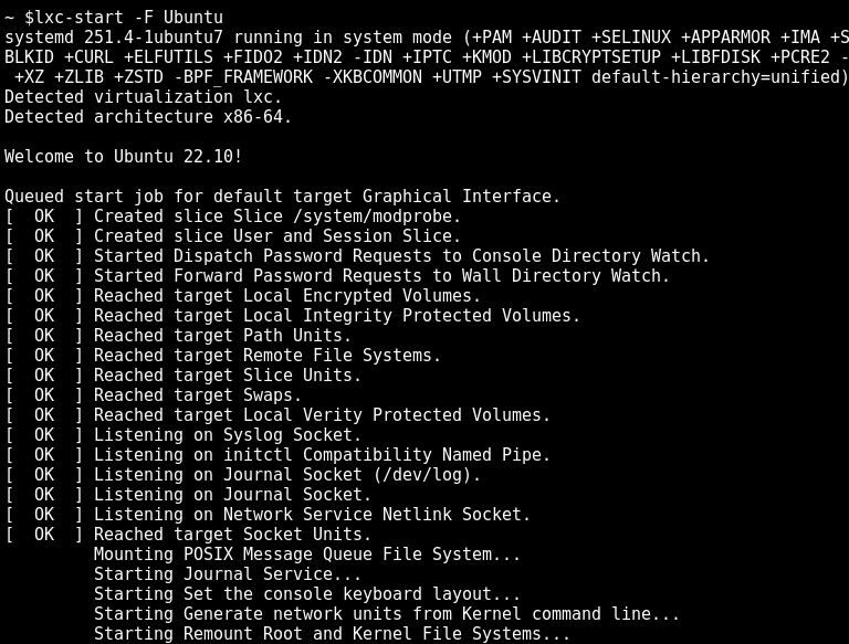

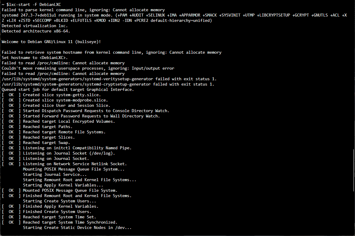

EDIT: I've tried it now on my system with cgroup v1 (I'm not really a Ubuntu person so I have to try it on my own):

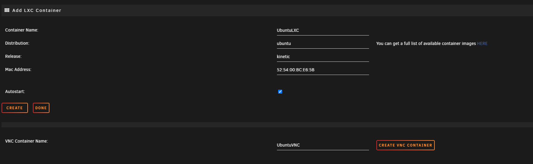

Create the LXC Container:
This is the screen where it pulled the image:
After I go back to the LXC tab:
This is the configuration:

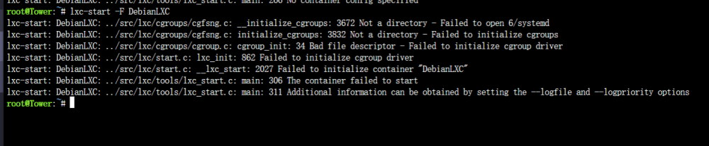

And after that I tried to start the container from the Unraid terminal and got this:
Well it was not starting on cgroup v1 after I switched to cgroup v2 it looked completely different:
So it seems you are using cgroup v1 on your system but I still don't know what you mean that it fails to create a Ubuntu LXC container...?
BTW cgroup v2 will be the default on Unraid 6.12.0

BTW, I've gone through the new Diagnostics that you've sent, you still haven't enabled cgroup v2 there on your Unraid installation.
Can you maybe post a screenshot where you've enabled cgroup v2?
In the logs it always says DebianLXC and has the Debian logo

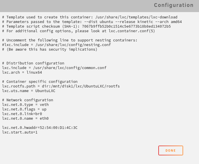

I added the cgroup2 to my syslinux and it actually created it this time but the container still won't start
Here is my config
Please post your Diagnostics.
