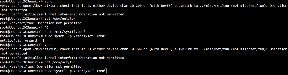

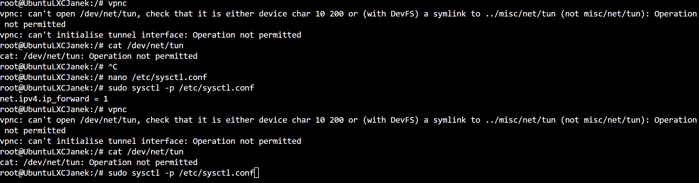

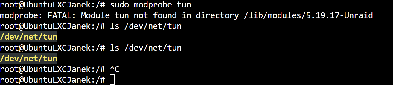

Hello, I would like to set up a VPN connection with a Fritzbox (IPSec) in an LXC with Ubuntu and encounter this error message, does anyone have an idea why I have no rights to add the network as root?
apparently it is because the TUN drivers are not installed, see screenshot
Edited by Lucas Mietke
I have never done this but I can look into it next week.
From a quick Google search I found this.
At least from my understanding, you have to add this to the config from the LXC container:
lxc.cgroup2.devices.allow = c 10:200 rwm
lxc.mount.entry = /dev/net dev/net none bind,create=dir
thanks that works fine

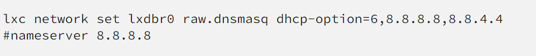

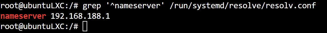

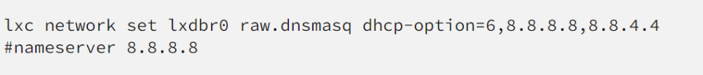

Hello
I would like to set my DNS in the LXC container, now I've tried one or two commands but unfortunately I can't change the DNS.
Do you have an idea?
I‘m not an Ubuntu expert (because I still don‘t like it :D ) and I can only link to here.
I can only tell you that it is just working fine in my Debian containers.
This is purely a distribution thing and has nothing to do with LXC.
okay thanks.

15 hours ago, Lucas Mietke said:
so I now know that it cannot be changed in the LXC, I looked for and found the solution for Ubuntu
Yes and no, it could be but I would rather recommend that you configure that in the container or in your DHCP server since this is more like a VM and not a Docker container.
For instance on my Debian Bullseye containers I use systemd networking to configure IPs, Gateway, DNS,...
