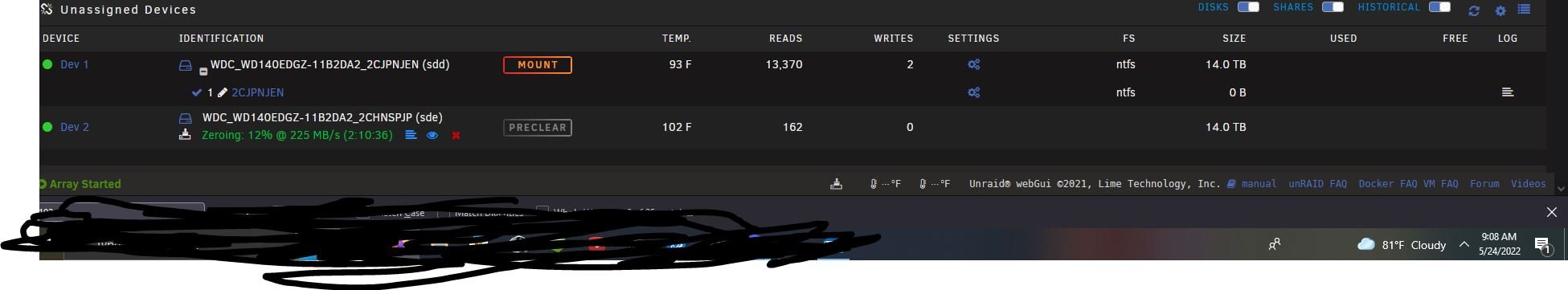

Trying to add 2 new bigger drives, array wont start back up
Trying to install 2x 14tb WB easystorage, they are being picked up i see them in unraid unassigned devices.  But only 1 of the 2 drives let me do a pre clear and once it finished, it wants me to again. I'll attach logs but is it better if i try to start array then grab logs? 1 Drive is to replace parity the other drive for more space. I've done with more times then i care to count and never had this issue. Again ill attach logs however is most benefiting for trouble shooting
unraiid.thumb.JPG.5a9790194677422bfb2ff13dd516d288.JPGunraiid.thumb.JPG.5a9790194677422bfb2ff13dd516d288.JPGunraiid.thumb.JPG.5a9790194677422bfb2ff13dd516d288.JPG

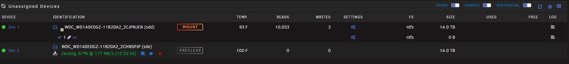

and now this morning it wants me to preclear all over...?? whats going on here
Screenshot just shows a disk still preclearing, if you're having issues with preclear you should post in the appropriate thread for the plugin you're using, preclearing a disk is optional.

i know its not required for new drives but recommended.. My point is 1 pre clear 1 of 2 drives. fine. add to parity and start array. get "array cant start up due to errors"
EDIT:1
the pic was from yesterday..  i now have to pre clear that same drive... again? Maybe ur right and i should seek help in plugin area... but then again if their new which they are.. and if i dont have to re clear.. why am i getting fail to start array when i add these 2 brand new drives to the pool? Think its more then the perclear plugin.. but  then again idk or i wouldnt be asking for help.
Edited by Gizo
add update pics
Again that screenshot only shows that a disk is clearing, nothing more, your description is also not very clear to me, but if what you're trying to do is to replace parity and at the same time add a new array device that's not allowed, you need to do one thing at a time, if it's not that then please post the diagnostics after you get the error you are seing.
