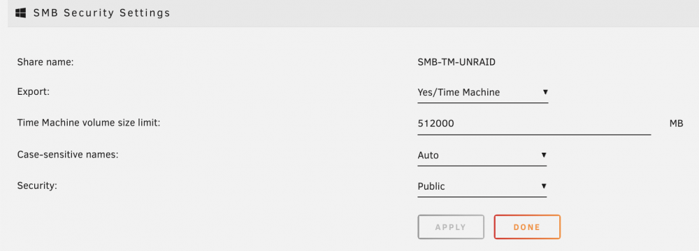

may i ask please - this provide any functionalty difference from the native wayn of makeing share for use in timemachine?
1235100225_ScreenShot2022-05-25at18_36_18.thumb.png.dd39361cf3231aaaef50ade72e110fd6.png
2 hours ago, rockrimmon said:
Hello,
I have multiple Mac systems that I would like to use this Docker for. Would I be correct if I wanted each Mac to have its own TimeMachine backup area would I add multiple paths like the following:
/mnt/user/timemachine/Mac1
/mnt/user/timemachine/Mac2
/mnt/user/timemachine//Mac3
Etc.
Any other changes I would need to make in the Docker install?
Thank.
In general, you should be able to back up multiple Macs to the same TimeMachine share without adding any further paths. If you desire to keep the backups somehow separate, I would suggest to set up a user for each Mac.
Alternatively, you could spawn mutiple instances of the Docker container. After installing the application, it should create a first docker container and the template should be accessible in the Docker-UI. You can then create further instances of the container through Docker->Add Container-> Selection of "TimeMachine" as a template. Each container can be mapped to the path on your Unraid-Host that you desire (e.g. /mnt/user/timemachine/Mac1, /mnt/user/timemachine/Mac2).
For configuration of multiple users, I would refer you to  https://github.com/mbentley/docker-timemachine#adding-multiple-users--shares.
Following the instructions you will find there, you should be able to set up multiple users that you could each set up for the different Macs.
I guess that you can adjust most of the settings through some trickery in Unraid as well. For any fixes or incompatibility issues however, you will be relying on Unraid/Limetech to update the corresponding components of their system.
And from what I read, it can be a hazzle to get TimeMachine up and running reliably as is.
Therefore I think there is a certain advantage of running TimeMachine as a Docker image. The docker image used (https://github.com/mbentley/docker-timemachine) is in active development and quick to fix issues. The focus of that project is clear - TimeMachine and nothing but TimeMachine.
I have been using this solution for a couple of months and it has been rock solid.

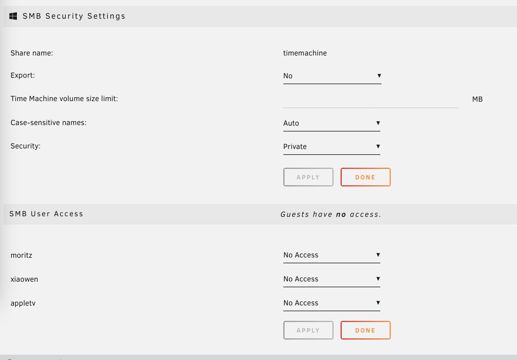

Is it advised to use the disk shares or users shares for this application?

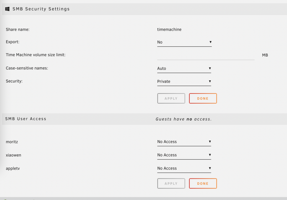

I guess it does not really matter but I am using user shares all over my Unraid and have my timemachine share hidden from all users. That kind of makes sense because you do not want anyone toying around with the data. I only want TimeMachine to access and read/write the data.
The screenshot illustrates how I set up my share.
If no users have access to the TM share how do you mount that share on the Mac in order to set Time Machine to use that destination?
Edit: maybe mounting the destination first to be able to select it for backups is no longer necessary with mDNS advertising?
Edited by wgstarks
It is not Unraid that provides the share to the TimeMachine clients, it is the Docker container. So you can hide the share in Unraid and the Docker Container (aka. the TimeMachine application discussed in this thread) will provide an appropriate share.
Got it. The unRAID share is only accessed from the docker.

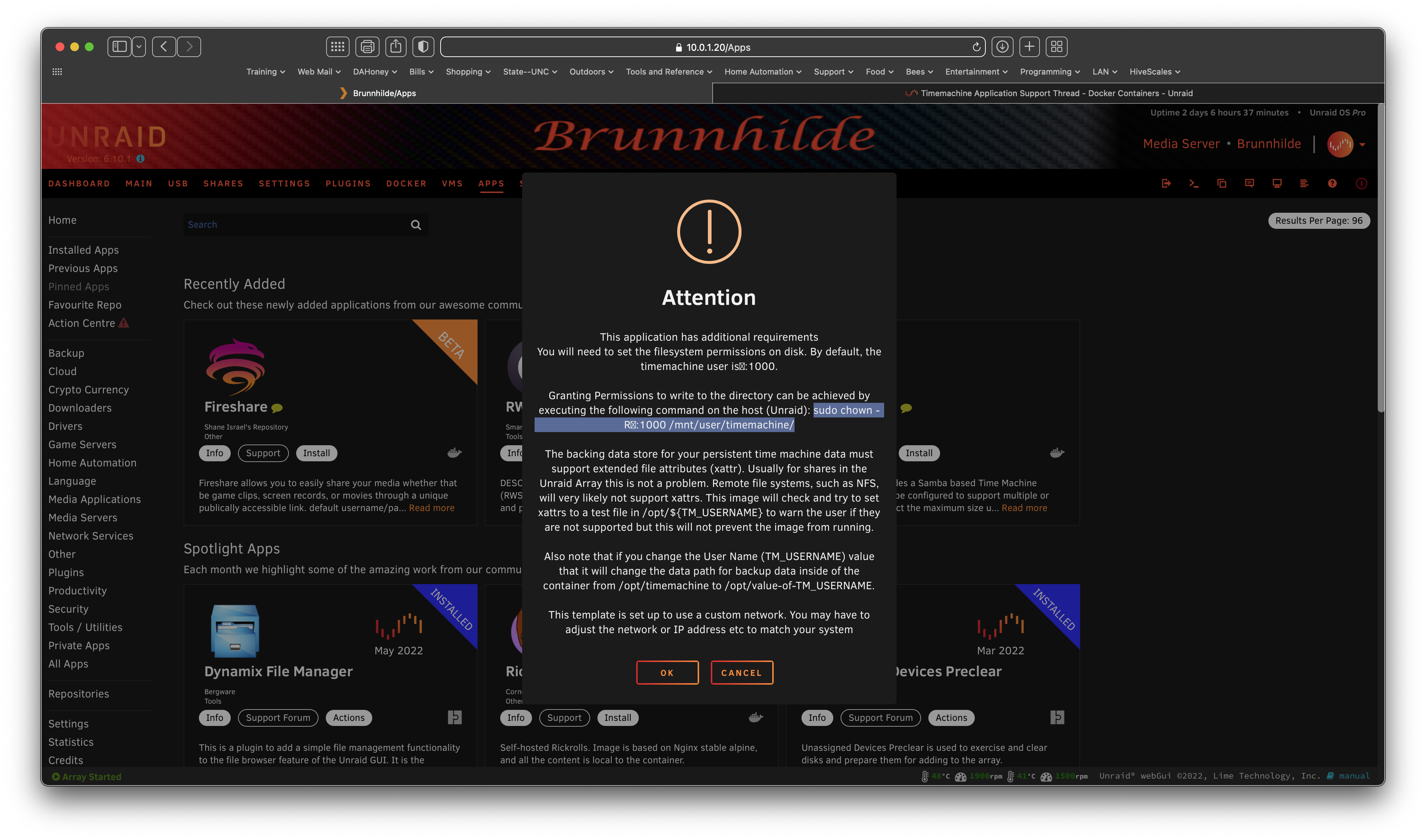

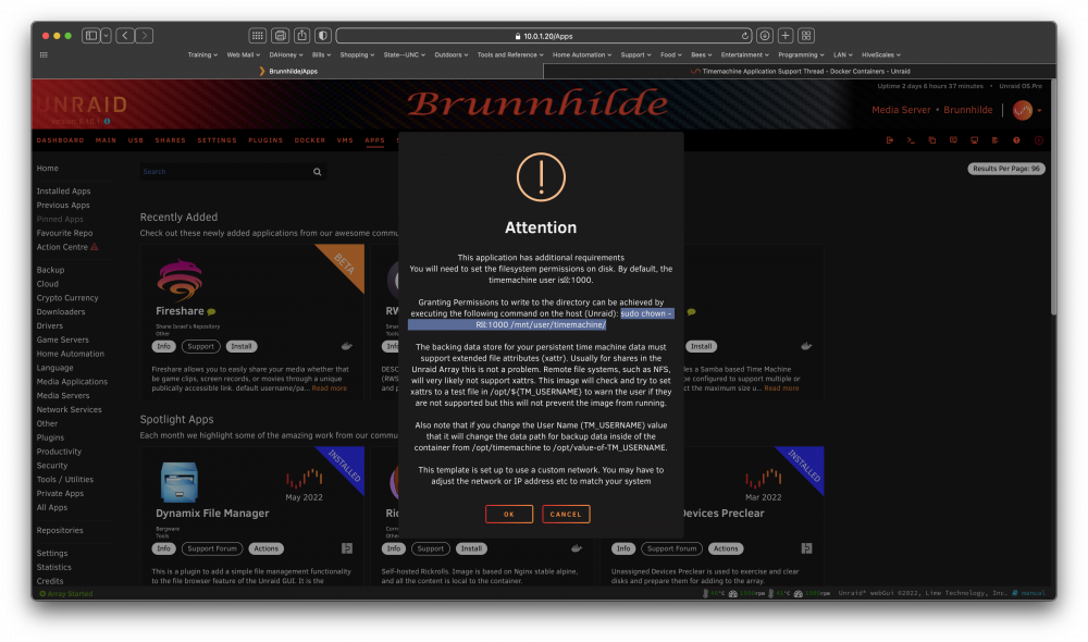

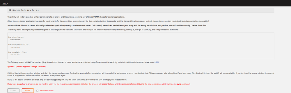

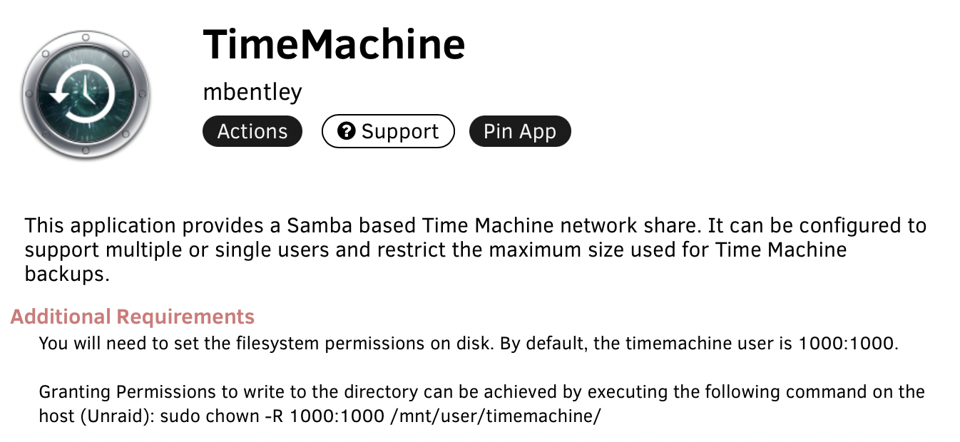

When attempting to install I see in the instructions that I need to run this command on the share-
sudo chown -R񎗨:1000 /mnt/user/timemachine/
I’m guessing that I need to replace /timemachine/ with the actual share I have configured?
What is the symbol after -R?
hmm - where did you take that from? In the app description, the text is displayed correctly for me (see screenshot). And yes - you will need to replace /mnt/user/timemachine/ with the actual share (or path) that you mapped to the Time Machine Container.
Edited by moritzf
It's the popup window when you click install.
1303450914_ScreenShot2022-05-26at12_51_03PM.thumb.png.4753c409ef5bf9ddb8801894f0b3cc31.png
Might not be a bad idea to put that info in the original post and/or GitHub. Some users might read it.😁

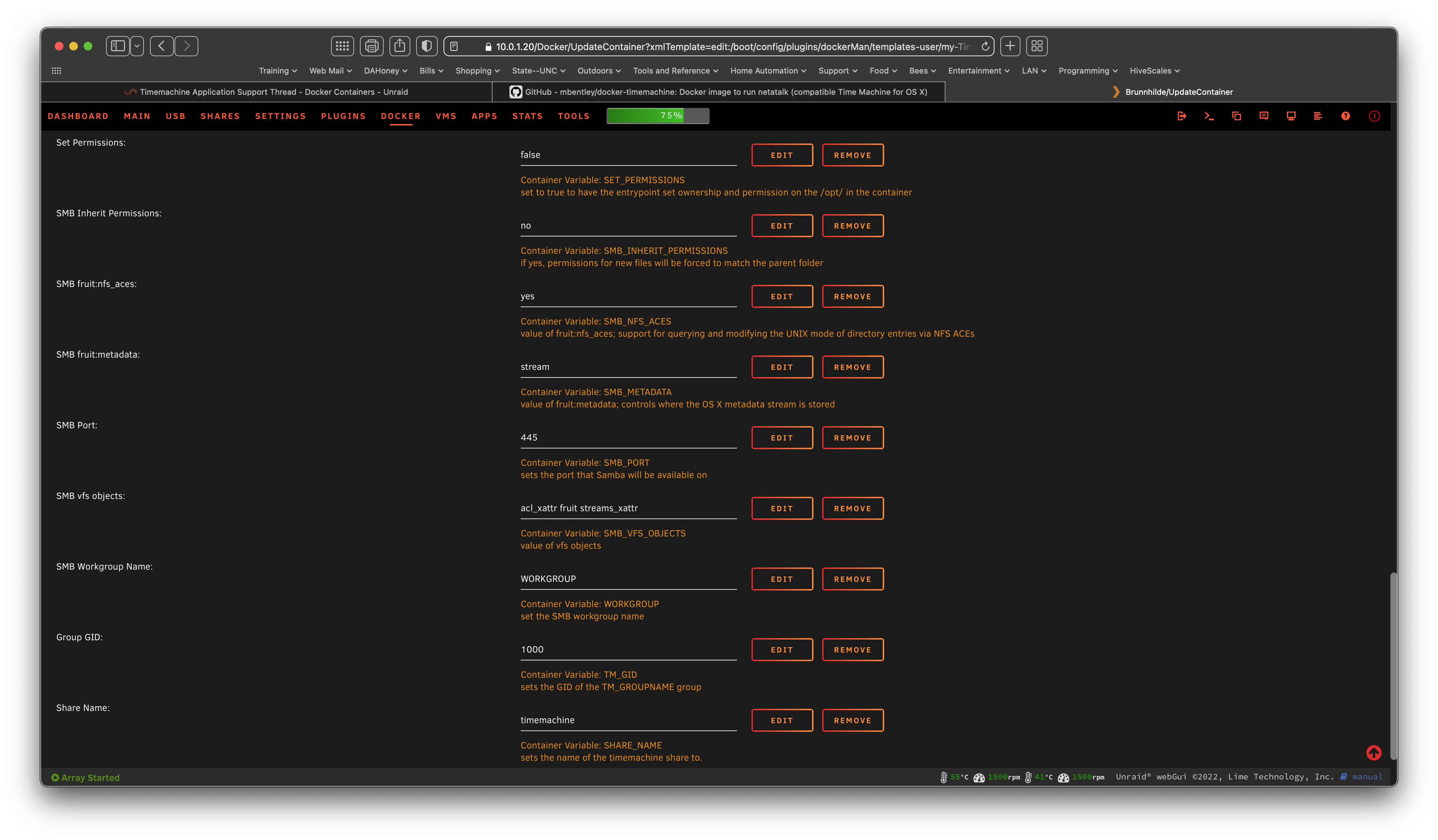

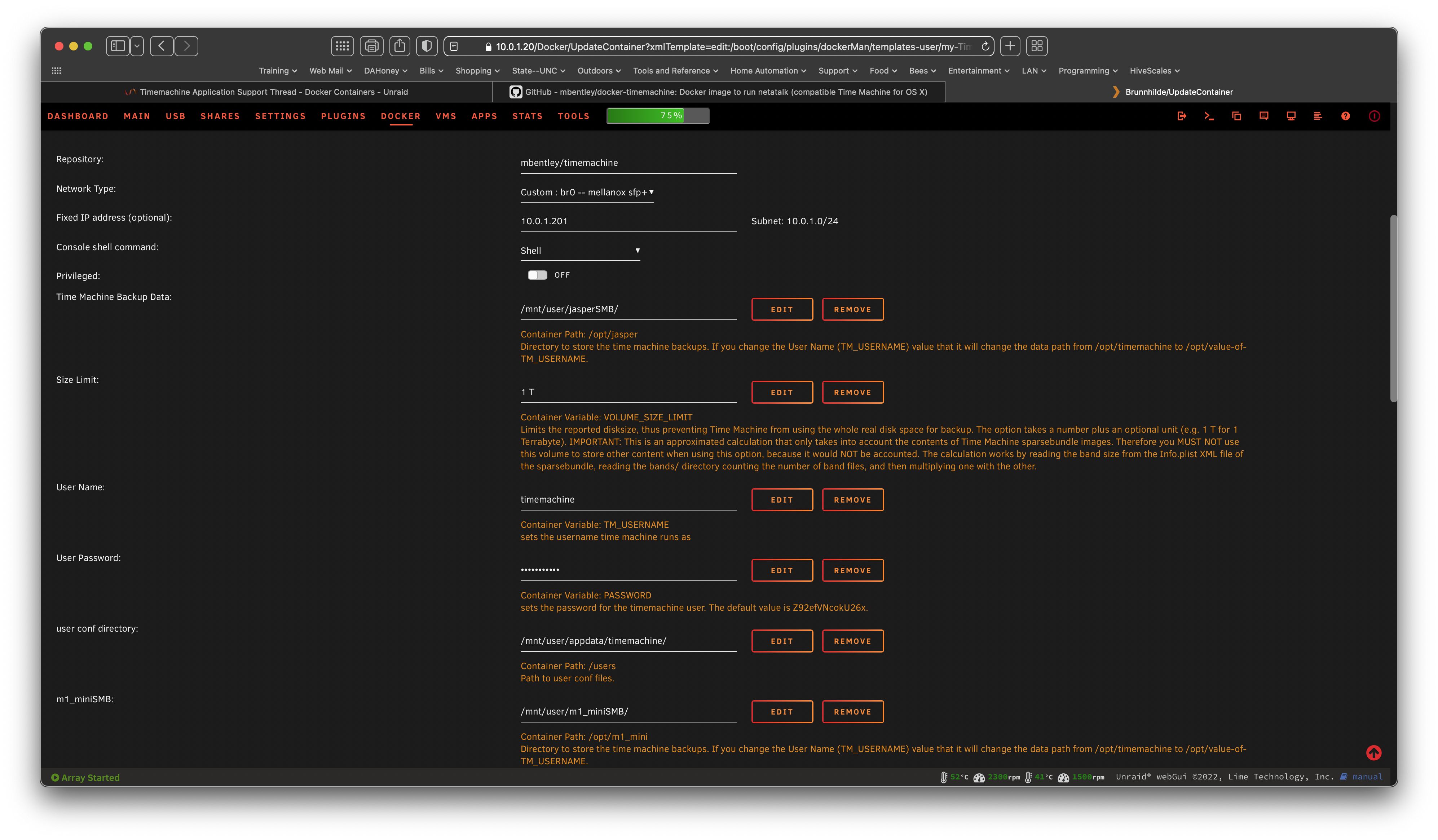

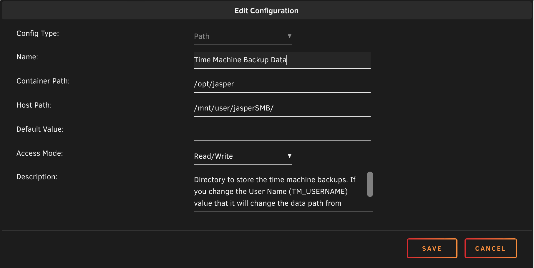

Alright, this time I think I've really got it working. I had to let the docker create the user share (no idea why but it worked) and then run the chown command on that share. After that the backups started working but writing to the docker image again.🤨
Started really digging into the docker setting and found this-
Container Path: /opt/timemachine
Directory to store the time machine backups. If you change the User Name (TM_USERNAME) value that it will change the data path from /opt/timemachine to /opt/value-of-TM_USERNAME.
I had changed the TM_USERNAME but the docker didn't change the data path. It was still /opt/timemachine in the settings but I'm guessing the backups were writing to /opt/value-of-TM_USERNAME which wasn't mapped to anything. I changed TM_USERNAME back to default and everything looks good so far.
Am I misunderstanding the comment I quoted above? Does the /opt/timemachine container path need to be changed manually if a custom username is set?
I think you understood the moment correctly. As with all Docker based applications, Environment-Variables (and that is what TM_USERNAME is) only affect things happening inside of the container. So the container will change the path it writes to - and you will need to make sure that that path is mapped  to the host for persistent storage.
As for the discrepancy with TimeMachineSMB and TimeMachine that might come from the extra parameter "--hostname timemachine" in the configuration. Perhaps you will need to match that name with the value of ADVERTISED_HOSTNAME.
Yeah, this was the part I had originally missed. Maybe I’m a little dense but it wasn’t clear to me at first that I would need to edit the path or I suppose I could have also added a new path. All working good now though. Initial backup just completed about an hour ago.

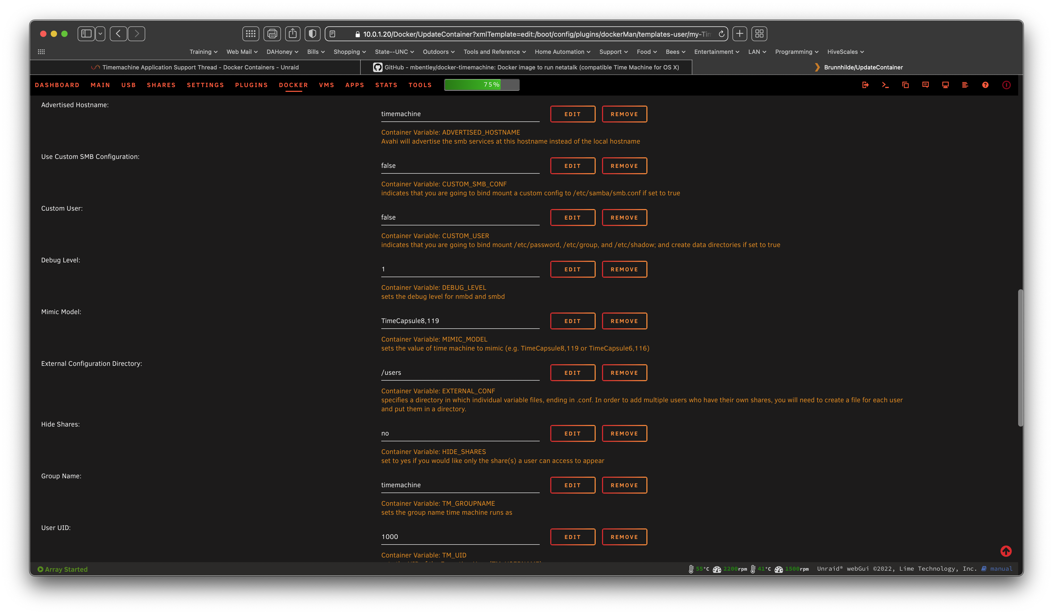

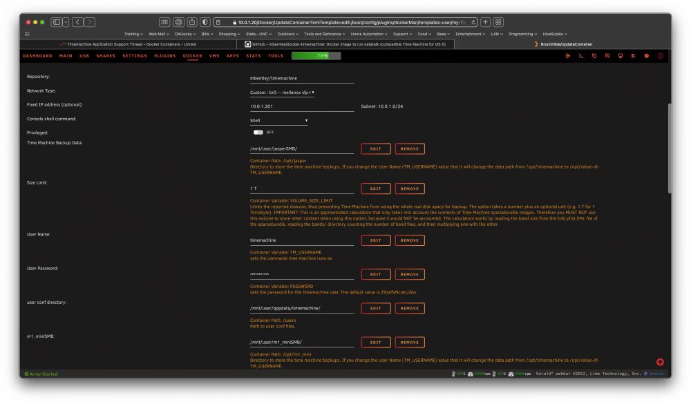

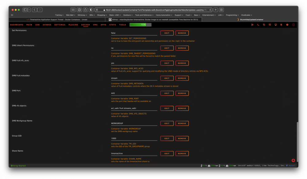

Cannot create encrypted backup. I get an error that the backup disk image could not be created.
macOS Time Machine log-
2022-05-28 09:52:22  Starting manual backup
2022-05-28 09:52:22  Cleared pending cancellation request
2022-05-28 09:52:22  Attempting to mount 'smb://timemachine@timemachine._smb._tcp.local./timemachine'
2022-05-28 09:52:26  Mounted 'smb://timemachine@timemachine._smb._tcp.local./timemachine' at '/Volumes/.timemachine/timemachine._smb._tcp.local./0390E087-DF77-4232-818C-722A15806A97/timemachine' (1.1 TB of 1.1 TB available)
2022-05-28 09:52:26  Initial network volume parameters for 'timemachine' {disablePrimaryReconnect: 0, disableSecondaryReconnect: 0, reconnectTimeOut: 60, QoS: 0x0, attributes: 0x1C}
2022-05-28 09:52:26  Configured network volume parameters for 'timemachine' {disablePrimaryReconnect: 1, disableSecondaryReconnect: 0, reconnectTimeOut: 30, QoS: 0x20, attributes: 0x1C}
2022-05-28 09:52:26  Mountpoint '/Volumes/.timemachine/timemachine._smb._tcp.local./0390E087-DF77-4232-818C-722A15806A97/timemachine' is still valid
2022-05-28 09:52:26  Using a band size of 64 MB (max bands set to 16384, image size 1.04 TB)
2022-05-28 09:52:26  Creating an encrypted sparsebundle using Case-sensitive APFS filesystem
2022-05-28 09:52:45  Failed to create '/Volumes/.timemachine/timemachine._smb._tcp.local./0390E087-DF77-4232-818C-722A15806A97/timemachine/B114B4EC-A042-5642-B37C-216F971A436B.sparsebundle', results: {
2022-05-28 09:52:46  Mountpoint '/Volumes/.timemachine/timemachine._smb._tcp.local./0390E087-DF77-4232-818C-722A15806A97/timemachine' is still valid
2022-05-28 09:52:46  Unmounted '/Volumes/.timemachine/timemachine._smb._tcp.local./0390E087-DF77-4232-818C-722A15806A97/timemachine'
2022-05-28 09:52:46  Backup failed (20: BACKUP_FAILED_DISK_IMAGE_NOT_CREATED)
2022-05-28 09:52:47  Not prioritizing backups with priority errors. lockState=0
run command-
root@localhost:# /usr/local/emhttp/plugins/dynamix.docker.manager/scripts/docker run -d --name='TimeMachine' --net='br0' --ip='10.0.1.21' -e TZ="America/New_York" -e HOST_OS="Unraid" -e HOST_HOSTNAME="Brunnhilde" -e HOST_CONTAINERNAME="TimeMachine" -e 'VOLUME_SIZE_LIMIT'='1 T' -e 'TM_USERNAME'='timemachine' -e 'PASSWORD'='4{s7A/ndxpTG=CbR' -e 'ADVERTISED_HOSTNAME'='timemachine' -e 'CUSTOM_SMB_CONF'='false' -e 'CUSTOM_USER'='false' -e 'DEBUG_LEVEL'='1' -e 'MIMIC_MODEL'='TimeCapsule8,119' -e 'EXTERNAL_CONF'='' -e 'HIDE_SHARES'='no' -e 'TM_GROUPNAME'='timemachine' -e 'TM_UID'='1000' -e 'SET_PERMISSIONS'='false' -e 'SMB_INHERIT_PERMISSIONS'='no' -e 'SMB_NFS_ACES'='yes' -e 'SMB_METADATA'='stream' -e 'SMB_PORT'='445' -e 'SMB_VFS_OBJECTS'='acl_xattr fruit streams_xattr' -e 'WORKGROUP'='WORKGROUP' -e 'TM_GID'='1000' -e 'SHARE_NAME'='timemachine' -l net.unraid.docker.managed=dockerman -l net.unraid.docker.icon='https://upload.wikimedia.org/wikipedia/de/f/f4/Time_Machine_%28Apple%29_Logo.png' -v '/mnt/user/timemachine/':'/opt/timemachine':'rw' --hostname timemachine 'mbentley/timemachine'
e4362ca3db037a976e3ce47ce54b875dc1afc9c1fff129631d0fd1bcbe5b4464
The command finished successfully!
I was able to successfully complete un-encrypted backups but the encrypted backups always fail with the same error.

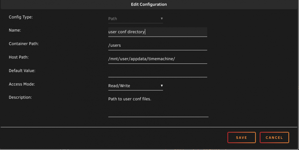

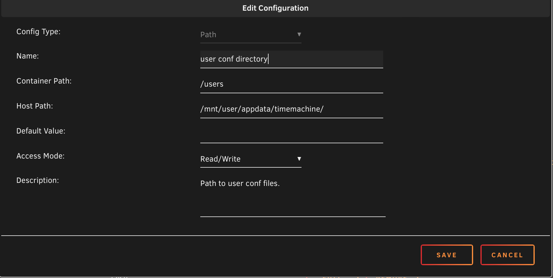

Docker configuration screeshots-
1377775778_ScreenShot2022-06-03at7_17_04PM.thumb.png.d49f1ceaae35d5ae8b3f58c1c42cddde.png
944124111_ScreenShot2022-06-03at7_18_30PM.thumb.png.c37885d5b0b18b546ce0cd00be341260.png
1354229027_ScreenShot2022-06-03at7_18_47PM.thumb.png.9a272695928f3d9c9a58da6df7e784e9.png
Most of these settings are left as default.

2. Each user must have a path set for the backup data mapped to /opt/<username> in the container. One path is already configured in the template. Additional paths must be added as needed. I let the docker create these shares (rather than me creating them ahead of time) so that they are configured properly.
1247015737_ScreenShot2022-06-03at7_43_04PM.thumb.png.ad68c0d1dd350fa4fd5d0f03f6e53d3c.png
