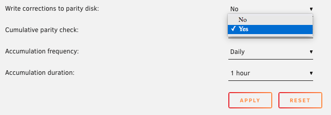

Unraid 6.10 has built-in support for splitting the scheduled parity check into multiple shorter periods. See Settings -> Scheduler
True, but it is not as flexible as the Parity Check Tuning plugin (which also has more capabilities than the built-in feature).

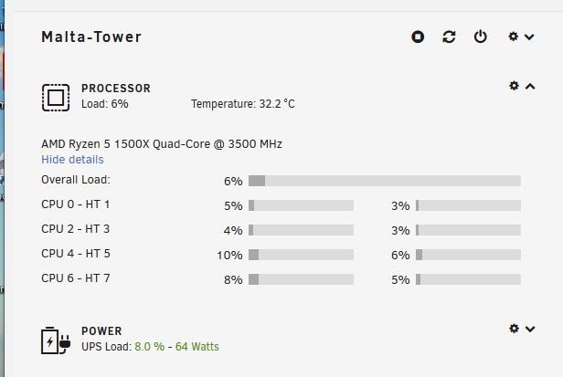

Just read through your build thread.  I touched on it in an earlier post, but you'll appreciate the reduction in power.  My HGST drives are a bit power hungry.  I keep 3 spinning all of the time (parity + 2 with video media) plus a NVMe (cache + appdata) and a SSD (usually idle - my transcode cache drive, until I kill it, it is ancient).  The screenshot below is when sitting idle in this state.  56-64W.  When all drive are spun up, and CPU busy, mid 90W.  I have to max the system out to get it to pull 120W.
