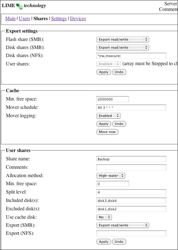

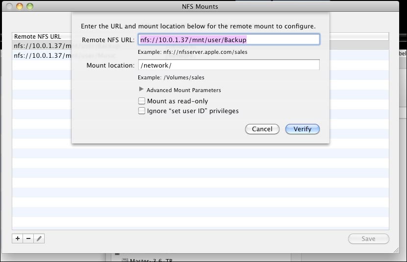

I'm trying to work out using NFS shares in OS X. I've attached two screen captures that show where I am. I've been spending quite a bit of time trying to figure out what to put in the "Export (NFS):" field but I am pretty stuck. If someone could review my screen captures and let me know what I'm missing I would really appreciate it. Also my getting the NFS mounts dialogue in OS X computer correctly? Many thanks.
Remote NFS URL: nfs://tower/mnt/user/Backup OR nfs://10.0.1.37/mnt/user/Backup
Mount location: /Volumes/Backup
You should mount all your volumes under /Volumes/, for consistency at least.  And just name it the same as your unRAID share.

Fast reply, thank you. This will keep me busy for a while.  I think I can work with this, very helpful.
I also noticed that you have nfs configured for 'disk shares' but not for 'user shares', but you are trying to mount the user share (Backup). I think you need to add (or move) your *(rw,insecure) to the nfs spot in the user share.
