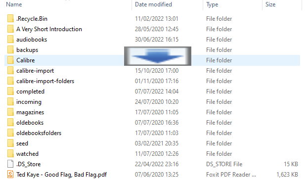

Try turning off the 2 "privacy" settings in windows explorer folder options.
This worked for me when having similar issues years ago

Also try this.   Go to the share in Windows Explorer.  Right click on it.  Then select Properties from the dropdown list.  Then look for the Customize tab.  Set it up as follows:
What this does is stops Explorer from trying to populate 'things' like thumbnails of photos, etc.

Thanks. I'll try that and see if it helps...
Afraid I'm still getting the same issue. Sometimes even moving the mouse over folders is enough to crash it.
