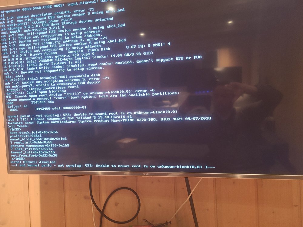

Hi! Tried to update Unraid today to the latest version and clicked reboot when it asked me to.
Now when it tries to boot, it shows this error (see screenshot).
Any quicktips? Thank you.

That tends to indicate a problem reading a file off the flash drive.    You might want to try following the procedure here to see if it helps.
THanks @itimpi! Replaced the bz files like in the guide you posted and Unraid back up running again.
