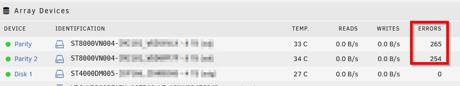

I have two Ironwolf ST8000VN004 7200RPM drives as my Parity Drives.  One is less about 9 months old, the the other about 4 months old.  Both drives are throwing errors.

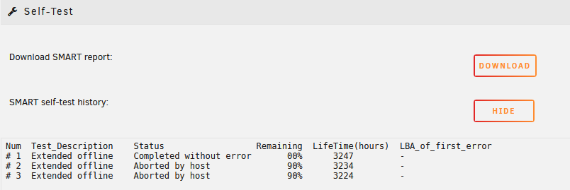

  • Run an extended SMART self test on one of the drives, no errors detected
  • Looking at the smart data, there are no apparent SMART values out of whack

Looking for suggestions on what might be wrong, and what to look at next to fix this issue (If it's a false error, then suppress it.)
