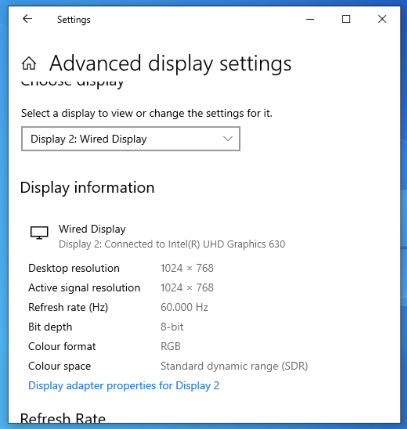

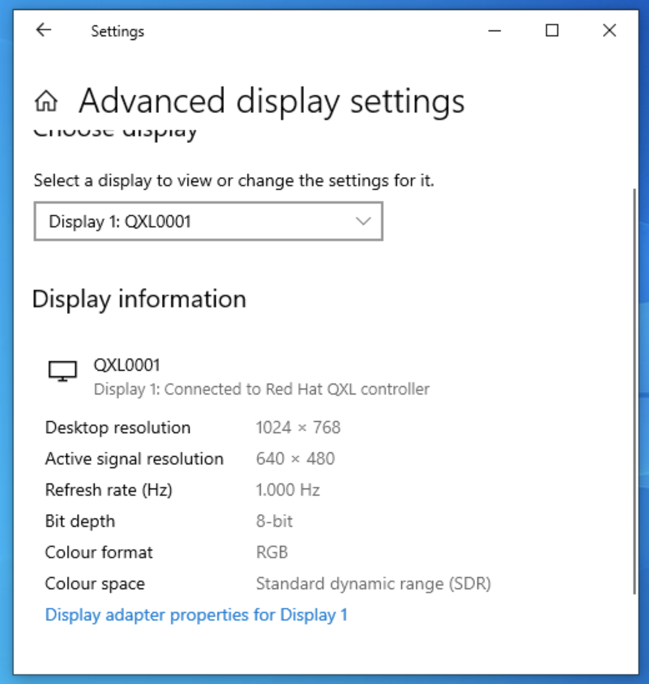

Little update:
I tried configuring the VM to use VNC as first graphics card and my IGPU as second graphics card. Now inside the windows setting two display are shown (see images below), but the external monitor keeps having no signal.

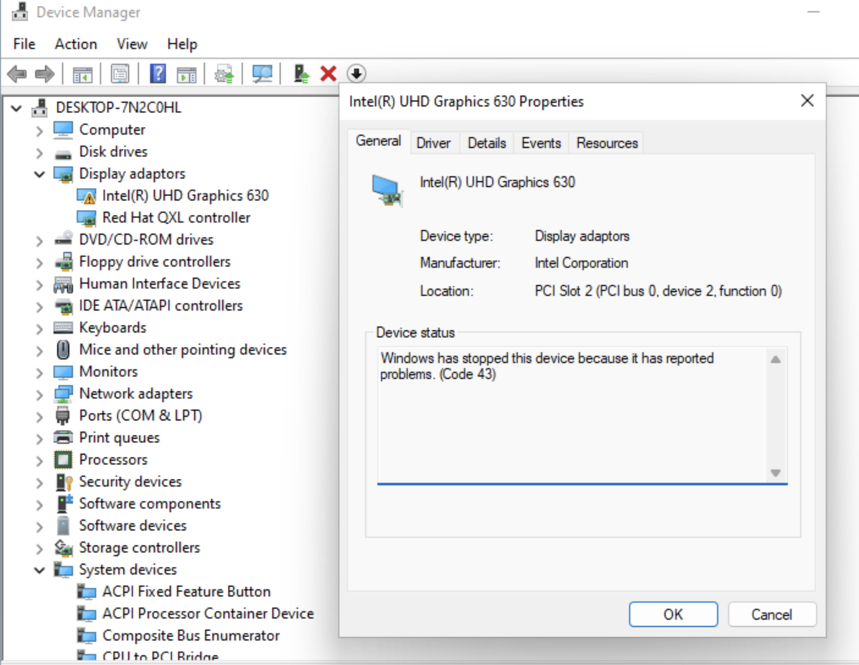

Ok,
I have tried making a brand new windows 11 install and now the device manager shows the IGPU but gives the infamous error 43 (see below).
If anyone can help any assistance would be very appreciated.

So I finally got the display working by changing the bios from OVMF to SaBios. This unfortunately means that I can't install Windows 11 because of the missing TPM support of the BIOS (from what I've understand).
However, despite I would prefer to use Windows 11, is not a major problem for me and hence I installed Windows 10.
Now I got Windows 10 working but the IGPU still gives me Error 43 in the device manager and the screen quality is very poor.
I tried installing the Intel drivers but that didn't improve the situation.

Update
16 hours ago, santinilor said:
Now he goes on explaining how to use a non EFI compatible GPU with OVMF
Where? Are you sure about this?if bios is uefi as far as I know there's no way for a legacy gpu to output anything, but this isn't your case.
You igpu should work both with uefi and legacy bios.
Error 43 is a generic error meaning that the gpu cannot be initialized, this depends on several reasons.
