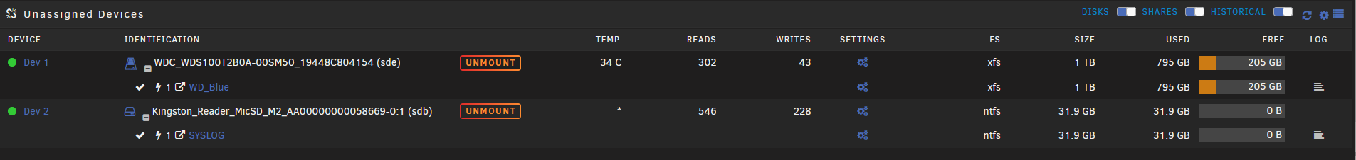

My syslog is written to a  flash drive configured as an unassigned device.  For some reason it says all space is used when it has very little actually stored on the card.  This is a Micro SD card without a lock switch.

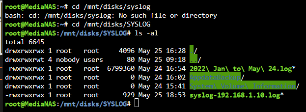

The flash drive for the syslog is definitely not out of space (it's 32GB) but rsyslogd is not writing anything to the syslog file on the flash drive.  I even reformatted the flash drive.  Immediately after this, the syslog file was written but it stopped after a few lines and has not been updated in a couple of days.
My appdata backup also goes to the same flash UD flash drive and there are no issues with that process. [UPDATE: apparently this was the problem as the last appdata backup went crazy and filled the disk]
While running unRAID 6.9.2 the syslog on the flash drive was written to without issue from Jan to May 24 when it suddenly stopped after the 6.10.0 upgrade. [It was the first appdata backup that happened shortly after upgrading that caused the problem so I though it was the upgrade that was the issue.]
What could be causing rsyslogd to think the drive is full when it is not and failing to write to the syslog?
Permissions look OK?
