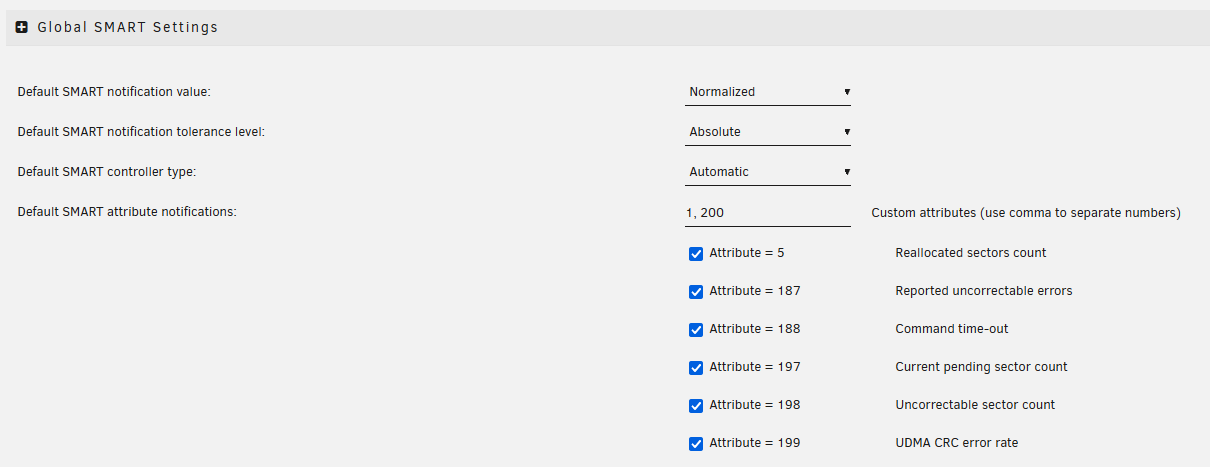

For which SMART fields do we get notification emails on value change? I can not test SMART data changes, so I would like to know where to look up which fields are configured to raise notification emails.

I did enable all SMART Notifications and added 10, 184, 196, 200. I don't use 1 because I would need to exclude Seagate disks from parameter 1.
