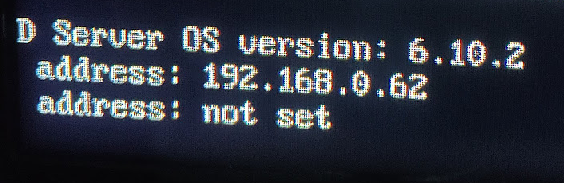

Yes, it's working again now! I don't really understand why though? The server has always had a static IP address of 192.168.0.62 but after the update to 6.10.2 I couldn't reach this. After one of the reboots I tried I noticed that it was saying 192.168.0.32 (as in your comments) but I couldn't reach this either. I've now connected to 192.168.0.62 on my phone and laptop as I normaly would. Do you think deleting the network.cfg file fixed the issue, or was it something else? I am a newcomer to unraid and would like to learn more,  but to be honest at the moment I'm just happy it's up and running again, so many thanks for your help!
Not really sure what the problem was, after initially updating to v6.10.2 the NIC was blacklisted and you losing access was expected, this is because of an issue with mostly HP servers with the same NIC, your server should not be affected by that, so after unblacklisting the NIC it should have worked as before, and it should continue to work if you give it a static IP.

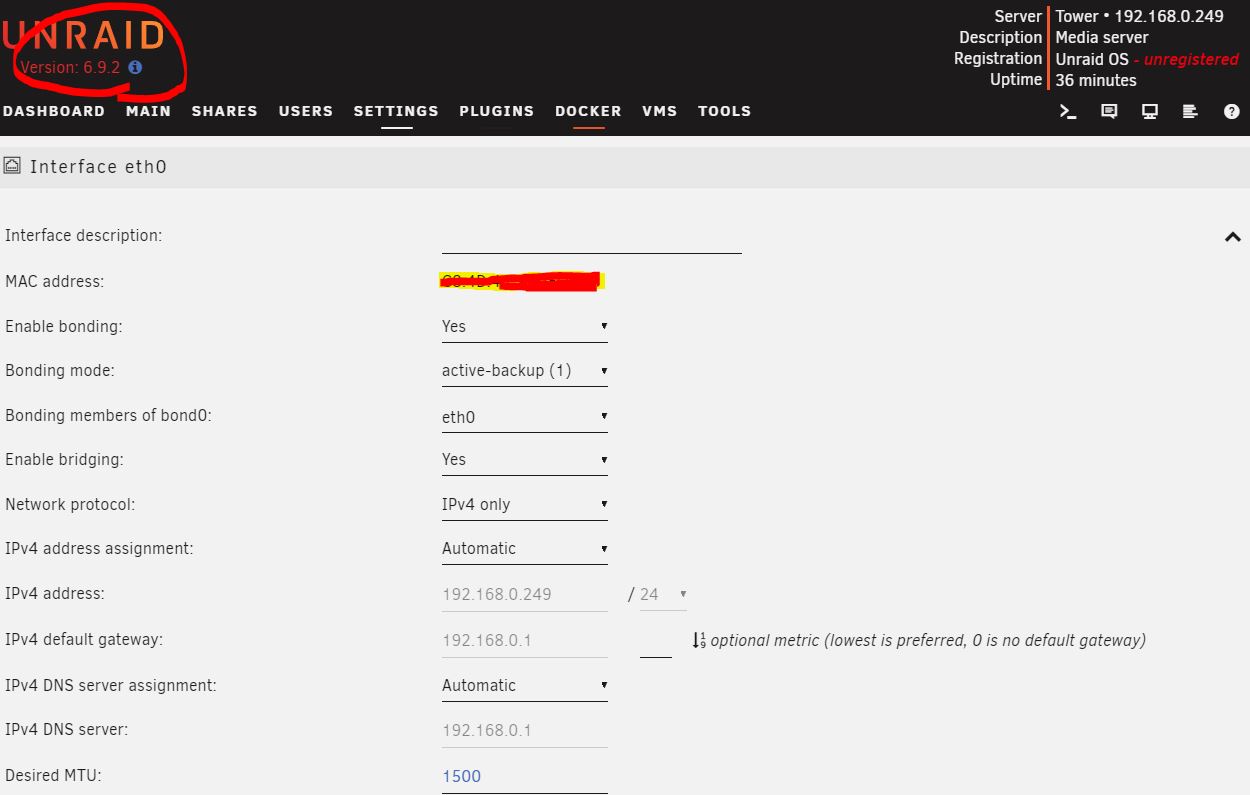

1. A laptop ( Intel Gen11 Tiger Lake i7 ) with out physics LAN chip but plug-in a USB-Lan dongle using RTL8156B (Should be USB 3.0 ).
2. USB boot by 6.10.3 but always show cannot find eth0 even turn off the VT-D/VT-M

Turns out ! It works by 6.9.2 after giving it a try !, I didn't change anything but version ( also issued on 6.10.1 )

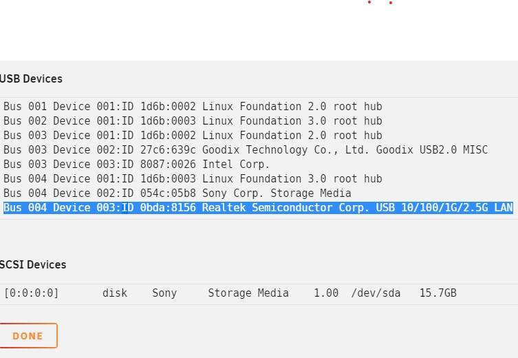

And for the device detections, it always shows "Bus 004 Device 003:ID 0bda:8156 Realtek Semiconductor Corp. USB 10/100/1G/2.5G LAN" at System Devices page no matter 6.10.3 or 6.10.1/6.9.2.
Not surprised, since I suspected that NIC was not supported by v6.10.x, and the NIC was being detected, but since it's USB it doesn't show up on lspci, me being a dum dum.
Soon there should be an easy way to install out of tree drivers, then you should be able to make that NIC work with a newer release.
