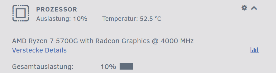

My 5700G idles in the low 30's C.  This is with a stock Wraith Stealth cooler. The room it is in is typically about 80 F this time of year.  Case is a  Cooler Master HAF XB EVO, this pic was taken a few minutes ago.
145776607_Screenshot2022-05-29at10-26-21Tower_Dashboard.png.1d79e0adde61fdb7cdf66acd9445c052.png

How is yours idling below everyone else's?
Do you have the right sensor selected? The k10 sensor?
As the other CPU sensor shows mid-30's for me too.
I am using this driver, nct6775, cpu temp is nct6795.  My IR temp gun agrees with it.  K10temp shows 50.1 but that does not correspond to the actual cpu temp.
ok, then that'll be why.
The NCT6755 is a sensor on the socket, not the CPU. Technically correct for what its measuring, but not the same as the cpu die temp.
I'm guessing the others, like me, are using the K10 temp (the on-die sensor), as your NCT temp is the same ball park as my NCT temp, so your temps are basically the same. 🙂
Thanks for the feedback though, helped understand the difference as i was like 'eh!? how!?' 😛
it can't unless you use a drill an open the processor 🙂
The AMD Ryzen contains several chips and measures temps at different points of the chiplet.
the ~50° are inside the cpu itself, the ~30° are taken from the covering metal heat spreader. Your thermometer can only see this one.
So Folk, stop worrying, both temps are correct. Unraid reports the higher one as "CPU Temp", the lower one is shown as "Motherboard Temp" with my ASUS Board.
And, according to the AMD Specs, unless you dont reach more than 90°, there is absolutly no problem or slowdown.
For higher ranged AMD Ryzens there should be a 3rd temp available because they have 2 CPU chips within the chiplet. But I have no idea how to read both of them, you only get temp from chip #1
