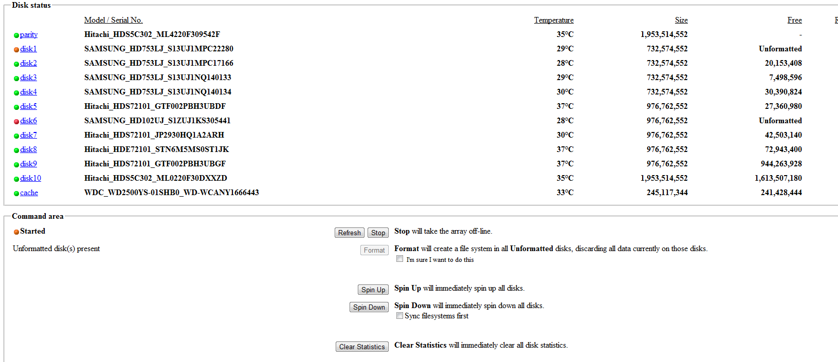

Thanks, I tried booting without Disk1 and it got all the way in and locked up as soon as I opened a share and tried to copy something.  Tried rebooting again with Disk1 in and then got that it wanted to rebuild onto Disk1.  Maybe that was a mistake but I did.  Now I have two disks unavailable including Disk1.  See the attached.  I see that it can't find the file system on Disk1 and Disk6.  No way am I reformatting now unless someone tells me it's the right thing to do.

I'm still in the same state.  The array is online and accessible but I have two drives showing up as unformatted.

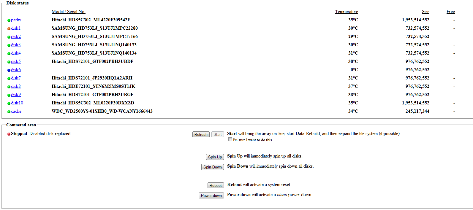

Ok, I was able to determine that I have a bad port on one of the two port SiI cards.  So, I borrowed a friends 6 port Adaptec and now have the attached results.
Disk1 is in the "working" port of the two port SiI although I'm not sure I can trust it.
Disk6 is on the Adaptec and is showing up as blue.  The naming of the disk isn't getting passed through.
I tried both disks on the Adaptec but then there were too many unknown disks and I wasn't given the option to start it.
Should I start the array and let it try to rebuild the data?

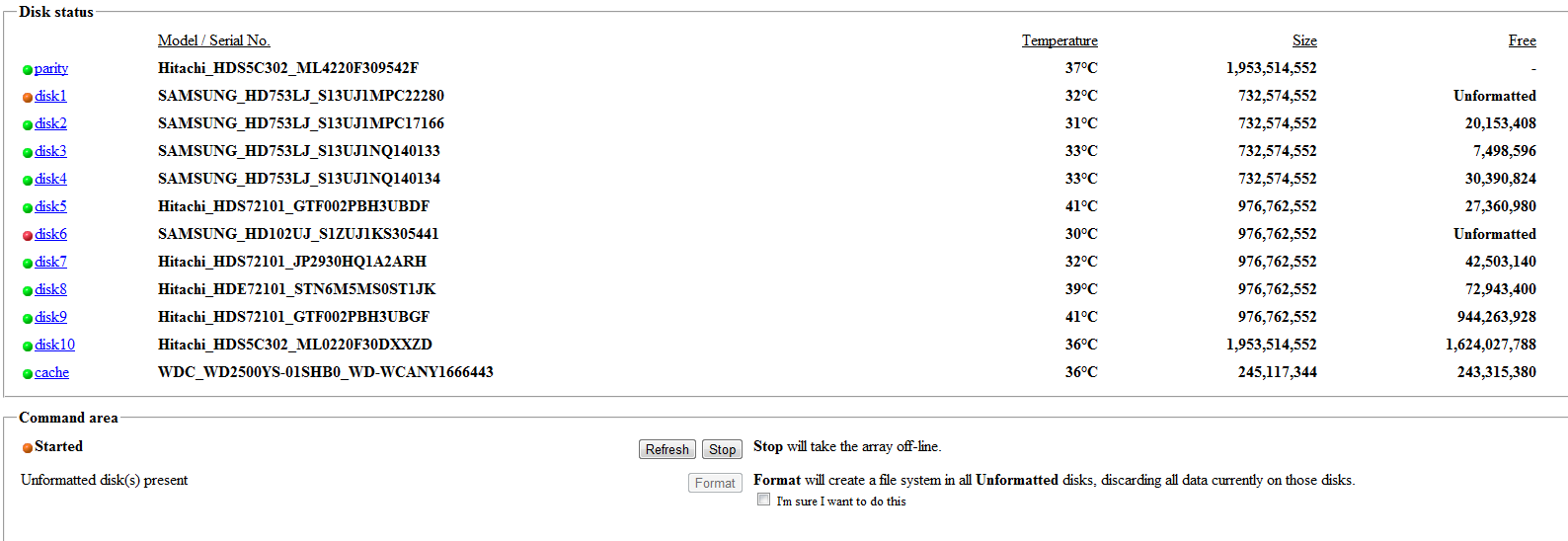

Ok, got a replacement SiI card installed and the attached screenshot shows the current state.
I pulled up unmenu and Disk1 is showing "disk_invalid" and Disk6 is showing "disk_dsbl".
Smart reports are attached.  I didn't see anything wrong with them but I might be missing it.
Syslog is also attached and shows some errors.  I tried the reiserfsck and got the following "bread: Cannot read the block (2): (Input/output error)" for both drives.
So, what's my next step?
