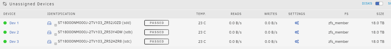

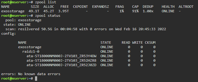

Current Situation:
At the moment I have 5 drives installed
2 x 256GB NVME M2 SSDs on the motherboard
3 x 18 TB EXOS X18 Drives that are running in a raidz1 setup
I'm now getting an additional 5 drives.
3 more exos 18 TB drives and 2 500GB SATA SSDS.
My goal would be:
An array with 6x18 TB Exos drives (1 drive as parity) for all data which is currently on the zfs raid.

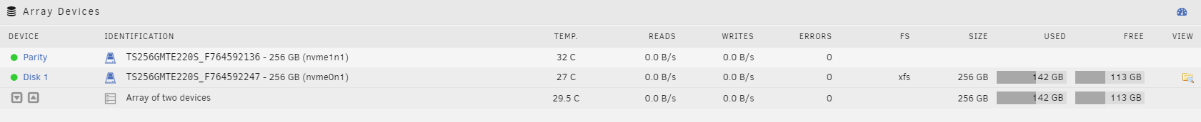

Unfortunately I kinda screwed up the process and lost all my docker container data and VM data. It's not a big deal, i can set up everything from the start.
But to avoid any mistakes I have another question:
I would like to put alle dockers and VMs on the NVME_Cache Pool.
At the moment I have the following Array:
And 2 pools:

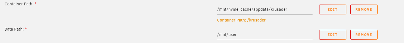

How do I setup that all the Docker Containers, VMs so that all the Container Data will land on the NVME_cache ?'
For example when setting up Krusader:
What would be the correct paths ?
And what do I have to do to get rid of all the older which from my previous installation which mostly contain no data?
I have an empty appdata, domains and isos folder under disk 1, also under user and user0 which is kinda weird. but for some reason in all the system folder there is still some files from the previous installation I guess. docker and libvirt .img file ...
Any hint/clue which of these folders can be deleted before I start installing all apps and vms again ?
Edited by matuopm

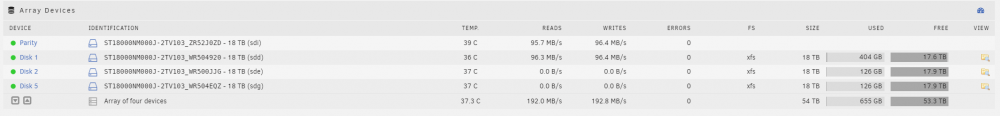

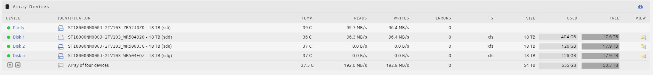

I also have an additional question.
I'm currently copying all my files from my zfs raidz1 to the normal unraid array and I have writing speeds around 60-120 MB/s. Its pretty random in between these numbers even when copying very large files. A thing that I dont understand really is:
I can read from the ZFS raid up to 500MB/s and the Exos x18 18TB can write up to 250 MB/s
But on the array I'm having constantly reads and writes on Disk1 and on the parity drive.
Which is probably the reason why the speed is that low, right ?
Is it really copying from the raid to Disk1 in the array, and then at the same time reading from Disk1 and writing to the parity?
It feels like it is like one extra step which slows the process down severely.
Wouldn't it be enough copying from the zfs and writing to disk1 and parity and the same time ? Why is there an extra read process from the Disk1 while data is being copied on it ?
Edited by matuopm
See below for an explanation of both available writing modes, turbo write is faster at the expense of spinning up all drives for writes.

Thank you for the Turbowrite hint. This really solved the speed issue. I'm getting constant max speeds now on large files which is great.

Ok I just read some part of the user shares documentation. Do I get it richt that its better that I edit the usershares (appdata and so on) to be on the NVME_Cache Pool instead of changing the path of the docker containers.
Yes.  But it depends upon how you've referenced the share in the apps.
If you've referenced /mnt/cache/appdata/blah then you've got to change them all to reference the new path.  If you've referenced /mnt/user/appdata as the system is designed to do then moving the appdata share to the new pool and then changing the share settings is all you need to do.
I got the krusader docker up and running and it seems that it is running exactly like the way i wanted to be. all data stored on the nvme cache.

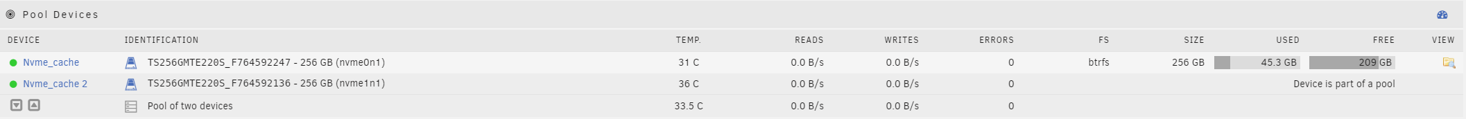

Ok at the moment it seems all my problems have been solved. I only have one thing which I dont really understand.
I have appdata, domains, isos and system on the NVME Cache Pool. Its a 2 Disk pool, so its Raid 1 I think ?
But the names of the shares are all orange, which means they are not protected. But in this case as a Raid 1 it is kinda protected for one disk failure, right ?
Anyone got a clue how can I fix that ?
Edited by matuopm
If you post your system’s diagnostics zip file we can check that out.
Could not spot any reason in the diagnostics why the shares are not showing up as protected.
11 hours ago, matuopm said:
Here you are 🙂
The colors in the dashboard have a different meaning, which can be confusing I guess, there it means those shares are set to cache only, if you click on "Shares" you'll see the green ball or orange triangle before each share name indicating if the shares are on redundant storage or not, though for pools it only checks the pool is multi device, not if it's actually redundant, so if for example the pool is raid0 it will show protected when in fact it's not.

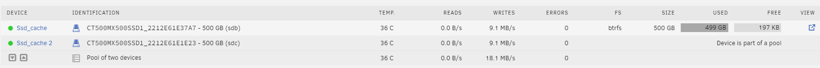

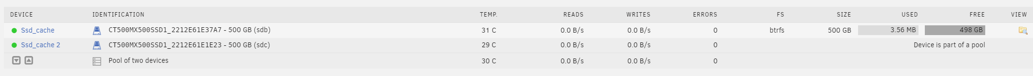

Ok there is still one question left.
I have this 6 Disk Array and have a 2 SSD Cache Pool and I'm not sure how mover really works or how I set mover up correctly with the cache pool.
My thought was:
When I copy something from PC to a share that uses the cache pool. It will copy it on the cache first and the mover will move that stuff to the array at a certain time. So that the cache is empty again. A feature so that HDD don't spin everytime i copy something up unless the cachepool is full.
But the cache pool is full now and I started mover but it does not move anything away from the cache pool to the array.
Is it me having a false understanding what mover and a cache pool really does or is it supposed to work that way ?
Screenshots as example.
Actually it writes something at the moment but I'm not copying anything at the moment 🤷‍♀️
Is it possible to user the cache pool as a "write cache" only, when I copy something on the array. And every 8 hours or so it should clear the write cache and write stuff to the array ?
You are likely to get better informed feedback if you post your system’s diagnostics zip file.  That way we can check how you have things configured and what is going on.
For some strange reason it works now when I start the mover. I just updated to the newest unraid version, made a reboot and it works.
