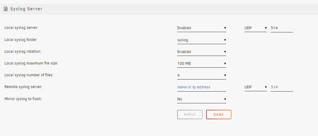

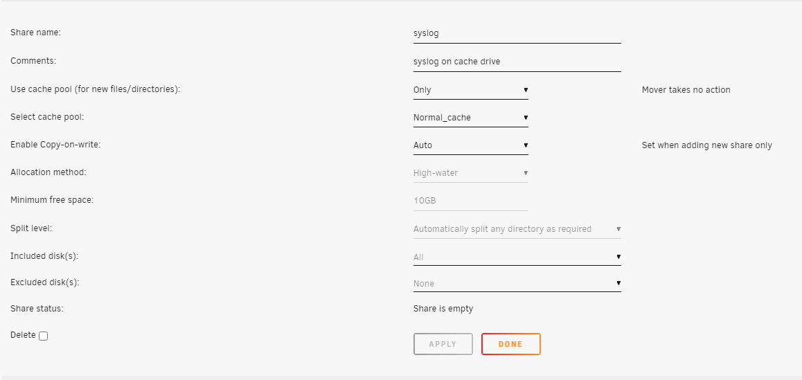

20 hours ago, Domotics said:
Thanks, i will setup one today.
I created a new share named syslog with cache only (on my ssd cache) and pointed the syslog to that share, but it doesn't seems writing any logs there. am i doing it wrong ?
