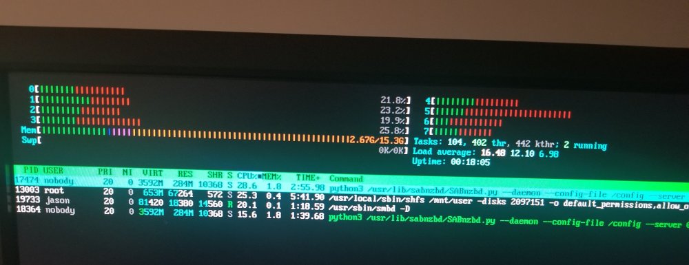

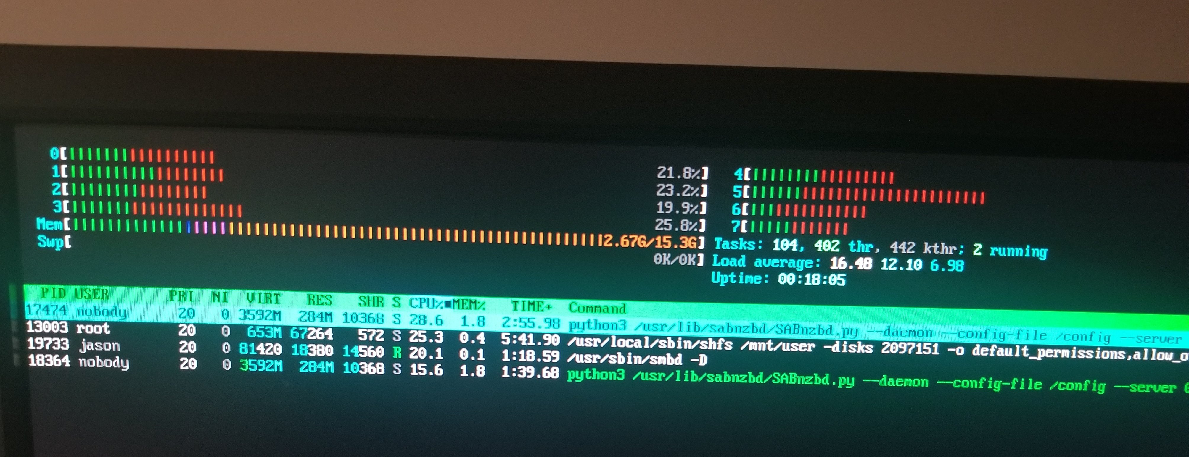

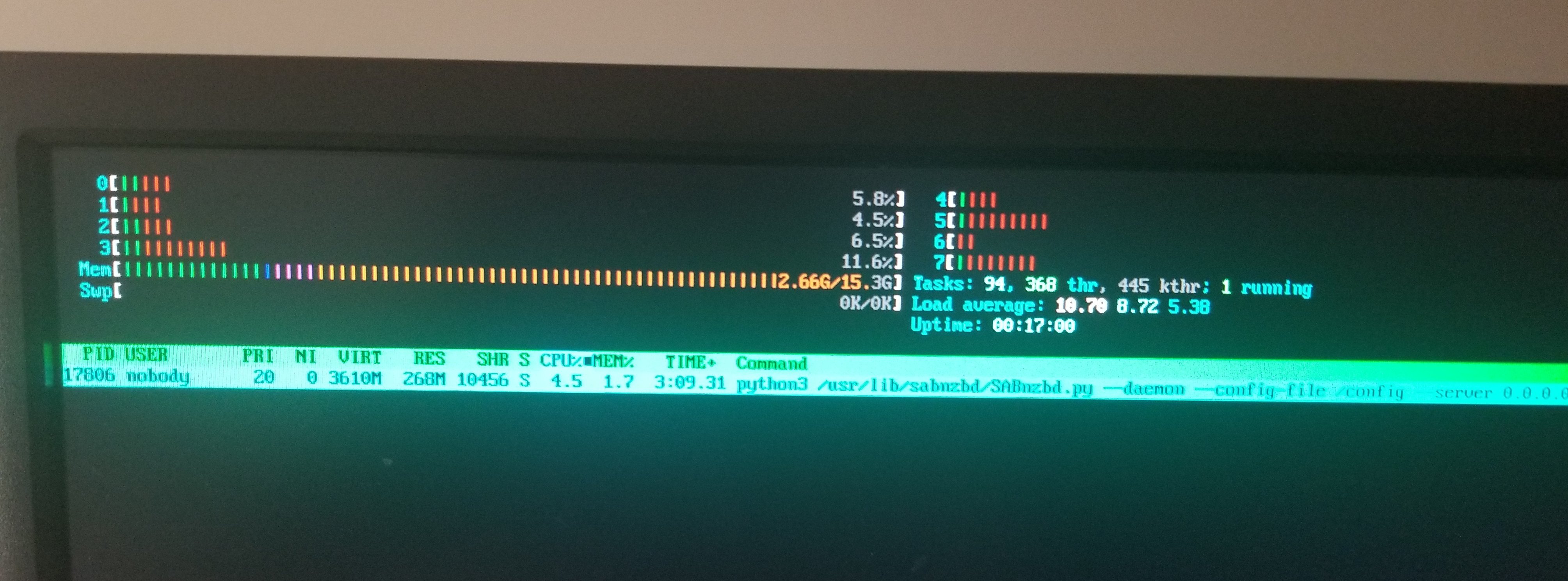

Here's a photo of what the screen looked like before I had to power off/on.  Totally frozen, no movement, KB dead, and showed an uptime of 17min when it froze.
Up 18 mins this time, then hung.
