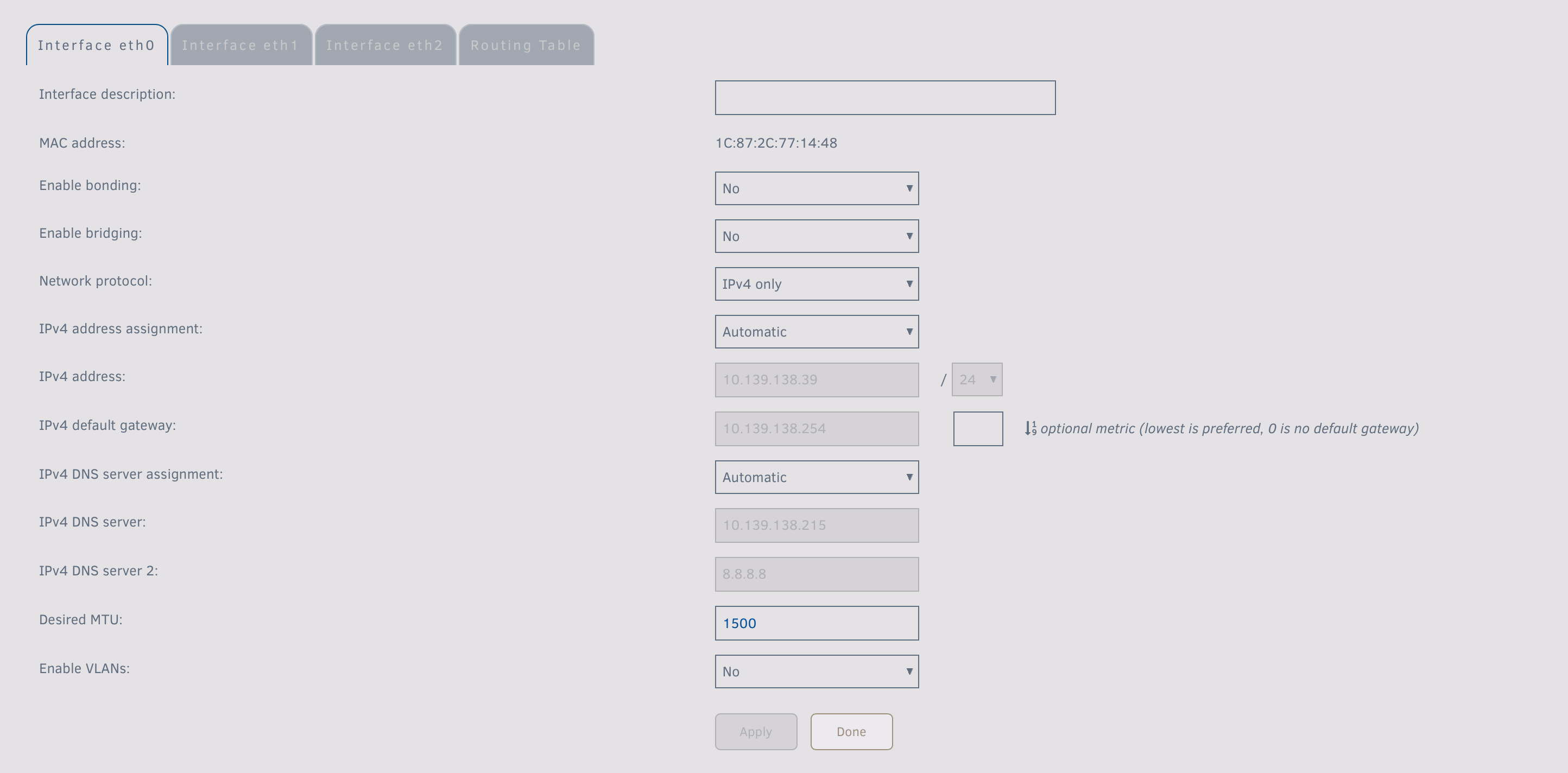

3 Network Adapters, Interface rules tab missing
I need to change ETH0 Has it changed location? I can't see the tab at all!
I have stopped and started Docker, Nothing, is it possible to adjust elsewhere, Possibly on USB or Shell

This *Resolved* by first downgrading to 6.10.1 that Brought back interface rules but then ETH2 MAC was showing as ETH2 and ETH3 (eth3 was not an actual adapter)
Removed ETH2 Card from the system and then ETH0 appeared allowing to swap ETH 1 to ETH0 as I wanted.
....... Fixed but not in a good or meaningful way.
