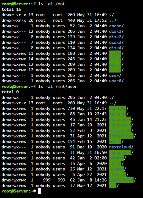

Start the GUI Terminal and type the following command:
ls -al /mnt
Post up a screen shot of the output.
Then run this command:
ls -al /mnt/user
Again get a screenshot and post it up.  Now compare the names of the User Shares  (found under the 'Shares' tab on the GUI) with this screenshot.  Any directory in the screenshot that is not in the User Share list is probably the problem.

Here's the screenshots -- the User Share list also matches the output of the ls -al /mnt/user

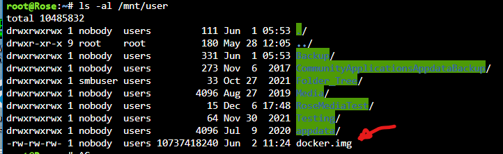

I had a look at your screen captures and I observed the following.
I have noticed that you do not have a docker.img file listed.  I would have expected to see it there.

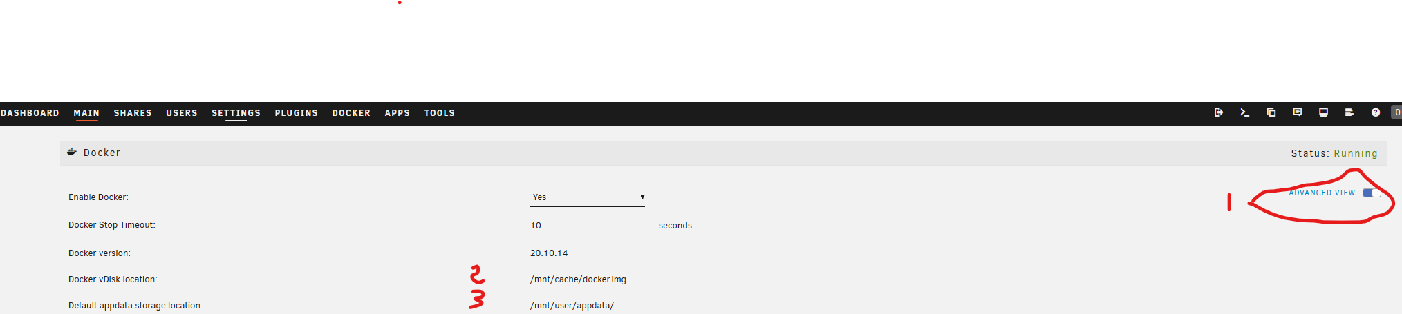

This is where the location of that file is set:
Make sure the 'Advance view'  (#1) is turned on.   Then check paths #2 and #3.  These are the defaults.

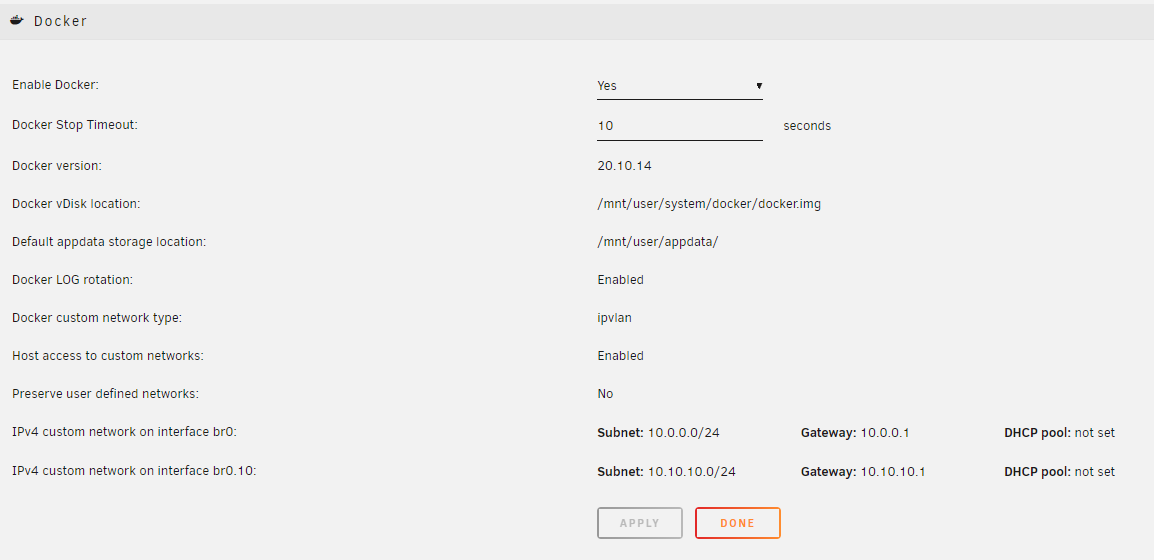

Here's my setup - I must have moved it originally thinking that the system share was always going to be cache-only or something?
Here's the ls -al /mnt/user/system/docker as well

One thing that bothers me.  Notice the color of the User Share 'nextcloud' in your screenshot of the ls-al /mnt/user command.  It is blue when all of the other shares are green.  I tried to find out what is the significance of that one being blue and I could not find it.  (Also notice that the permissions are different...) So I would be looking whatever is controlling that User Share.
Thanks for the info -- I actually no longer use that nextcloud share, I will just be getting rid of it entirely. problem solved w/ the odd permissions then ;)

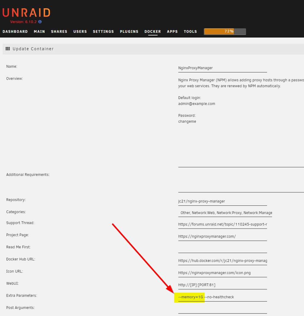

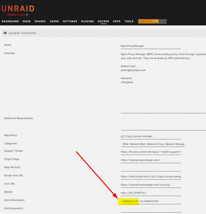

Regarding the out of memory error, if it's possible that it's caused by a docker, then I think it is the 1GB docker limit I set on Nginx Proxy Manager
I am seeing this in one of the lines of the logs.
 memory: usage 1048576kB, limit 1048576kB, failcnt 12250
That kb count equals exactly the 1GB limit which I had set on this container.
I have now changed it to 2GB for now, but I may remove the limit entirely I guess, as I have 128GB of RAM, so plenty to spare.
This template came this way from CA w/ the 1GB limit, so I left it, but I may be using it a bit more heavily than most others...
I removed the memory limit on that container and it seems to have resolved this issue. Fingers crossed!
