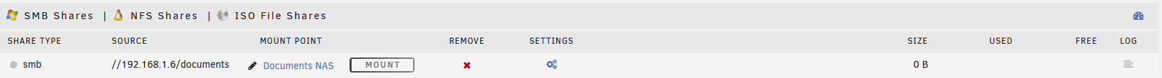

I've been trying to get a remote share to work using Unassigned Devices and it just won't work.
I can succesfully add the share using the wizard, but then it remains offline and I can't mount it.
I tried:
- Ports 139 and 445 are open and SMB sharing is enabled on the target server. In Windows I can access the shares just fine.
- Using a different user/pass
- Trying another folder
- Searching this forum
- There is no info in the UD logs or the Unraid logs.
The remote server must respond to a ping or UD thinks the server is offline.  You'll need to insure the remote server is set to respond to a ping.
I tried it from command, and it indeed does not respond to a ping. How do I change that?
Edit: I found it! I enabled ICMP for that specific IP in my firewall and it worked! Thanks!
