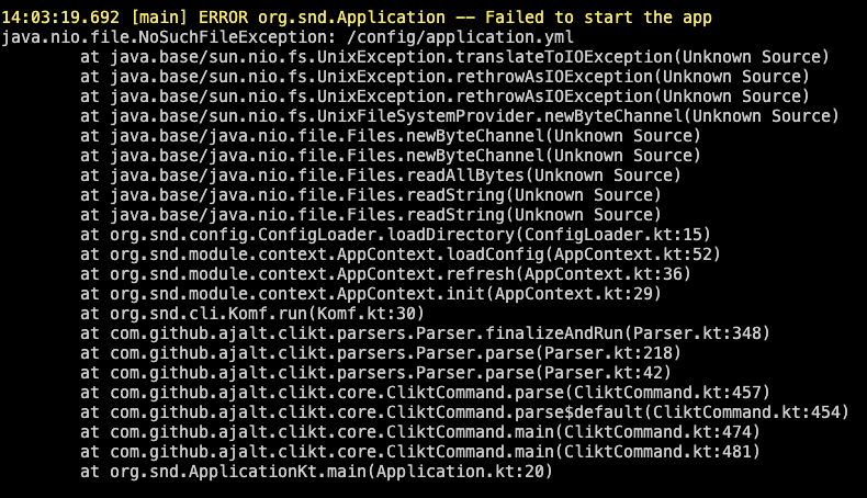

Can't seem to get it running. I've ensured 5 times now that my application.yml is correct. Is it an issue with Komga?
Hey Mckenna,
I see this error for the first time. From the logs it seems that komf gets the event notifs from komga but can't process them right.
To further help you please give me the docker run from Komga and Komf. Also your komf application.yml. Lastly set in komf the Loglevel to debug and give me those logs.
Don't forget to Blackout/replace the api keys and passwords.

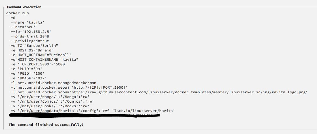

Hello C3004,
first of all, thank you very much for your work with Komf-Docker. It will be a great addition to Kavita when I get it up and running. :)

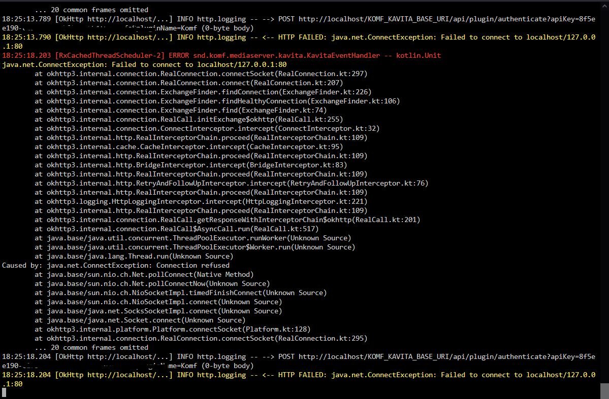

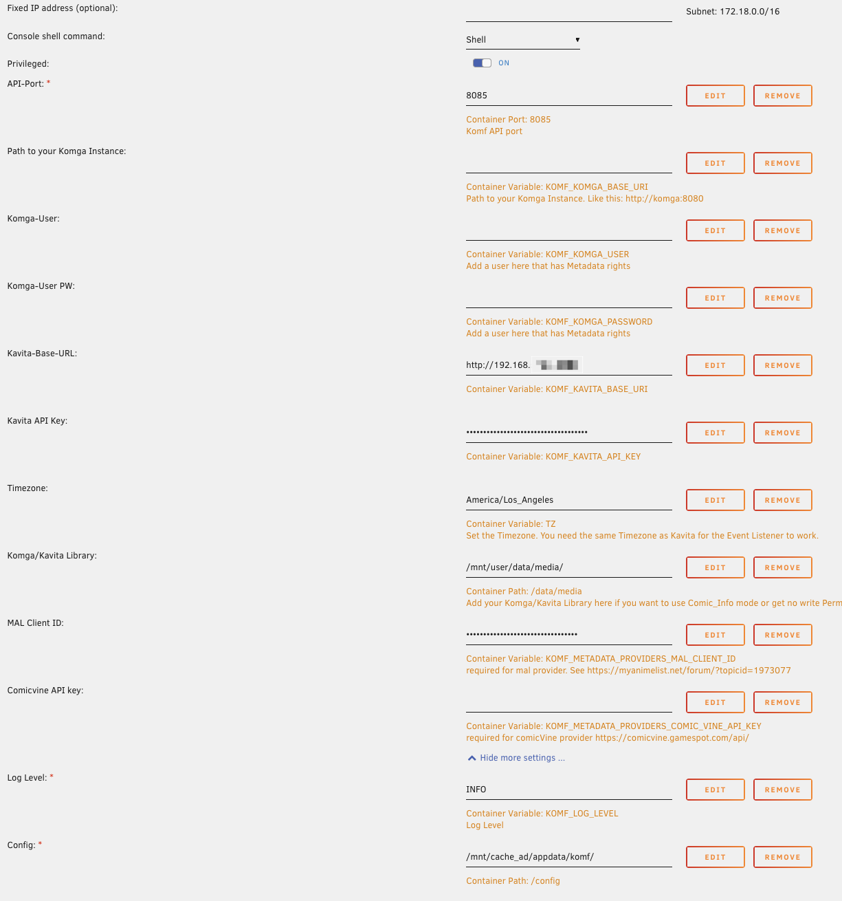

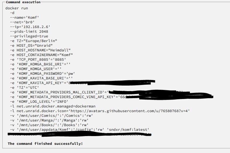

And here we are... when using the function “Reset Metadata” for a single comic series, I get this error message “Failed to reset series: Request failed with status code 500”
(I have not yet used the “Reset Metadata” function for the librarie).
I also get this error message in the Komf log.
18:17:58.160 [RxCachedThreadScheduler-2] ERROR snd.komf.mediaserver.kavita.KavitaEventHandler -- kotlin.Unit

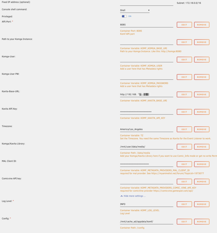

The settings of Kavita and Komf are in the images (containers)
I add the application.yml to this folder /mnt/user/appdata/Komf.

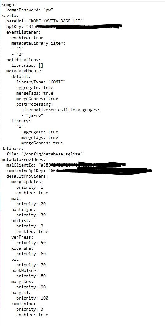

And changed die application.yml, see image.
Finally, I executed the script with the changes you described.
I connected Komf in Kavita and tried to make the settings there. See also the pictures.
Can you please help me.
Kind Regards,
Alukat11

Hey Alukat11,
Here's what i noticed:
In the komf docker run, you didn't set your kavita url (my guess: 192.168.2.5:5000).
Since it is not set, komf tries to talk to the fallback localhost:80, which does not work. The localhost would be komf's own container since it is on the br0 network, and the port would also be wrong.grafik.png.4e87af4a344eae9ad41f4a03ae21af08.png
Everything else looks fine.
Just add the Kavita url to the komf template.
Kind regards,
C3004
You're right, I just had to set the Kavita url with http://192.168.2.5:5000 and it worked immediately.
Thanks for your support.

However, it doesn' run after installation. Here are the logs.
16:12:53.781 [main] ERROR snd.komf.app.Application -- Failed to start the app
java.nio.file.NoSuchFileException: /config/application.yml
        at java.base/sun.nio.fs.UnixException.translateToIOException(Unknown Source)
        at java.base/sun.nio.fs.UnixException.rethrowAsIOException(Unknown Source)
        at java.base/sun.nio.fs.UnixFileSystemProvider.newByteChannel(Unknown Source)
        at java.base/java.nio.file.Files.newByteChannel(Unknown Source)
        at java.base/java.nio.file.Files.readAllBytes(Unknown Source)
        at java.base/java.nio.file.Files.readString(Unknown Source)
        at snd.komf.app.config.ConfigLoader.loadDirectory(ConfigLoader.kt:15)
        at snd.komf.app.AppContext.loadConfig(AppContext.kt:203)
        at snd.komf.app.AppContext.<init>(AppContext.kt:81)
        at snd.komf.app.ApplicationKt.main(Application.kt:13)
Up: i forgot the /yml file. it's working.

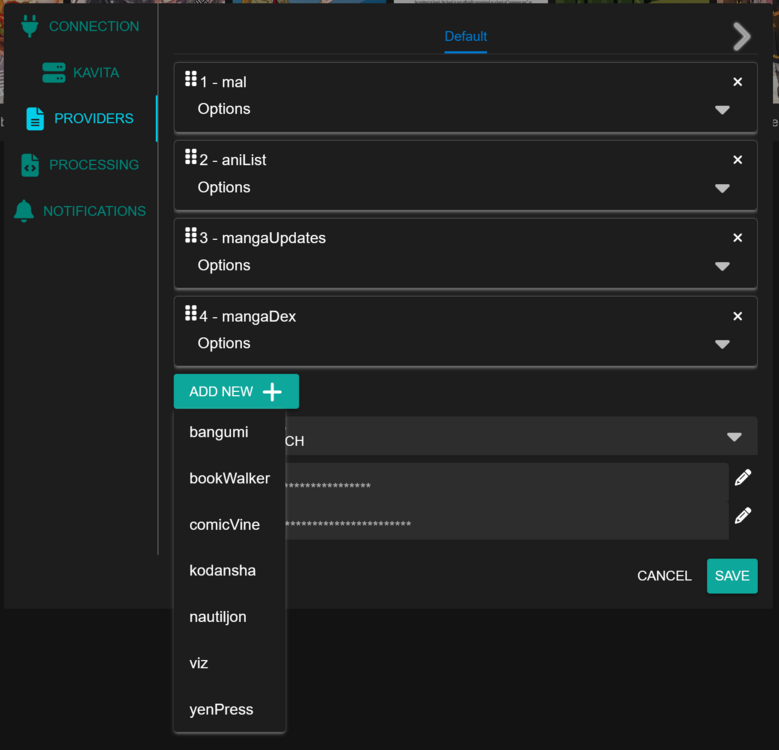

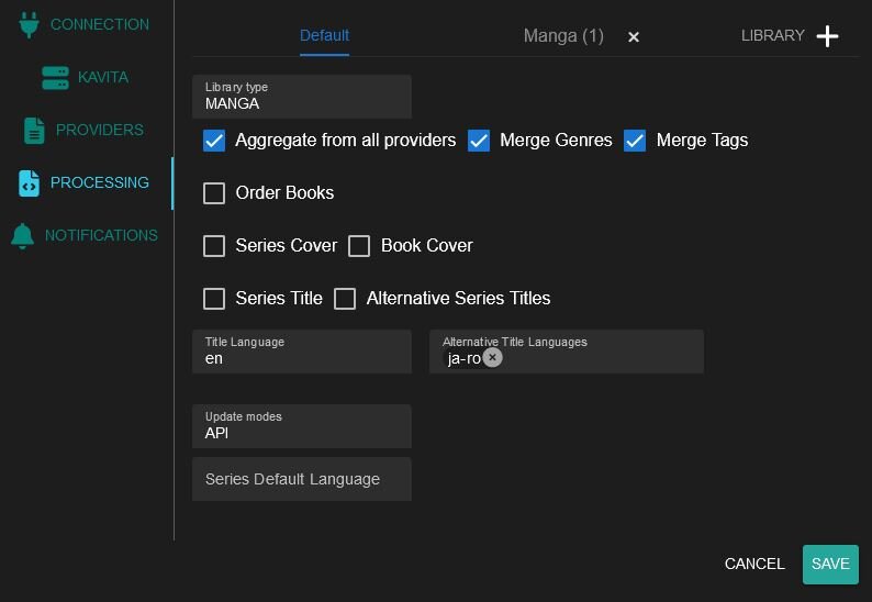

Sorry for the fllod. I eventually did it (entering the config menu with the direct linlk
Update : or almost. It still have a Network Error on the connection windows inside the kavita added menu, despite all the url are correct
Apart of that, i'm not sure about a few things
1/ I'm try to set up the langages, and i cannot find (one of ) mines : french
2/ My books in kavita are mainly novels, and i'm not sure the existing providers of metadata are suitable. How can i add openbook library or Wordcart ?
3/ I've got other folder for manga/comics and magazines. Or does Komf deal with that ?

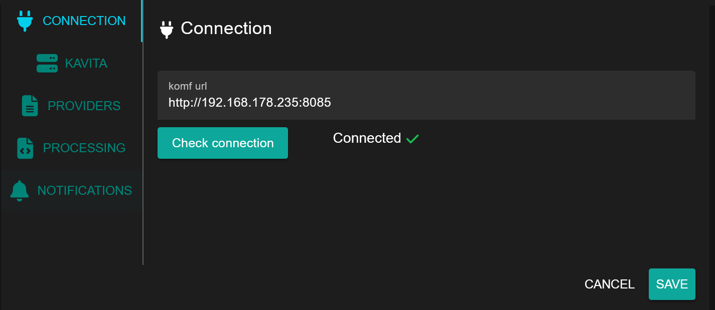

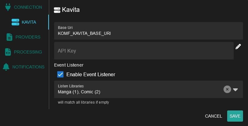

Hi Logan,
It's ok; I too had problems when the Userscript got a big update.

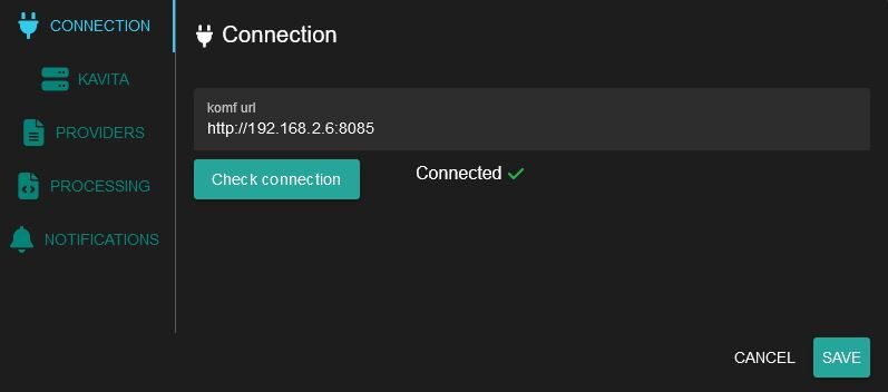

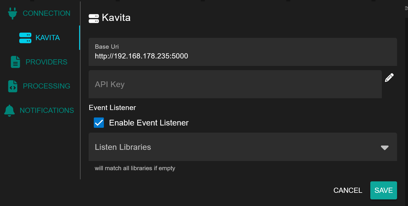

Is the Komf url set inside the userscipt window? The @ include in the userscript only tells the script manager where to activate. grafik.thumb.png.414c1e949e3187c3b921857eae04221b.png
The Kavita URL window should inherit the Url from your yml.grafik.thumb.png.caa6f7c5aef5f711c6886ec3ffbc3320.png
In your second to last post you write that Komf has the url  'http://192.161.1.6:8085' while in the komf logs kavita has the url 'http://192.168.1.6:5000/' If you copy pasted these urls from your setup the Komf url has an error; you should change 192.161 to 192.168 .
Now the questions.

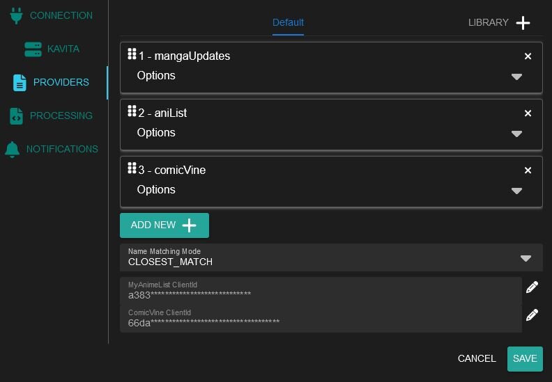

1: The script is in english but if you set your provider to nautilijon (and move it to first postition or removing the others or agregating only their summary metadata) you should get their french metadata.
2:
If you want different providers you have to ask on the komf Github page.
For Novels i set mal as the first source but nautiljon seems to have both manga and novel metadata. To make sure you get the novel, not the manga metadata set in the processing tab the library type to novel.
3:
Komf and Kavita deal with Comics manga and novels pretty well. nautilijon seems to have magazines, but i don't know if the script takes this data for identification.
To make sure the media is identified correctly, save the different types in different folders and add them as their own libraries in kavita. Then set in komf the providers for each libraries directly; for your case nautilijon could work for all of them; but set another provider to identify those that nautilijon doesn't have.
Lind Regards
C3004

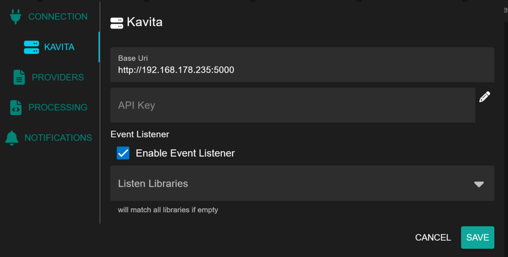

Many thanks for your feeback.
Your right, the logs are showing an error
14:31:19.178 [OkHttp http://192.1681.6:5000/...] INFO http.logging -- <-- HTTP FAILED: java.net.UnknownHostException: 192.1681.6: Name or service not known
But i cannot fint it.
- In the script, there are two URL, and they are correct.
// ==UserScript==
// @name         Komf
// @namespace    https://github.com/Snd-R/komf-userscript
// @version      0.12.2
// @description  Komf userscript
// @author       snd-r
@include      http://192.168.1.6:5000/
// @grant        none
// @run-at       document-body
// @updateURL    https://raw.githubusercontent.com/Snd-R/komf-userscript/main/komf.meta.js
// @downloadURL  https://github.com/Snd-R/komf-userscript/releases/latest/download/komf.user.js
- In Komf docker kavita url is correct
- In the yml, all i've got is   baseUri: "http://192.168.1.6:5000"
What am i missing ?

1:
in the log you just posted the url is missing a point. Change 192.1681.6:5000 to 192.168.1.6:5000. This url should be changed in the komka yml.
2:
add the // back in the userscript before the @include or it won't activate.
Something else i can't see right now.
If it still doesn't work after the two changes above, recheck all urls. If you set the url directly in the komf yml you can ignore the url variable in the komf docker.
Kind regards
C3004

I'm not sure if i'm supposed to post this here, but just wanted to mention if anyone else was struggeling with getting COMIC_INFO to work because it gives a write permission error:
This seems to be because the container path is set to /books while i think the container path should be /library.
Please correct me if i'm wrong XD
Thx. :)
6 hours ago, Thundrglaive said:
Hello,
Thx. :)
Hi Thundrglaive,
Your right. The /library is the usual mount for Kavita, while /books is the mount for Komga.
I've updated the Template accordingly.
Kind Regards
C3004

Hello. Maybe you can help me.
I am trying now for a week to only start Komf. I setep up evrything in the options. Deleted the options for the other portal (Kiva or what it is called), because i am just jusing Komga. Then i saw i need to add the application.yml. I also di that and added it manually (i got the application.yml from the komf github page and editedt to what i need and like). And Komf just doesnt want to sart. There are no logs nothing. After a second it just stops the container and out. I am loosing my mind because i don't know why.
I will add my yml (i will just for the upload here replace evrything with the env Tag. In my yml on my server there are the actuall values written)
application.yml
Hi Kay,
The docker won't start if anything is wrong in the yml. I think it crashes because you didn't fill out the metadata providers. Remove them from the yaml and set them up using the userscript once komf starts. I added a cleaned yml to this comment.
application.yml
 If it still won't work please post the docker run.
Kind Regards,
C3004
Edited by C3004
update yml
Hey C,
thx for the fast response. I played now around with the cleand yml. And i can't bring it to run the docker still. I uploaded you version with the env varibles. Then i tried adding the same varible i added when building the container. Here is the docker run (Again removed pw and credentails seen with just a X):
Removing container: Komf
Successfully removed container 'Komf'
Command executiondocker run
  -d
  --name='Komf'
  --net='bridge'
  --pids-limit 2048
  -e TZ="America/Los_Angeles"
  -e HOST_OS="Unraid"
  -e HOST_HOSTNAME="MasterOfServer"
  -e HOST_CONTAINERNAME="Komf"
  -e 'KOMF_KOMGA_BASE_URI'='http://192.168.XXX.XX:25600'
  -e 'KOMF_KOMGA_USER'='XXX'
  -e 'KOMF_KOMGA_PASSWORD'='XXX'
  -e 'TZ'='UTC'
  -e 'KOMF_METADATA_PROVIDERS_MAL_CLIENT_ID'='XXXX'
  -e 'KOMF_LOG_LEVEL'='INFO'
  -l net.unraid.docker.icon='https://avatars.githubusercontent.com/u/76580768?v=4'
  -p '8085:8085/tcp'
  -v '/mnt/user/Media/books':'/books':'rw'
  -v '/mnt/disk3/appdata/Komf':'/config':'rw' 'sndxr/komf:latest'
714ef50b8e8f82f18a78d774243fec1d7405f71cb000543234e5a1a083946833
The command finished successfully!
Edited by MasterOfKay
1 hour ago, MasterOfKay said:
Hey C,
  -d
  --name='Komf'
  --net='bridge'
  --pids-limit 2048
  -e HOST_OS="Unraid"
  -e 'TZ'='UTC'
  -p '8085:8085/tcp'

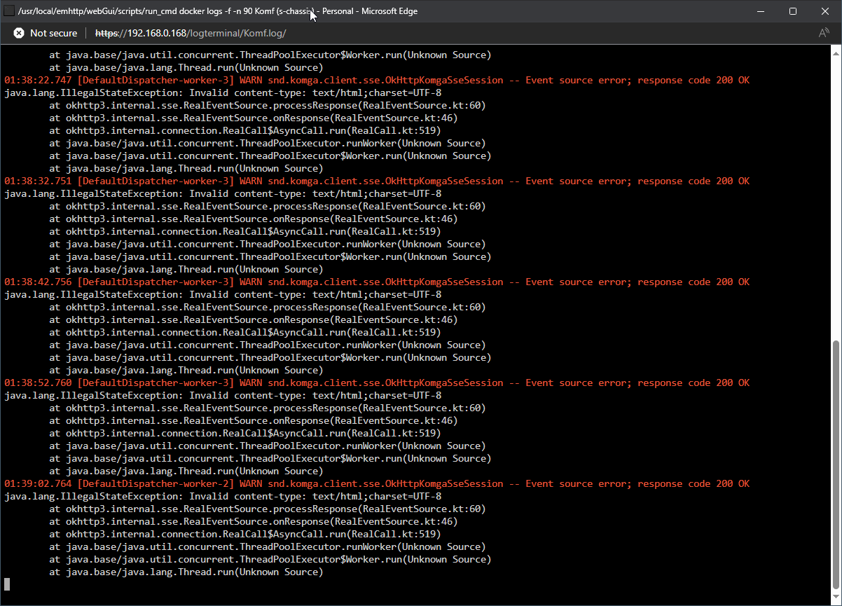

Ok, did a quick test.
The yml i posted has a small error. the env:KOMF_SERVER_PORT won't work because i didn't put the environment variable in the template. Replace it with the port 8085. It should then start.
you should be able to see logs then.
Edited by C3004
Hey C,
i tried that and the docker Container is still not starting. Even setting all env variables to the value i have set to my docer container still won’t let me start komf. It just stops after one second.
21 hours ago, MasterOfKay said:
Hey C,
Can you recheck for logs?
If the webui button does not work try following in console (Change container Name if you changed it in the Template):
docker logs Komf
docker logs Komf
I haven’t change the Name in the template and the container ( I tried that now but still just shuts down). And the logs are just empty. Just a black empty consol log where I can’t write.
