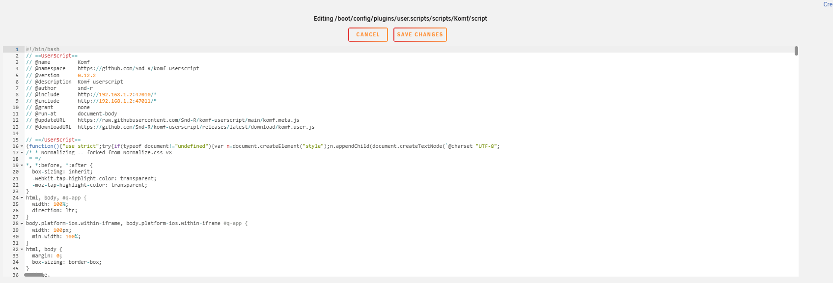

Ok so I have updated the userscript, how do I get Komf to utilize it?
I ran the script with User Scripts in Unraid. Rebooted the containers for Komf, Kavita and Komga but no change.

Hello RedFox,
The Userscript will connect over your Browser with the API offered by the Komf container.
Over the APi the script allows you to change the settings in komf and start metadata scans for your library.
It won't work over the unraid Userscript Plugin as that one is meant for Bash or Shell scripts.
You need to use a Browser script manager for the komf script. I use Tampermonkey.
The script is being excecuted if you see the one next to the tampermonkey symbol in the browser bargrafik.png.
If you can't see the one, you need to recheck the url's you wrote into the Userscript for your media Servers.
Once Logged into komga, you should see the added options from the userscript.
Click on it and make your needed Settings.
The first one would be to add the komga url, so the script can talk with the API.
Then you can make the Media Server specific settings.
In Kavita the Settings Symbol will be in the Top Right.
Note that the Provider section in Komf will let you see the processing for both servers, so don't delete them by accident because they don't have the proper library title.

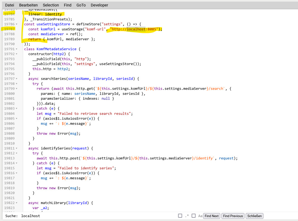

On 2/19/2024 at 8:37 AM, C3004 said:
Hi Ollebro,
I ran into maybe the same Issue.
The Userscript is configured to try to connect to Komf on localhost and 'forgets' your settings when you restart the script.
So i recommend changing the adress in the Script itself (note that after updating your Script you will have to set this again)

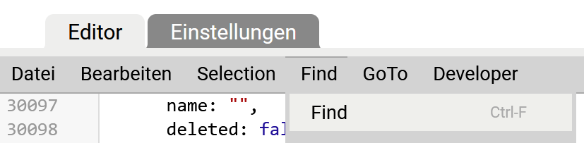

In Tampermonkey use Find and search for localhost.
use find next next to the search bar until you see this:
In Line 19787 replace http://localhost... with your Komf server adress. (192.168.1.4:8085) You can skip the http:// it worked without in my case.
That should keep the Script from forgetting your komf adress (until the next script update)
Also make sure you've set your komga and kavita adresses to let the script be active there.
Good Luck, Have Fun
